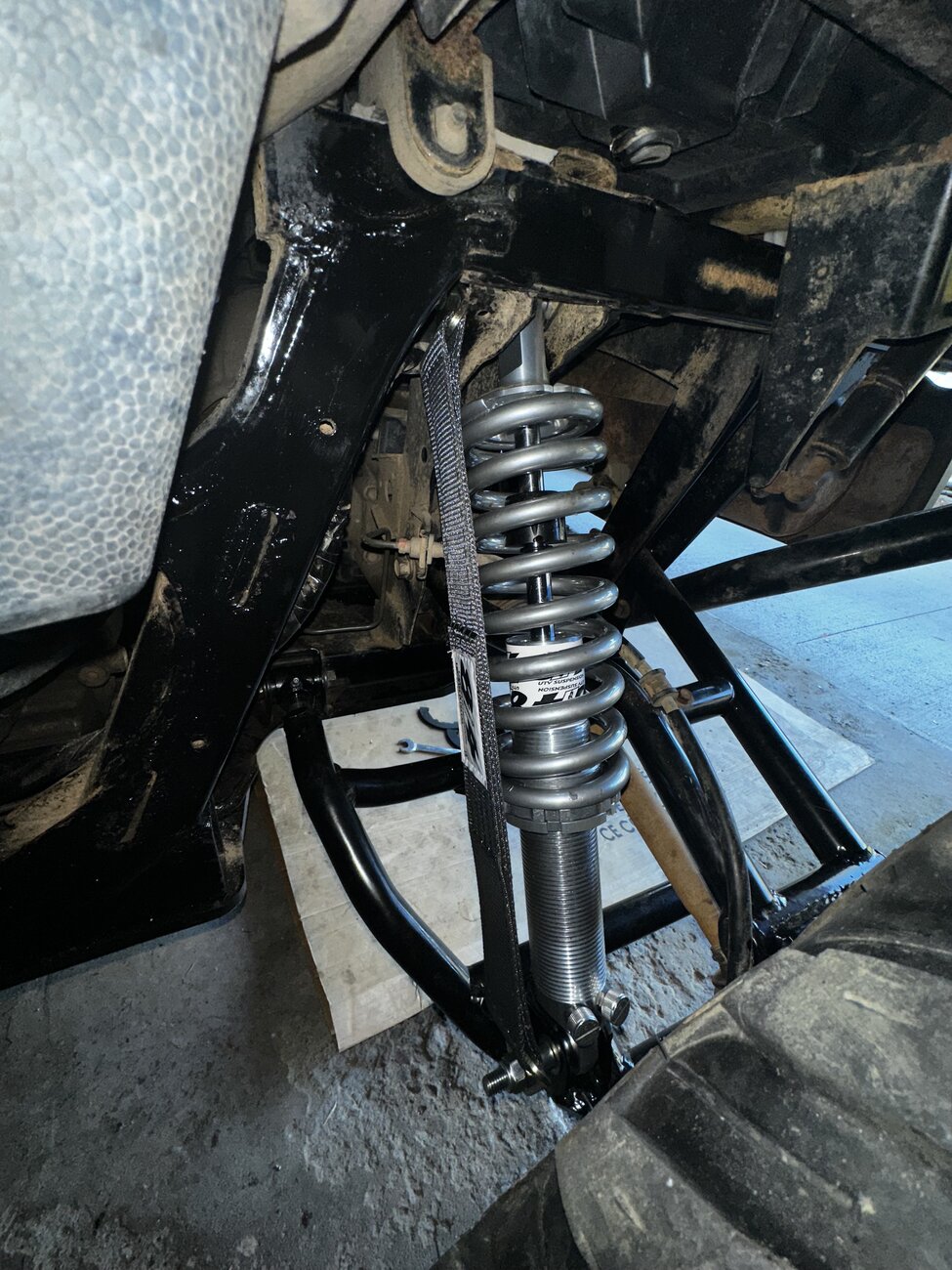

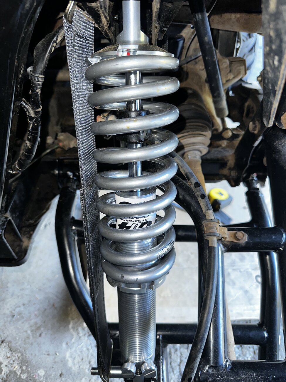

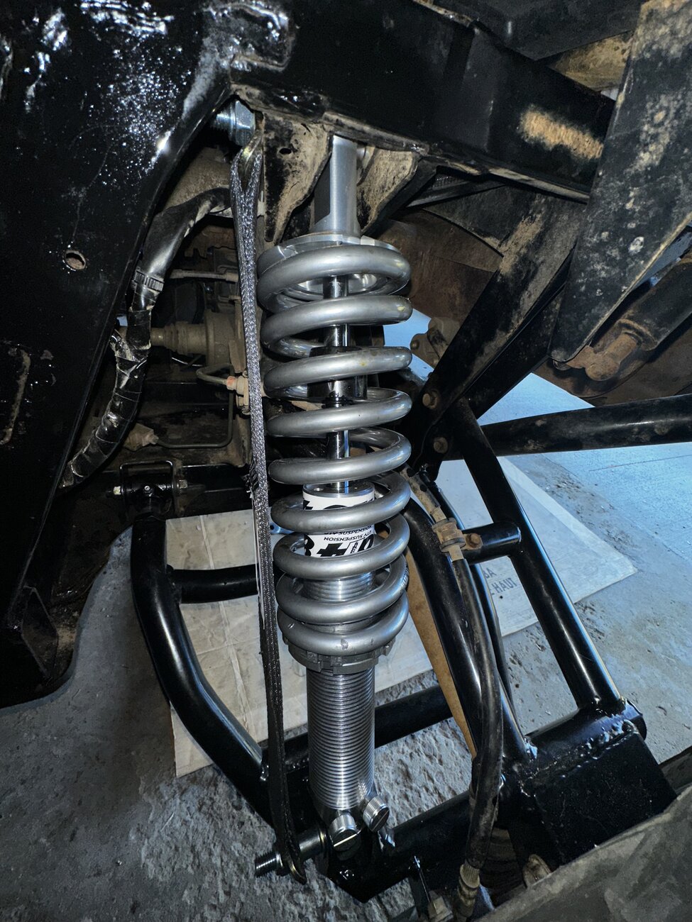

Okay I going to to send a couple pictures and let me know what you think. Easily have the springs around 5” from top of rebound knob to bottom of the spammer nut. From there I’m at 19” eye to eye

Here are some pictures of where it’s sitting with tires on the ground. 19” eye to eye.

@Jaked2694, I went out to get some measurements on mine (P1k5) this morning. I set up my 814 3ways a couple of years ago and have since added a spare tire rack to the rear and along with the normal stuff I carry around in the bed it’s probably 200 pounds total. My rear shocks measure 18” eye to eye with the 814 supplied 350# 12” long springs. Distance from top of adjustment knobs to bottom of spring is 4”. The front is 18-1/4” eye to eye with 300# 14” Eibach springs. Distance from top of adjustment knobs to bottom of springs is 3”. If you are running the limit straps supplied by 814, they are only 19” eye to eye, so if you have your springs cranked up to 19” eye to eye there will be no down travel for your shocks. If you are not running the limit straps, you’re running the risk of over stressing your CV joints. If I remember from a previous post, the original stock deluxe shocks are fully extended at 20”. The 814’s will stretch out to 21 or 22 inches without the limit straps. I’m adding a photo from the rear of the right rear shock. The original spring length of 12” is now compressed to 9-1/8”

Your photos just showed up. If you run them like that, you’ll hate the ride as there will be no rebound or droop in your suspension. You could have saved a lot of money by just installing some steel bar stock in place of the shocks.
