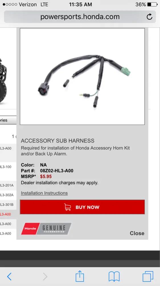

Where exactly do you connect this harness?? I'm going to use it for my key on for my winch power instead of splicing but I can for the life of me find where t plug the thing in??

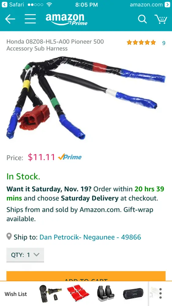

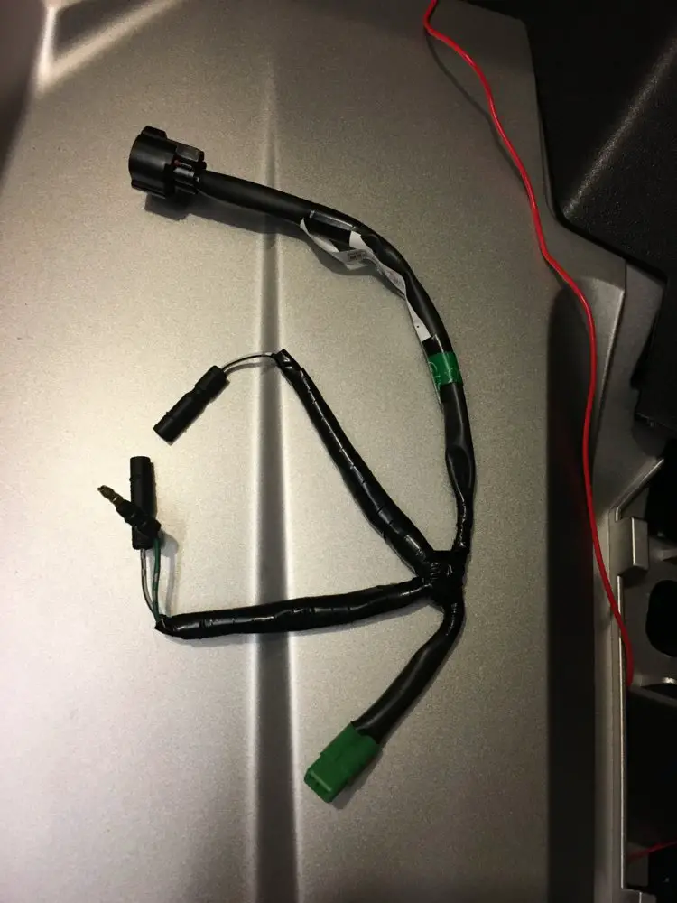

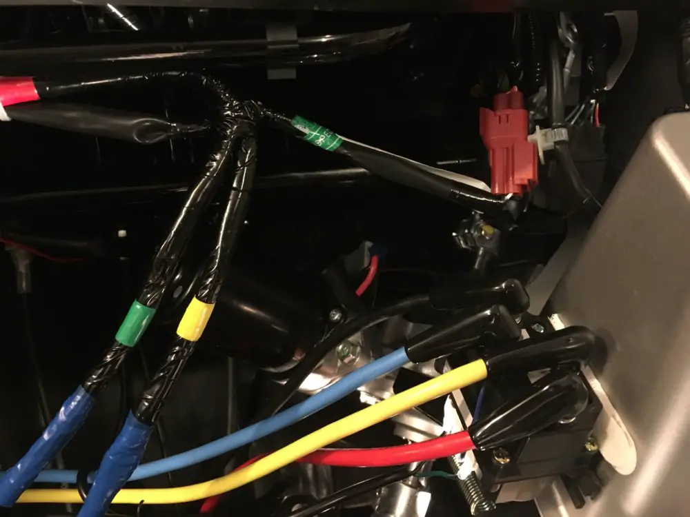

Said heck with it and got this harness, plugs right in and has 4 sits for accessories! Pop the cap off the red harness coming off the pioneer and its plug n play.

what is that looks like distribution panel that has the black, blue, yellow, red wires coming from it? Looks like a large relay maybe for winch or is it something else?

08Z08-HL5-A00
$10 from the dealer in stock. Says it's for the 500 but plugged right into my 2017 700-4
Used the same harness to power the winch switch on my 17 p-4 deluxe. 12 volt switched, no issues, plug and go. I also ordered the harness the machine calls for just to see if it's any better. 2 cents.
