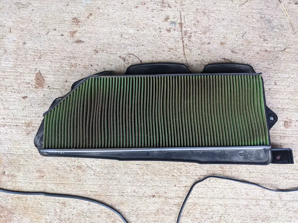

Didn't see one of these so I figured I'd try and document it as I swapped mine out. About a 20 minute job.
Swapping out my air filter after a little over 2k miles. It still didn't look that bad and I'd have no issue running it for another 500-1k miles... but I had a new one and I was bored.

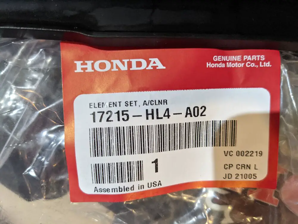

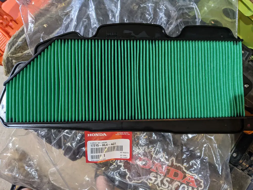

New air filter element (comes with 2 new gaskets as well):

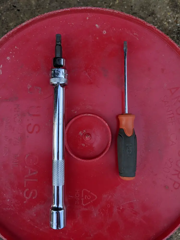

Tools:
5mm Allen head socket
1/4 or 3/8 socket wrench
Medium (4"-5") extension
Small flat head screwdriver (a pick or pocket knife works too)

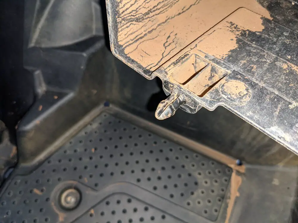

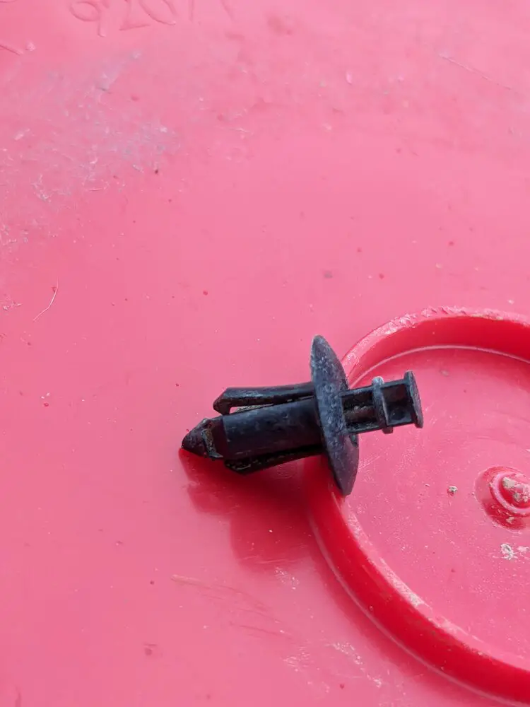

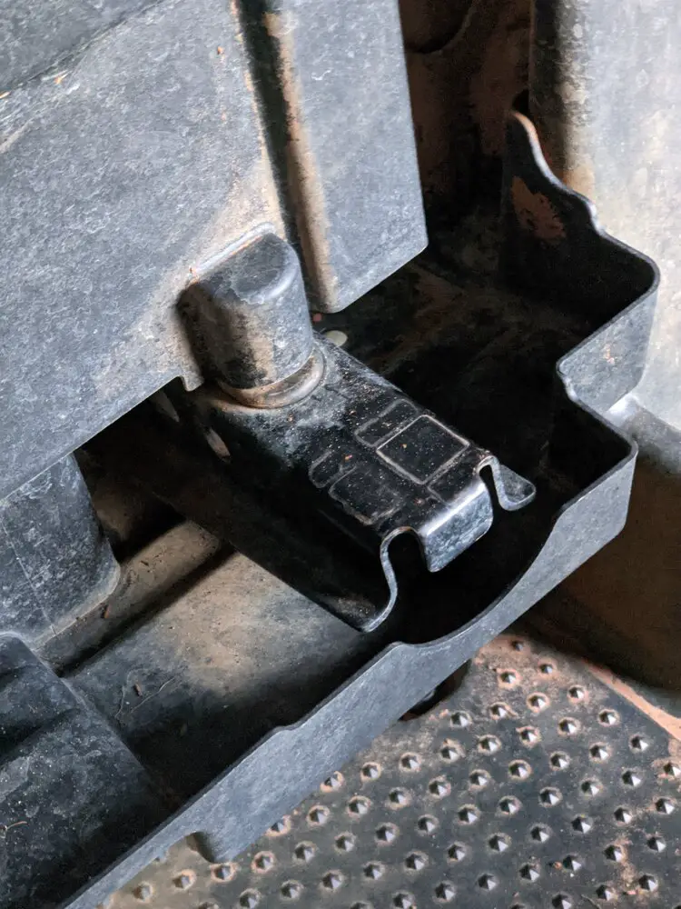

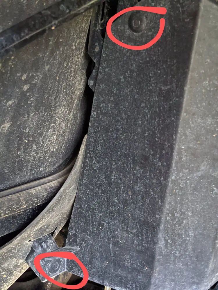

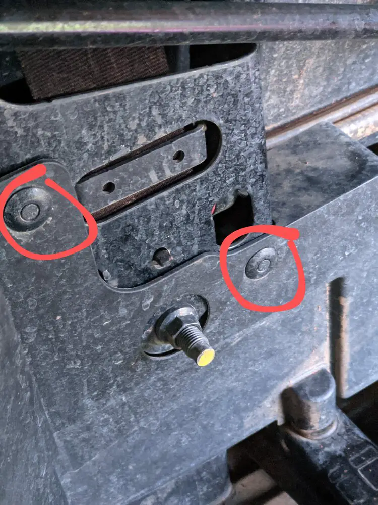

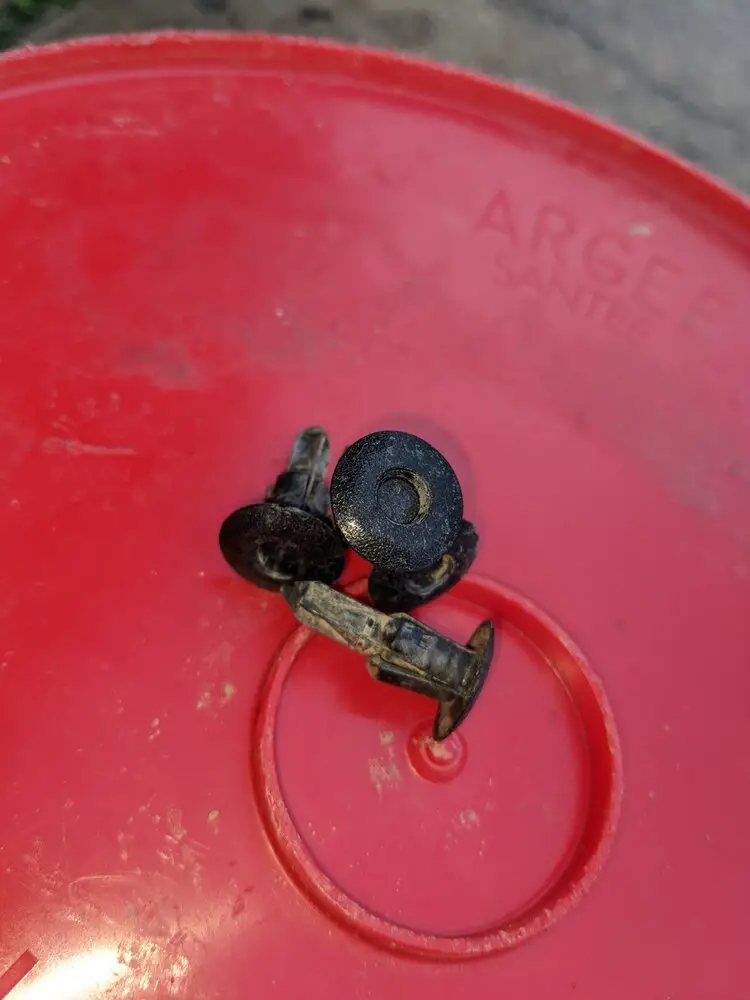

Remove the four push clips that hold the airbox shroud on. There are two on the driver side and two on the passenger side. You should be able to lightly press in on the center of the clip with the small screwdriver to release them. If they are hard to depress it means they are full of mud/funk and I've found hitting them with a little WD-40 will loosen it up. These are easy to break, so take your time. Push the detent in and then use your screwdriver to get under the lip and wiggle them out.

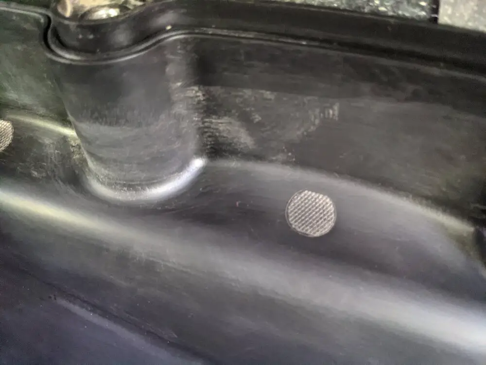

Once those are out you'll see that there's a small peg that goes into a rubber grommet on the passenger side that holds it in place. Just pull up and the shroud will come free. Mine is filthy because this is always covered up by plastic; don't you judge me!

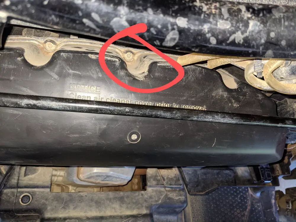

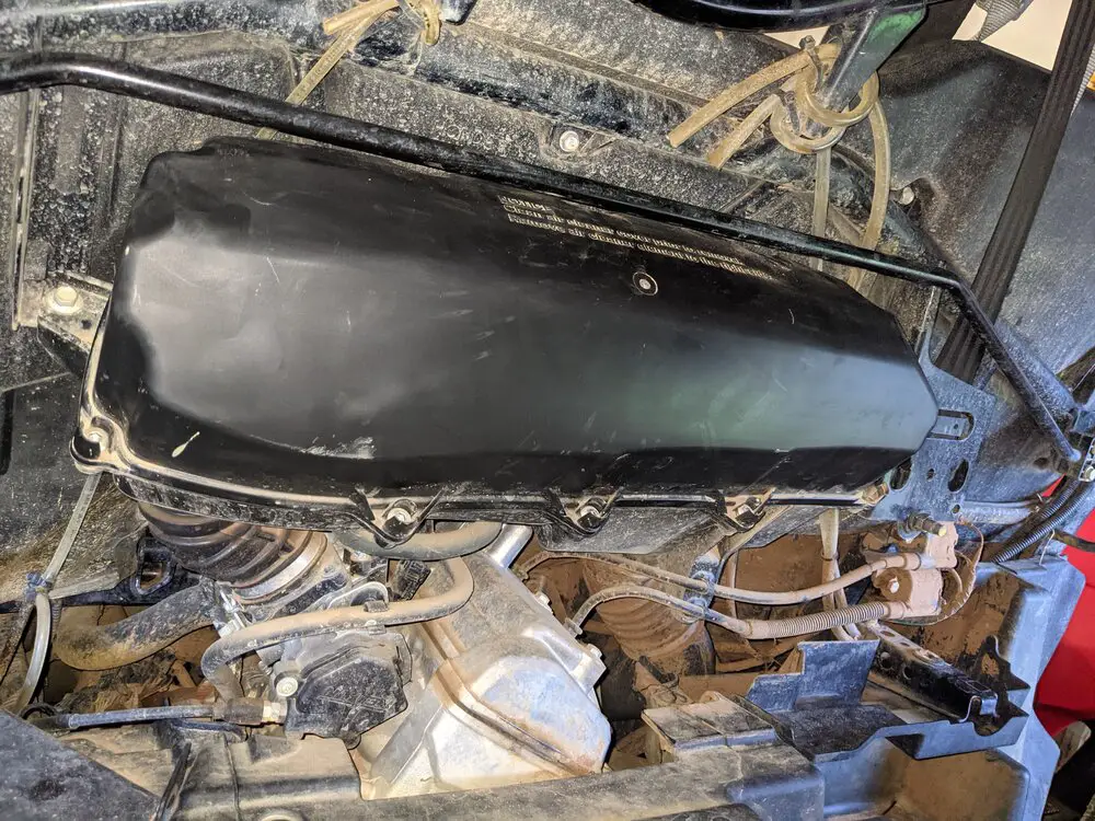

Clean the outside and remove the airbox cover. There are 10 5mm Allen head bolts holding the airbox cover on. These are made of cheese, so treat them as such. Don't use an impact and use a brand new 5mm allen head socket if you've got one. Make sure you clean out the hex heads as they'll more than likely be full of crud. Make certain you've got the Allen fully seated in the bolt before you try to loosen it. All these bolts are captured so don't worry about losing them as you loosen.
PXL 20210519 001659174

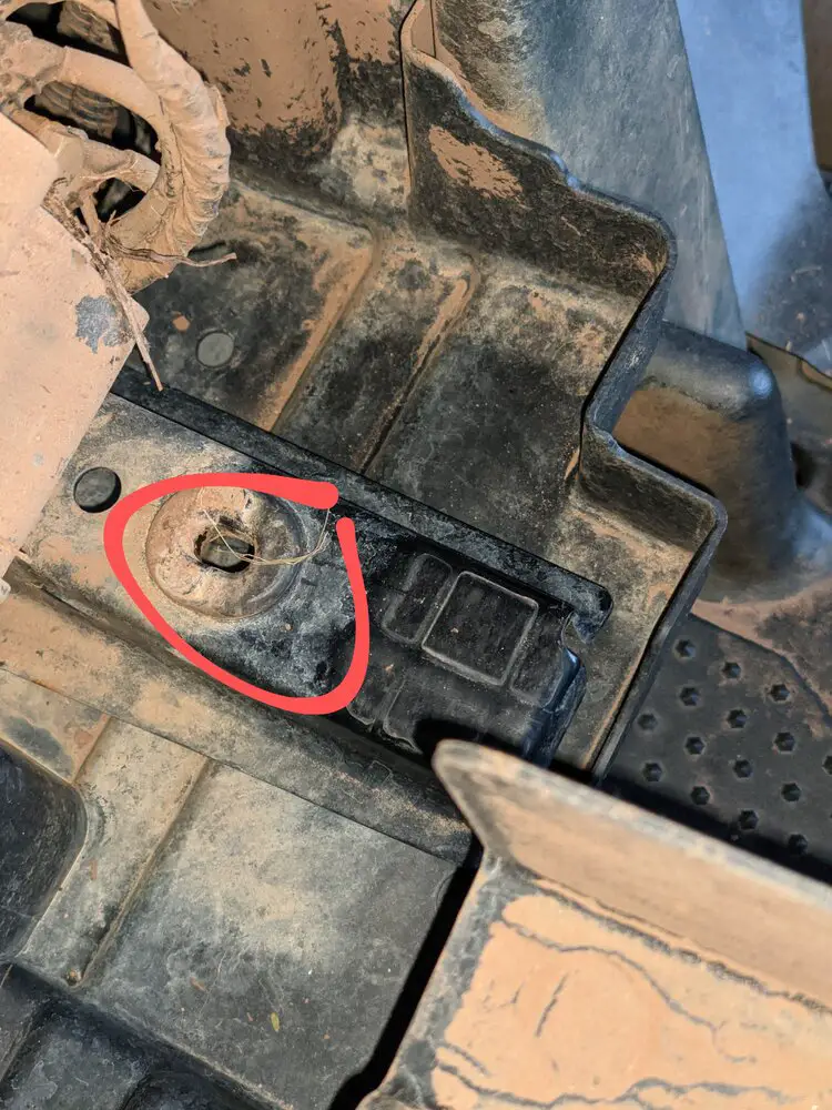

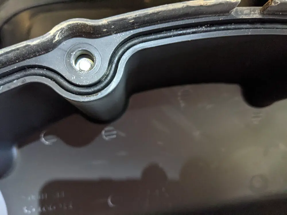

This is the bolt most people strip. The crossbar for the headrest/seat back drops down above it and if your extension is too long, it won't let you fully seat the wrench. It also seems to hold the most crud. Shine a light in there and make sure it's cleaned out before you start twisting.
PXL 20210519 0016506952
Work your way along and fully loosen all 10 bolts. Slowly remove the airbox lid once they are all loose.

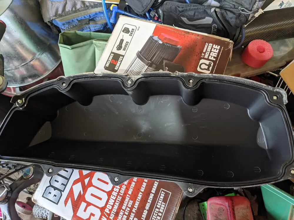

Remove airbox lid, old filter element, and both gaskets. There's a 5mm allen bolt holding the filter element into the housing that you'll need to loosen to remove it (it's captured also, so don't worry about it falling out). A lot of people don't think the gasket is even there, but it will be pressed tight in the groove and be flattened. Use your screwdriver to work it loose while being careful not to damage the channel it sits in. There is one on the airbox lid and one on the filter side of the airbox.

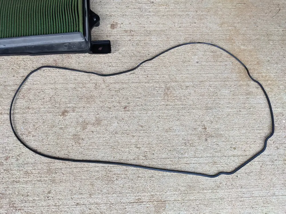

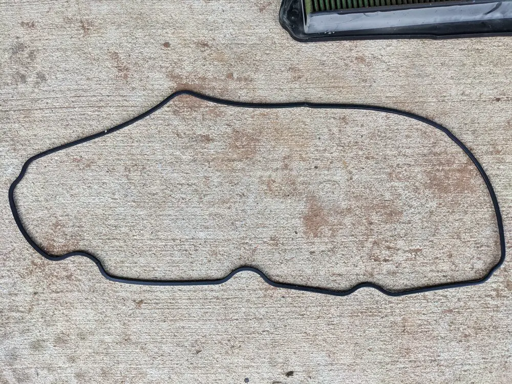

There's a longer gasket included with the new element that goes on the airbox lid. Don't firmly press it into the groove as you work it around or you'll end up with extra slack in the gasket and have to start over. Just lightly press it in and work your way around. Set it aside once you've got the new gasket in. I put a few shop rags in the intakes just to prevent anything from falling in while the cover is off.

Wipe out the filter side of the airbox with a damp shop rag and then make sure to wipe it all dry. Install the smaller gasket included with your new filter in the same fashion as the one you installed on the airbox lid side. I found it easiest to kneel on the middle seat and lean over the bar for most of this.

when I was changing my air filter, the bottom gasket seem like it was too big to fit in the channel, I had extra hanging out.
has anybody else had this problem?

I remember the last time I replaced the filter, those gaskets seemed waaay too big to go into the slots. That was based on me trying to match them up first, before I pulled the old ones. I remember wondering if it had shipped with the wrong ones?
I wound up just leaving the old ones in there. Next time, I'll try to figure it out again.
Same thing happened to me.

I think it's in there Plumber32, it's just pressed in so deep that it doesn't look like it has a gasket. I was scrutinizing mine last time, and it seems like I could only tell it was there was if I poked at it with a screwdriver..

Outer Shroud
Removing the outer shroud, with a push pin tool, went smooth until I got to a unique push pin with no head.??? I recommend everyone own extra push pins. I used Needle nose pliers to get it out.

Reading everyone's problems with gaskets that seem too big, I found the same thing. On a whim, I tossed mine in the freezer to see if they would shrink. Nope. What I did do that worked perfect, was as I put the gasket in, I pushed it opposite the direction I was going. I did this all the way around, both gaskets, and there was no excess.
