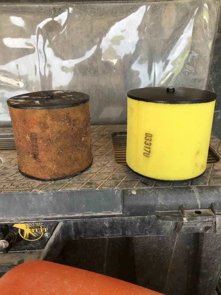

Finally got around to picking up a new air filter element after our food plot excursion. This thing was trashed, keep in mind in this pic there are only 244 miles on the machine. I’m going to look into different air filters, the oem one is a pain, gloves are recommended lol.
View attachment 84199 Finally got around to picking up a new air filter element after our food plot excursion. This thing was trashed, keep in mind in this pic there are only 244 miles on the machine. I’m going to look into different air filters, the oem one is a pain, gloves are recommended lol.
Looks like it worked though!!

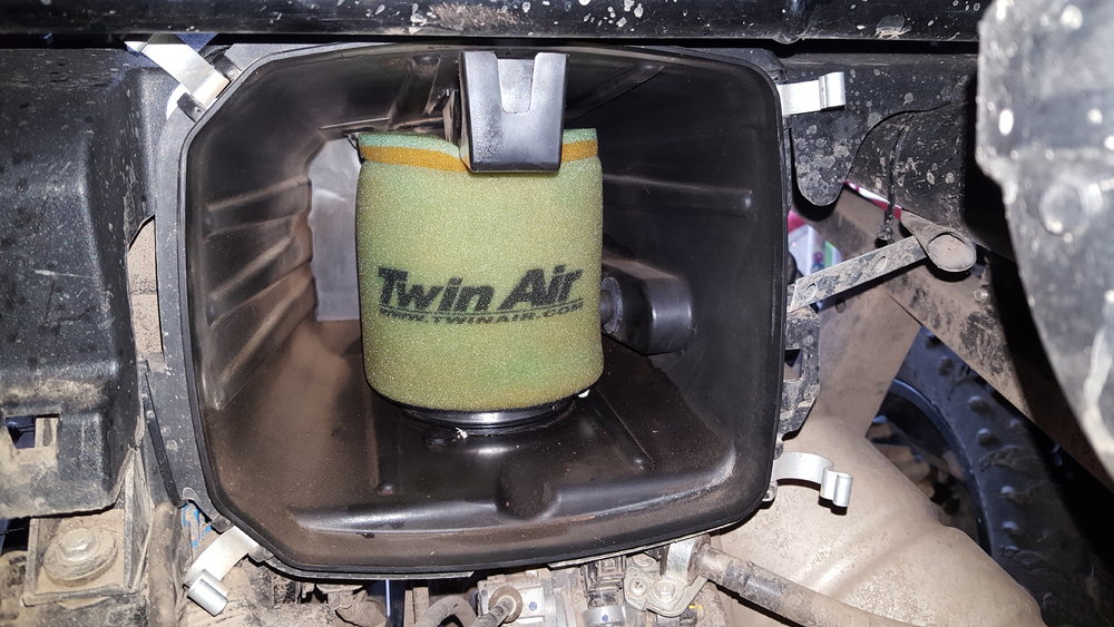

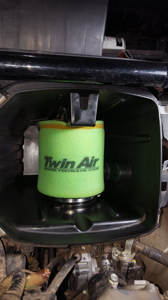

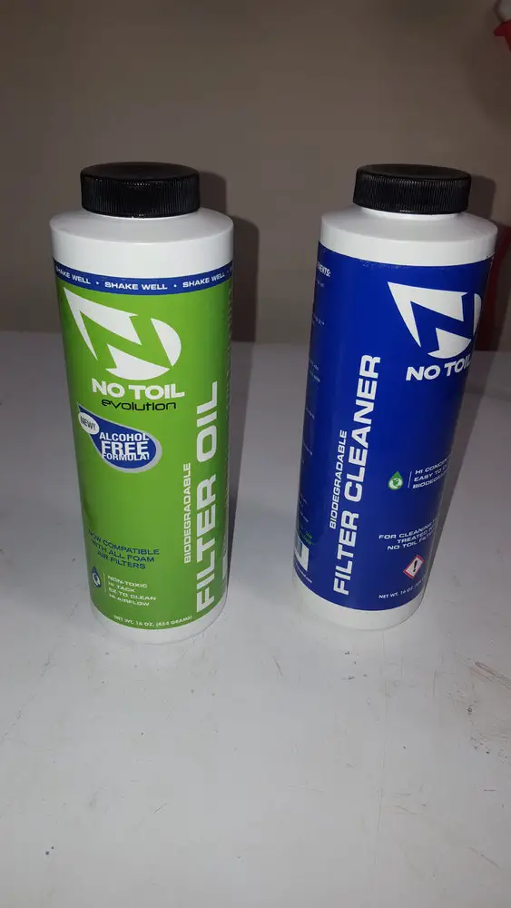

Swapper out the stock filter for a Twin Air filter and using Notoil oil. Cleans up with a bit of powdered cleaner mixed in water to clean the element and then reoil. Biodegradable too. My buddy has a kid that races mx so they have tried it all and this was his recommendation that has so far been great. Also snorkeled with a legging/nylon prefilter. Second pic is after about 400 very dusty miles.
View attachment 84495 View attachment 84496 View attachment 84497
I’ll have to check those out, I think I saw that brand on amazon. Sounds like they are pretty good.
Reactions: Shadesmn
I figured they are way harder on filters racing than I ever could be, so if it works for them it should more than suffice for the pioneer.
