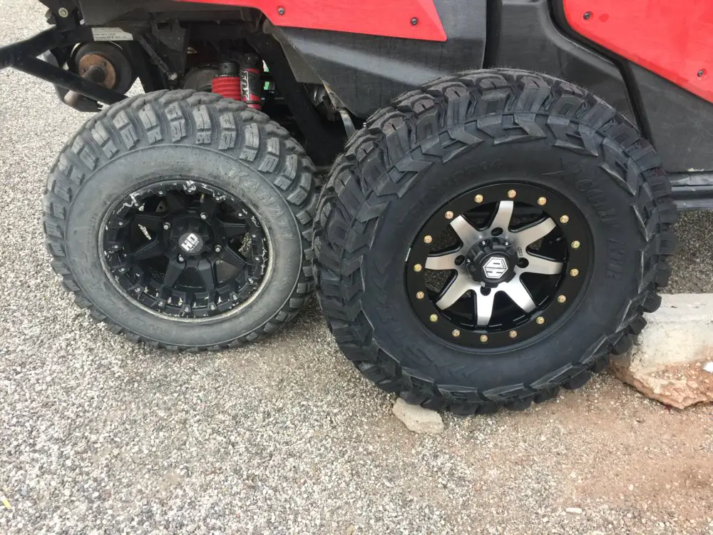

Here one mounted up next to a 28x10x14 Green Ball Crap tire
This is a good looking Tire!
IMG 5895
STI X-Comp 10X30X14

I emailed STI enquiring about the side wall and tread ply construction of the X Comp and X2...the reply "The entire X Comp or X2 tire is 10 ply rated". That's one tough tire.

Boy howdy! I have set of ITP Black Waters, I bet there the same way. They can have 0 psi and they still stand up????

i actually emailed ITP also about the Blackwater and it is "8ply construction" side walls included as is STI's XD.

I thought so, thanks for the info!

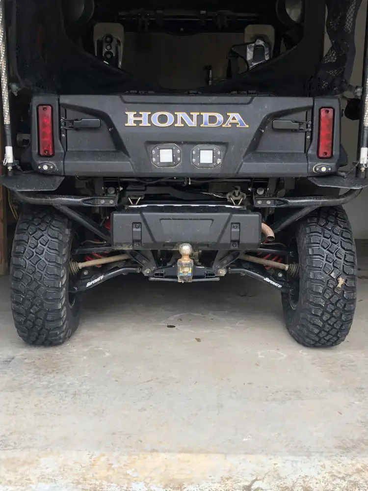

Can you show a pic of the height of this tire on the machine...hoping it measure close to 29 so they will work on a stock height. machine
They are 29" mounted with 12 lbs. I only have forward/rearward off set arms

Saying "stock height" what are you implying? Is the machine fully stock?
I dont believe 29 will work on an all stock machine. I think the consensus is that 28" is the max.

Thanks bfg km3 30x10r14 measures 29" mounted wish you had stock A arms :)
I realize everyone says that 28 is the max but are they really measuring the tire as plenty of tires run small so a 28x10xr14 may if fact be shorter than 28

You are welcome. No way would fit without off-set arms
I believe those are measurements, these guys are detail oriented here, no guessing, ;)

28 is the measurement. Mine measure exactly 28" tall sitting on the machine. When turning and compressing suspension. They may rub just barely.
I'm not saying a "29" tire wont fit but if it measures over 28" you're going to have issues on a stock machine.

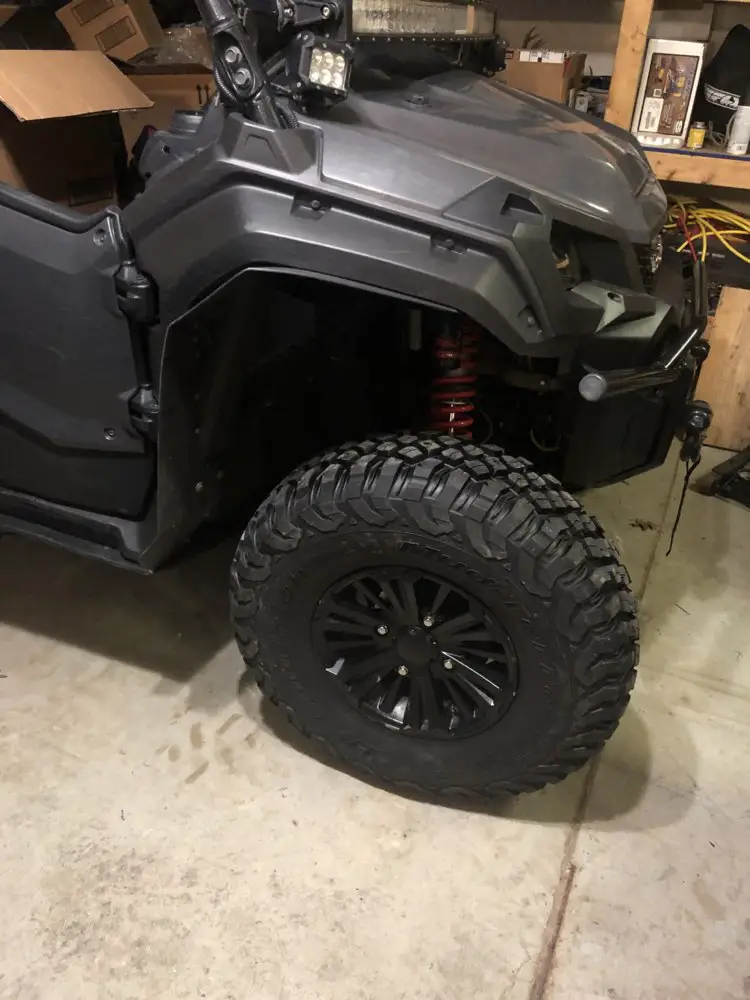

How do you like the bfg? Can you feel the weight like the roctanes?
Haven't gotten to ride. I had them on before Christmas, but with the holidays, work, and now we are having a huge remodel done, I'm busy every minute I'm not at work. Really might not get any time out until March. I'll post up a review once I get a real ride in. They are for sure much more smooth on the road. I just took them up the pavement in our development, just to see. This was before I put the 1" spacers on the back, too.
