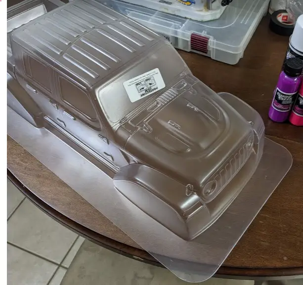

This will be pretty picture heavy...
Cut and trim the body and mount it to your R/C before liquid masking/taping it off and painting. You can do it afterwards, but you will almost always scratch up the paint or put the holes in the wrong spot.

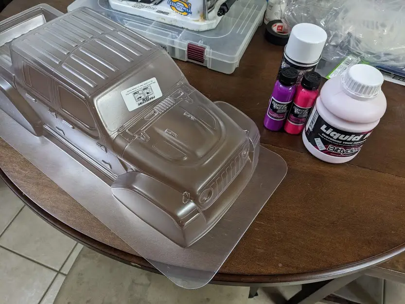

This is how most bodies come (this is a Pro-Line Jeep Gladiator Rubicon for a 12.3" wheelbase crawler):
1610131215969

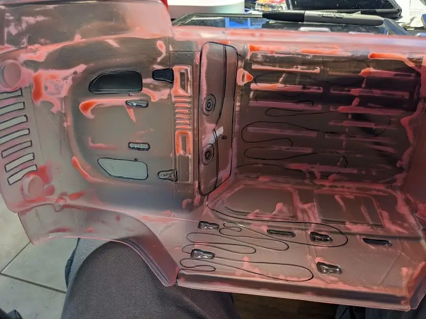

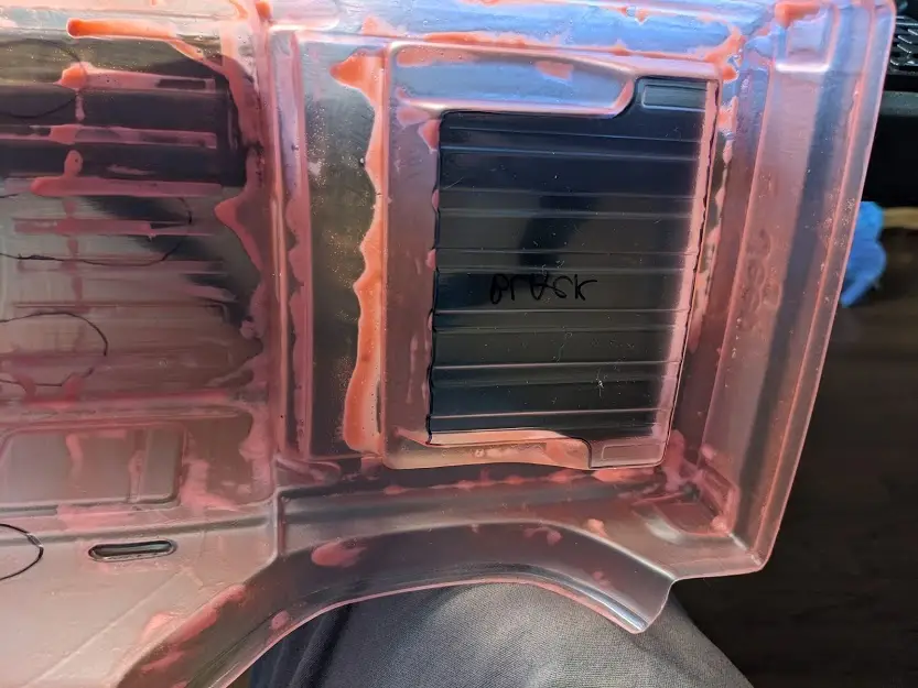

I use an X-Acto and trace along the cut lines with solid force to score the lexan. If you do it right, you can just snap and pull off the excess. You can also buy curved lexan body scissors, but after doing this 100's of times I have found using the X-Acto (or a razor knife) to be the easiest way. Some people use a dremel to cut them out as well.

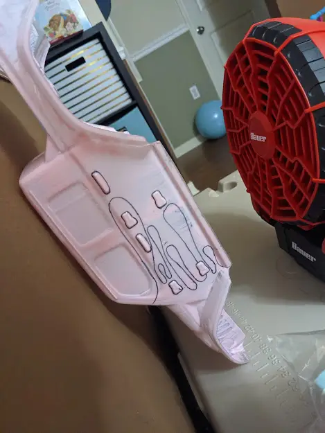

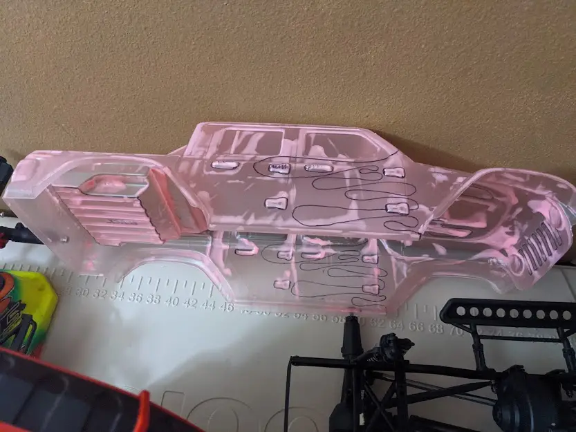

Draw your design on the outside of the body using a Sharpie:
1610131478946
1610131492238

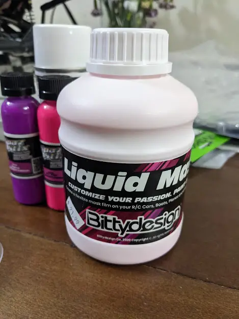

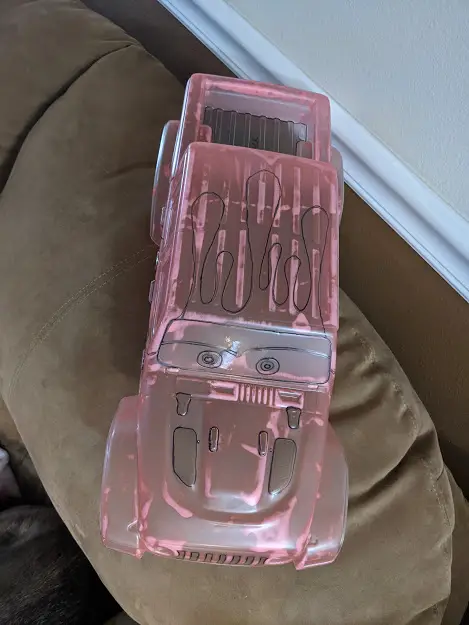

Then apply your liquid mask (or tape). I didn't take pictures of the design drawn on before applying the mask, so that's why it's pink. You want two good coats of mask. Ideally you don't get the big globs like you can see in mine where it looks like glue that hasn't dried, but it's hard to get it even with a foam brush. I put on one relatively even coat and then put it in front of the fan until it turns translucent and dries. Then add a second coat and do the same. I like to let it sit overnight in front of the fan just so it has time to cure, but you can speed it up with a hair dryer.
1610131752817
1610131770910
1610131784106

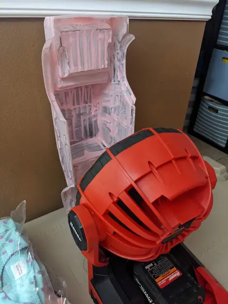

You can see it drying here:
1610131804378

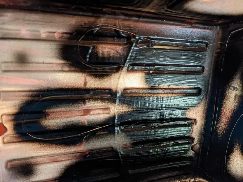

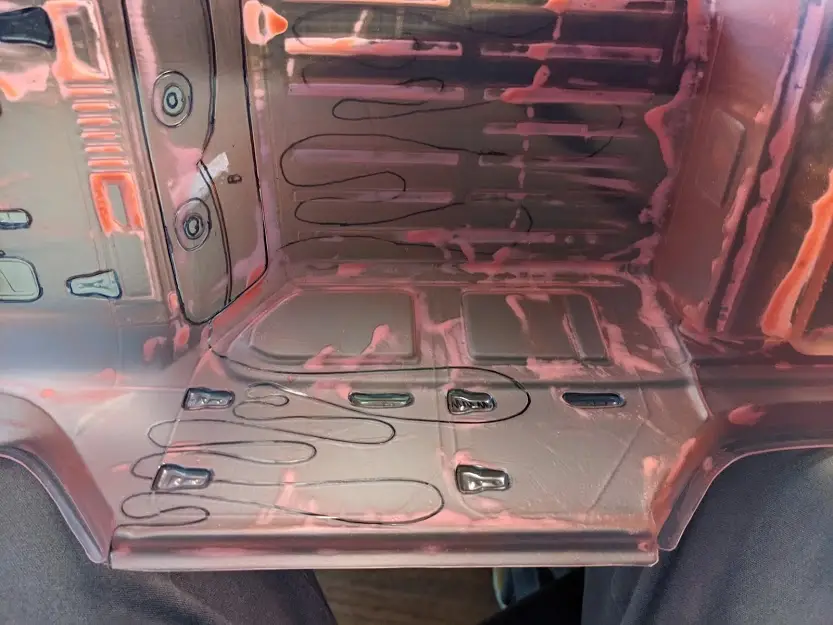

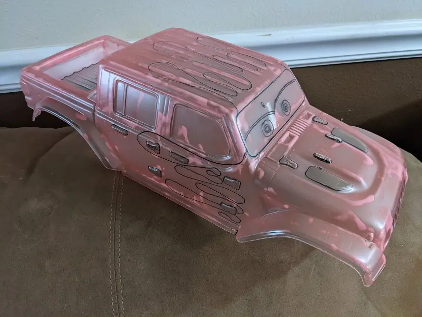

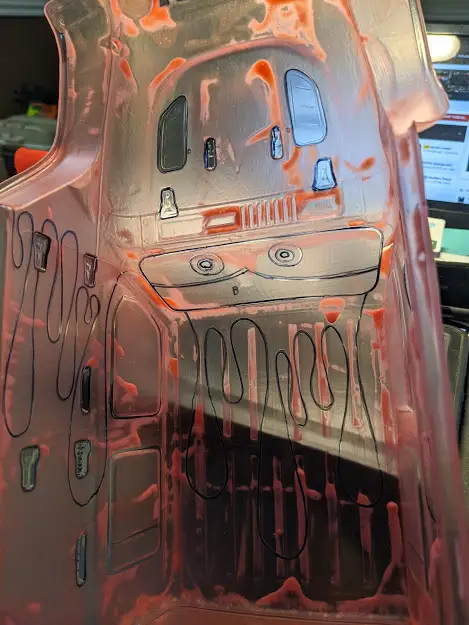

Once it is dry, you're on to the REALLY fun part... cutting out your design. You want to use very light pressure with a brand new #11 X-Acto blade. You don't want to score the body as it will inevitably start to crack along those cut lines if you push too hard. If you look closely you can see how I've got a very thin pin stripe cut out along the drips. Anything that will be painted black gets cut and peeled out.
1610131968227
1610131979255
1610131995373
1610132012738
You can see all of my cuts in this one if you look closely. The drips are all going to have a thin black pinstripe and the window outlines will as well.

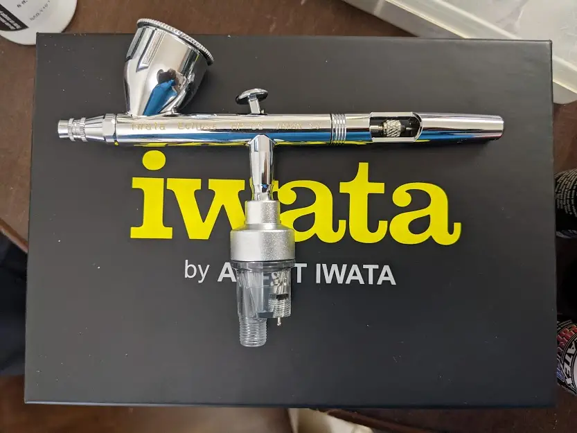

Alright back in action. Picked up a new airbrush while I was at Hobby Lobby as well since I had a $25 gift card. I've always used Iwata Eclipse HP-CS dual action brushes. My old one needed a complete rebuild after a few hundred bodies, so now I've got one for water based paint and one for lacquer. You don't need one this fancy, but if you're doing intricate fades or freehand stuff they are the absolute best. Added bonus is that Hobby Lobby carries almost all of the stuff to rebuild them (o-rings/needles/tips/etc), so if something happens you're not stuck waiting on the mail.

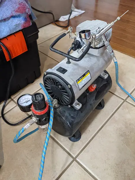

Here's the compressor setup. Super quiet and you can get them for about $60 at Harbor Freight. This one has an extra tank so the compressor doesn't have to run as often, but it isn't necessary. I've had this one for about 10 years.

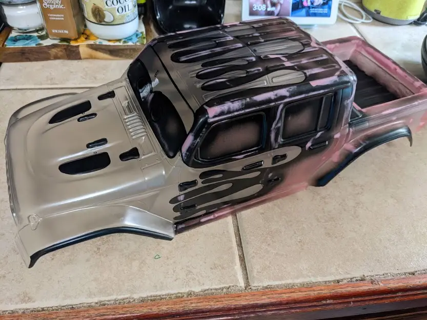

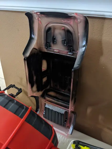

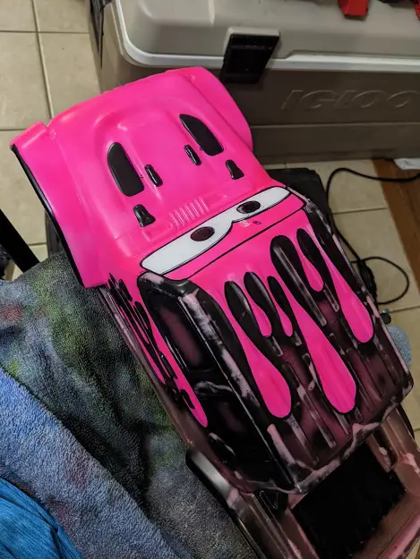

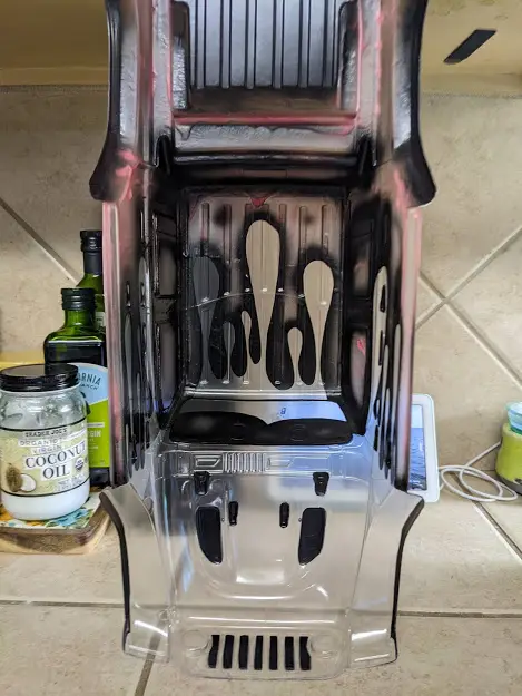

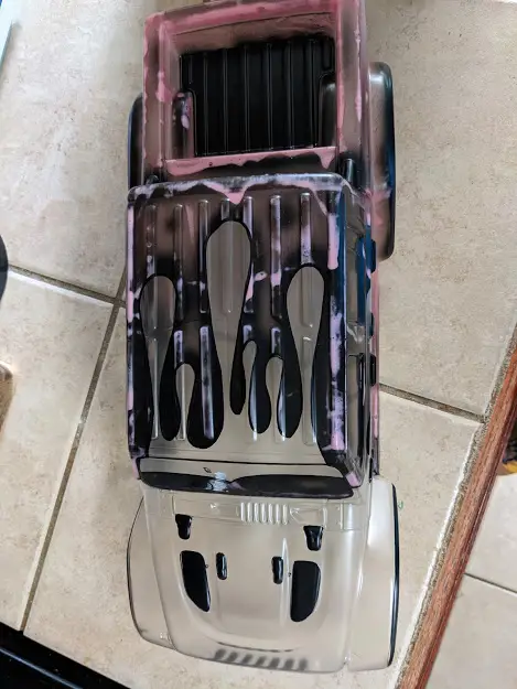

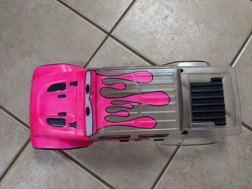

The first color I put down was black. You always want to go darkest to lightest so you don't get any bleed through from over spray. You don't need to spray a ton of paint; just enough to cover. I usually hold the body up to the light to make sure it's good to go. Throw it in front of a fan or give it a few passes with a hair dryer. These paints dry extremely fast. I also did the inside of the "eyes" a pearl blue after spraying the black.
1610150291369
1610150321824
Cheers! You've got to have a cold one or 7 while painting. It's the law.
1610150425704
Next is to peel off the next area that you want to paint. This is where you find out if your liquid mask is too thin. If it's too thin, you'll be picking and scraping it out with tweezers, toothpicks, and knives. It sucks. Mine was good to go.
This is going to be a fluorescent pink for the drips and the "eye brows":
1610151143351
1610151190360
1610151221420
I laid down the pink and then backed it all with white to make it pop. The "eyes" were sprayed white as well:
1610151271484
1610151283533
1610151414123
I always leave the overspray film (what you draw on) on until after I finish the whole thing. A lot of people pull it off after they cut the design so they can see the real lines and colors (the film dulls the colors). You can clean any overspray off with rubbing alcohol so it's not really needed.

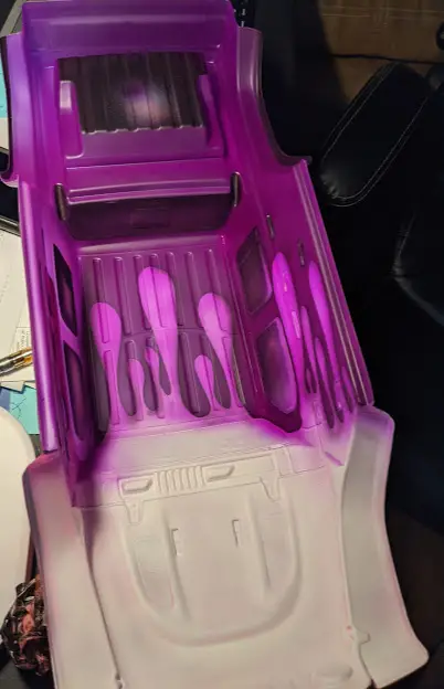

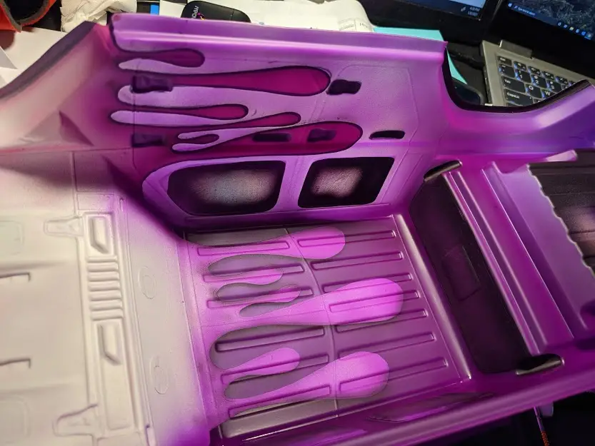

Next I peeled out the mask for the rear that's going to be fluorescent purple:
1610151523845
1610151539197
1610151551017
I used watered down black paint sprayed at 10 psi to do some freehand drop shadows under the drips. I tried to take pictures but they are so faint you can see them. They just give it a little depth versus a straight color on color spray.
This is the purple before backing with white:
1610151755794
1610151769969
1610151779144
1610151822594

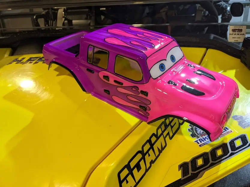

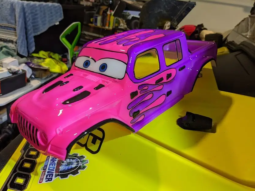

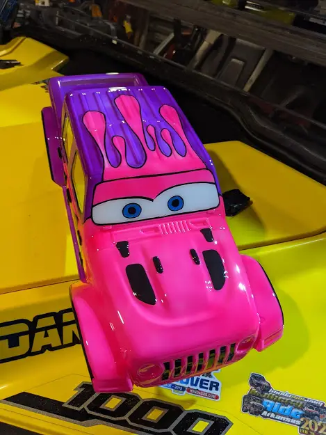

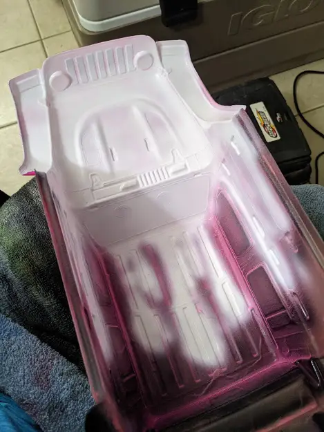

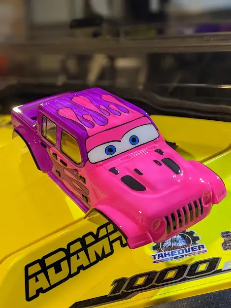

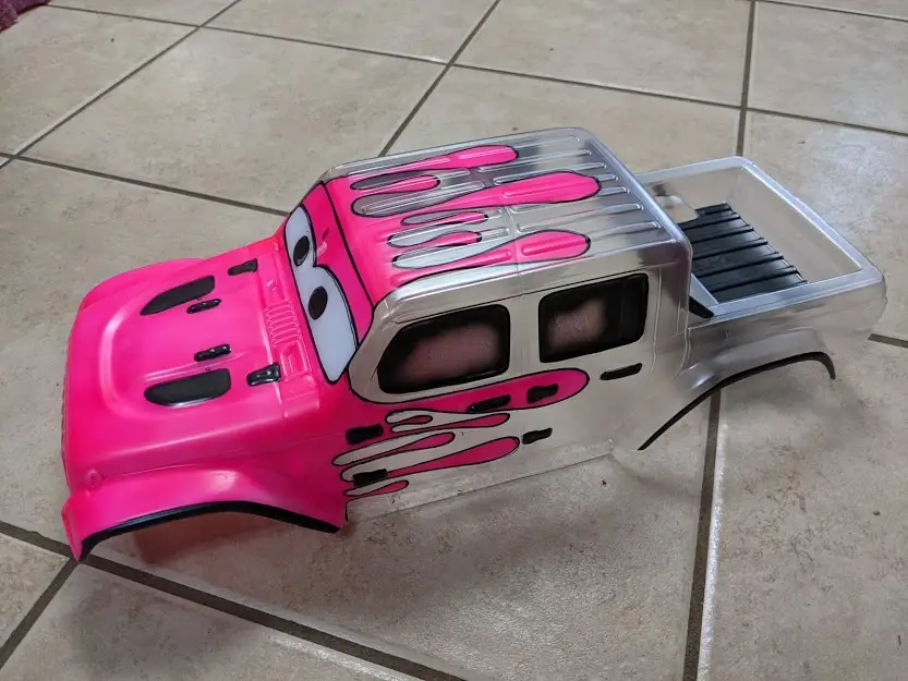

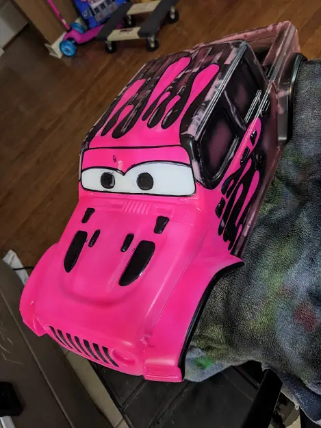

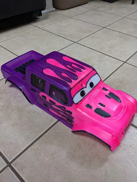

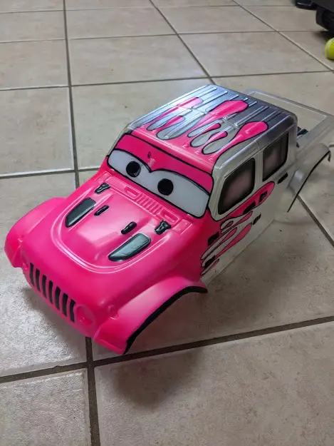

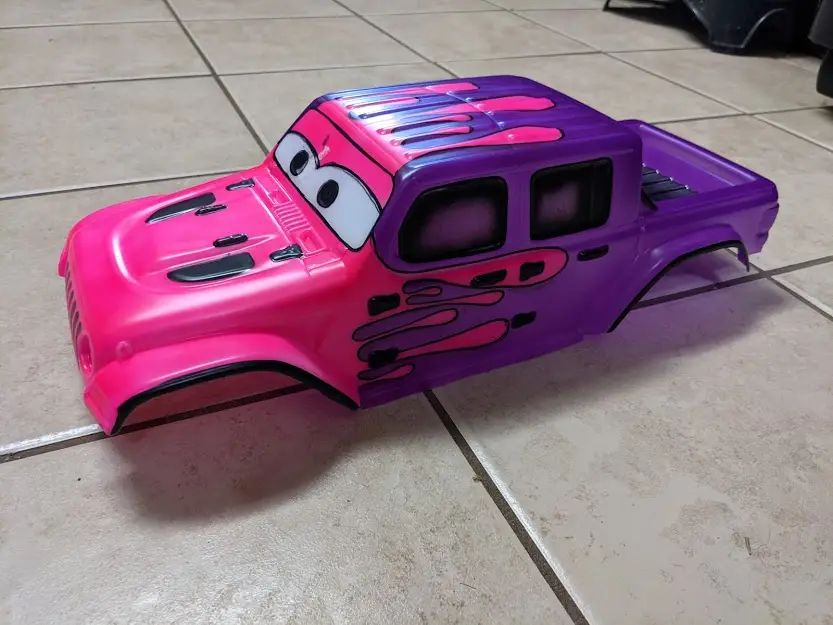

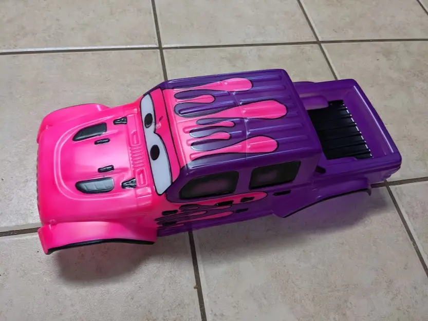

Here's the finished product after backing the purple, peeling off the rest of the liquid mask, and pulling the overspray film off:
1610152049464
1610152000925
1610152011659
1610152026633
