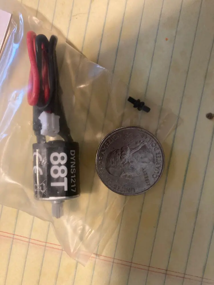

SCX24 motor came a bit a go. Well this didn't fix it, I have forward, no reverse. I think the transmitter is bad, taking the whole thing back tomorrow and getting whole new rig.

SCX24 motor came a bit a go. Well this didn't fix it, I have forward, no reverse. I think the transmitter is bad, taking the whole thing back tomorrow and getting whole new rig. View attachment 292508
The ESC could still be bad as well. My Mini-B has forward and quickly loses reverse after being on for a few seconds. Hopefully they can get you fixed up regardless.

They sent me a new ESC and I bought a new motor, the motor has forward and steering, no reverse. This is without the new motor installed just plugged in, I thinking bad new servo?
Servo & ESC control steering without the motor at all. You can have steering and have no forward or reverse.

Got the SCX24 Jeep going, switched out ESC, motor, transmission and transmitter. The guy that I bought my RC's from told me to come get a brand new SCX24 Deadbolt and change the bodies, so I picked up one today and proceeded into a 5 minute deal, wrong! The drive shafts, trailing arms are different lengths from the Deadbolt to the Jeep, body mount are completely different, so no simple body swap. Pulled both transmissions, removed drive shafts and swiped, swapped ESC's. Now Im up and running!
