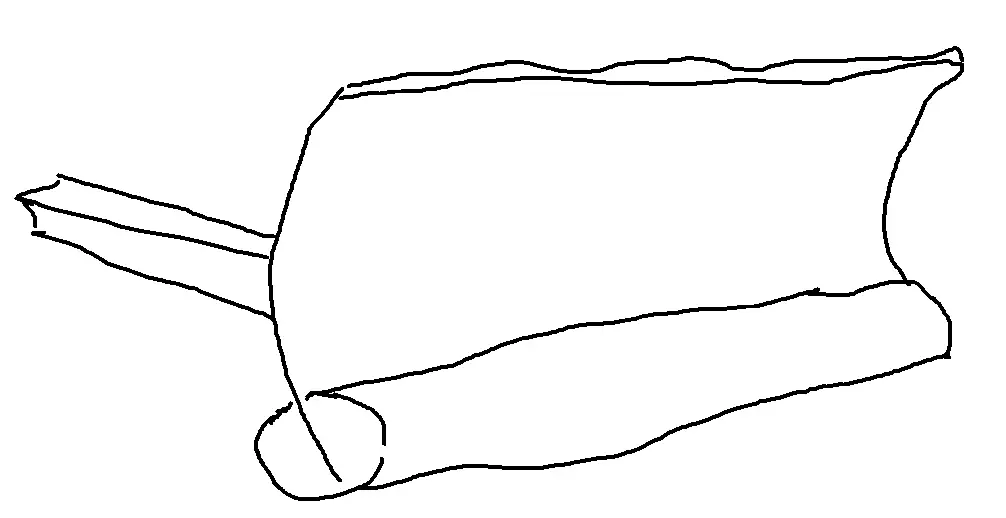

I haven't yet done this, but the company that used to plow our driveway at the cabin up north (about 600' long gravel) took a steel pipe, cut it the width of the blade and then cut a slit all along the long edge. Then, he pushed the bottom of the plow blade into that slit so that the pipe was horizontal with the bottom of the blade, then he welded the pipe to the blade. This gave the entire edge of the blade a rounded bottom, which glides across the stop of the gravel and dirt without digging it up or pushing all your gravel/stones/dirt when you're pushing the snow. I'm not very good drawing with a computer mouse, but this is pretty much what I'm talking about:

That won't work either unless it's extremely compacted or the ground is frozen, the skids will just dig in. Tore mine up pretty good once is how I know. Just don't drop the blade all the way and go slow.
I saw somewhere a while back someone attached a tie-down strap to the blade and attached it to the cab so that the blade could be adjusted just an inch or so from the ground. Might have to try that.
I like that Idea. I was just thinking and was wondering what If I used a pool noodle....then I realized I am an idiot.

Ive seen a few different variations of blade coverings for gravel driveways. If you want a rabbit hole to go into, search it on youtube.
