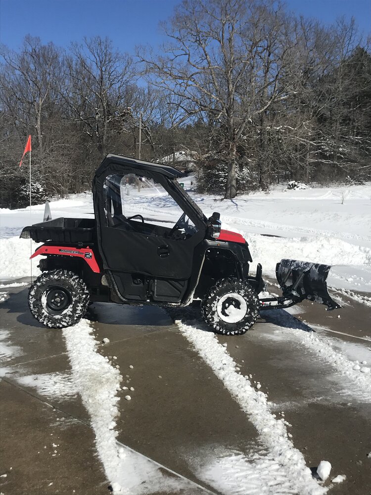

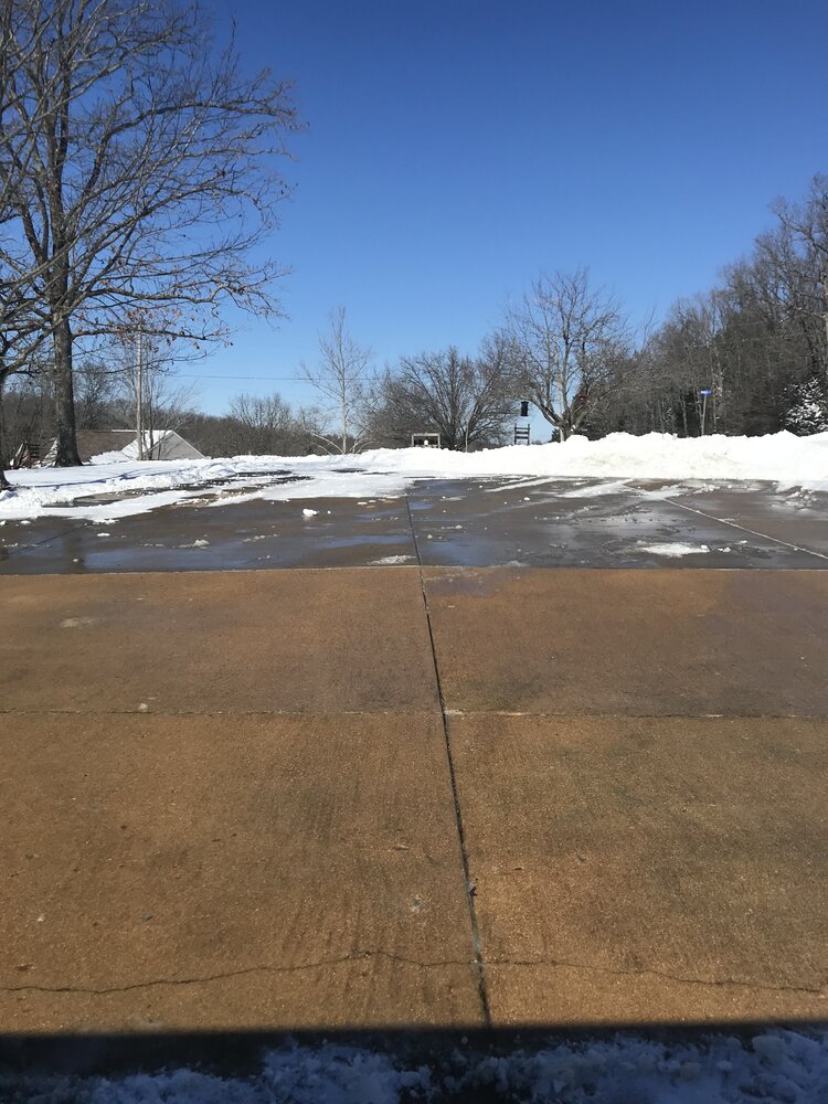

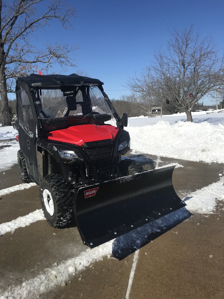

6 to 8 inches with drifts yesterday 02/16/21. Today there's another 4 inches and it's still coming down. I'll get started on it a little later today. Warn Pro Vantage blade. I'm completely satisfied with this setup. Purchased it from my Honda Dealer.
