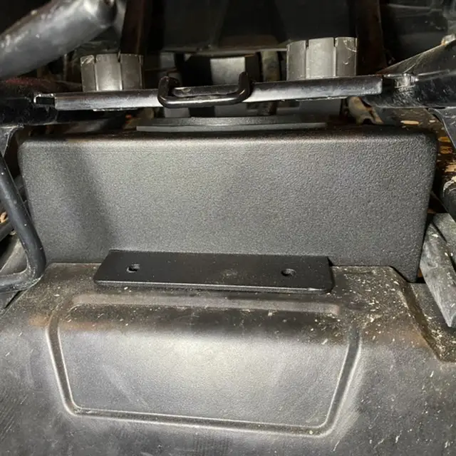

Received the first test box made today. It fits perfectly! I don’t have screws yet for the hatch. Picking that up tomorrow.
I know it’s a small box but fills up almost all of the space under the seat. It allows the seat to slide forward and that’s where it needs to be to get the hatch open and out.
Need to drill 3 holes in plastic for some push pin rivets just to hold in place. No way it will fall out for sure.

Pic of an inside corner shows the inside powder coat, full coverage gasket on bottom to reduce rattling of contents and how the bottom flange screws do not protrude inside the box
The bottom is fastened with screws to allow powder coating the inside. The boxes will not come with any foam lining but owners could install foam by removing the bottom.

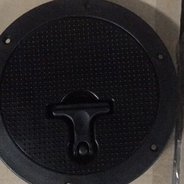

Monte, I fully agree. But I haven’t found or thought of a better, more economical solution yet. The max space for an opening is 4 5/8” x 8 1/2”. And it has to be flush with the box too or I’ll lose more capacity. A hinged opening is probably not possible with these limitations. I continue to sketch out ideas but nothing seems to be the best solution yet. The hatches are cheap for a box that is already expensive to produce.
My glove box is full so I plan is to put everything that I don’t normally need in the under seat box if it fits. Which right now should be everything. Tire plugs, wench remote, spark plugs, etc. That frees up all my glove box space again for phones and such.

Monte,
I can’t make the box raised between the seat frame parts because the way the seat hooks in. This took a lot of foam cutting to get the angle and height right under the sliding seat! The screw in lid is about 1/4” higher than the box top and there is maybe 1/8” of space above that for the seat to snap in place. It’s a tight space!!

Monte,

This is what I’d prefer to use and I think it will work. Ordered a few 6” diameter ones last night because I’m almost certain this is what I’ll use for the X4 passenger side front box.
That will get me on board. Thanks for returning to design and figuring out a way to get that size access...👍
