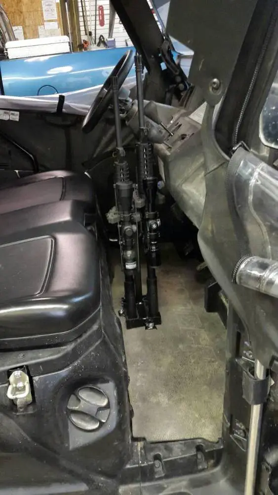

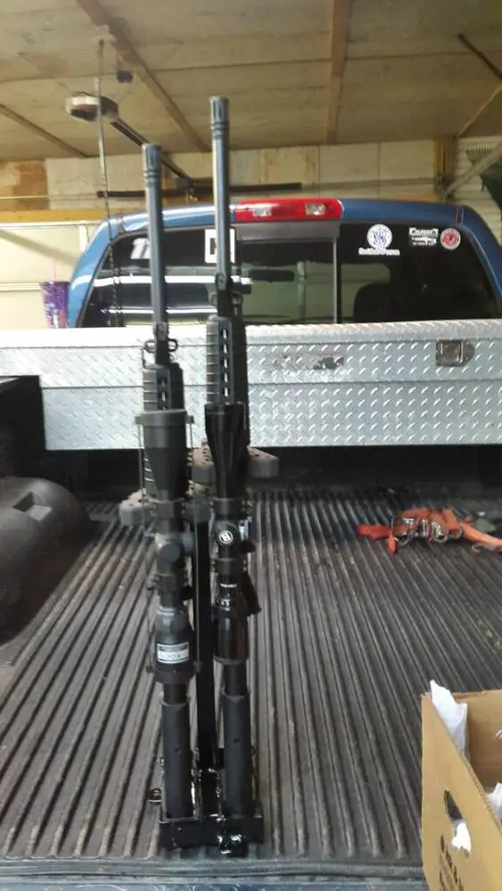

I finally came up with a mount design I like. obviously there's not a lot of room to mount 2 rifles side by side in a 700 do there was a lot of trial and error involved to make this work. The mount is bolted to a steel plate under the floor mat that is bolted to the cross members under the floor. The rubber grips are made by Kolpin, I bought them from Amazon. B0ffcc0b8f785d77a338961bae15bcef

Could you send me the Amazon link to the gun mounts you are using. I want to stand a gun up on the floor; maybe tie it to the dash. Your images are all long shots. What are the guns sitting on? A rubbery pad?
Thanx! Al

I made a boxed platform for the stocks to sit in, lined with some rubber belting material I had. no link but here's what I used, don't go any smaller, these fit snug enough Bcf50c49d5c34ad8ff824490ecdc0a7b
