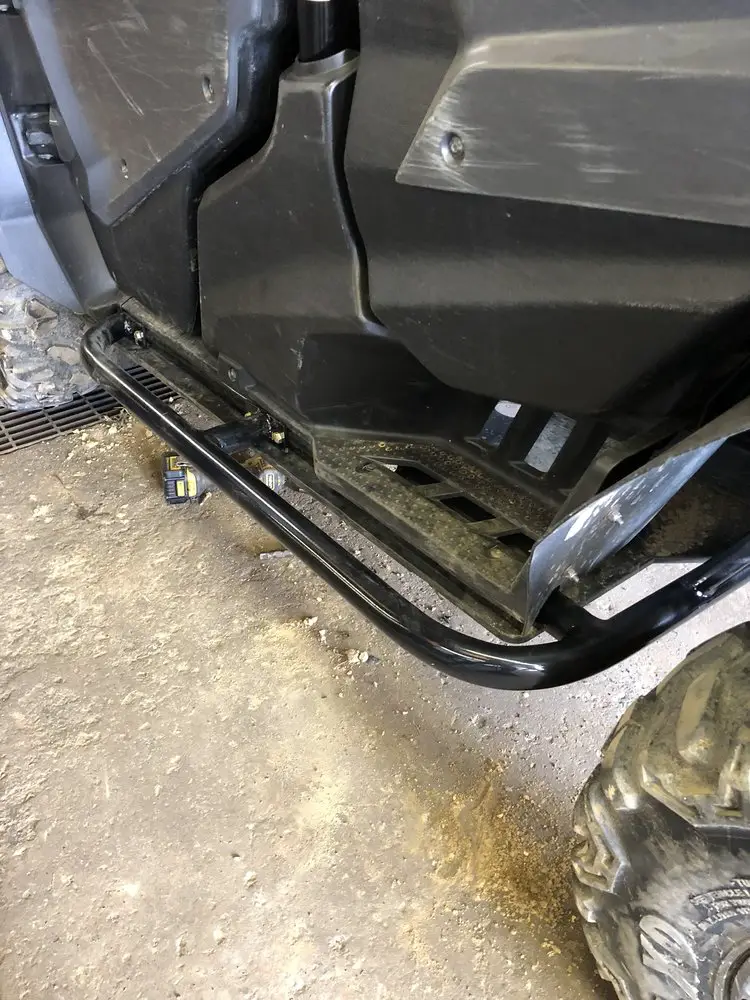

You could do rock sliders that don’t hang off much. They pickup most of the bashing

My next rock sliders will have the u channel to attach to the rails.
I was looking at adding u cannel under each rail. You would have to notch out in a few places but it would give you a good firm mounting surface to attach skid plates
Really nice job building those. I like how you tied it all in.
I will build a side bracket like that to the frame. Pioneer needs it bad. I do believe strengthened up rockers and the rear brace will be plenty overkill.

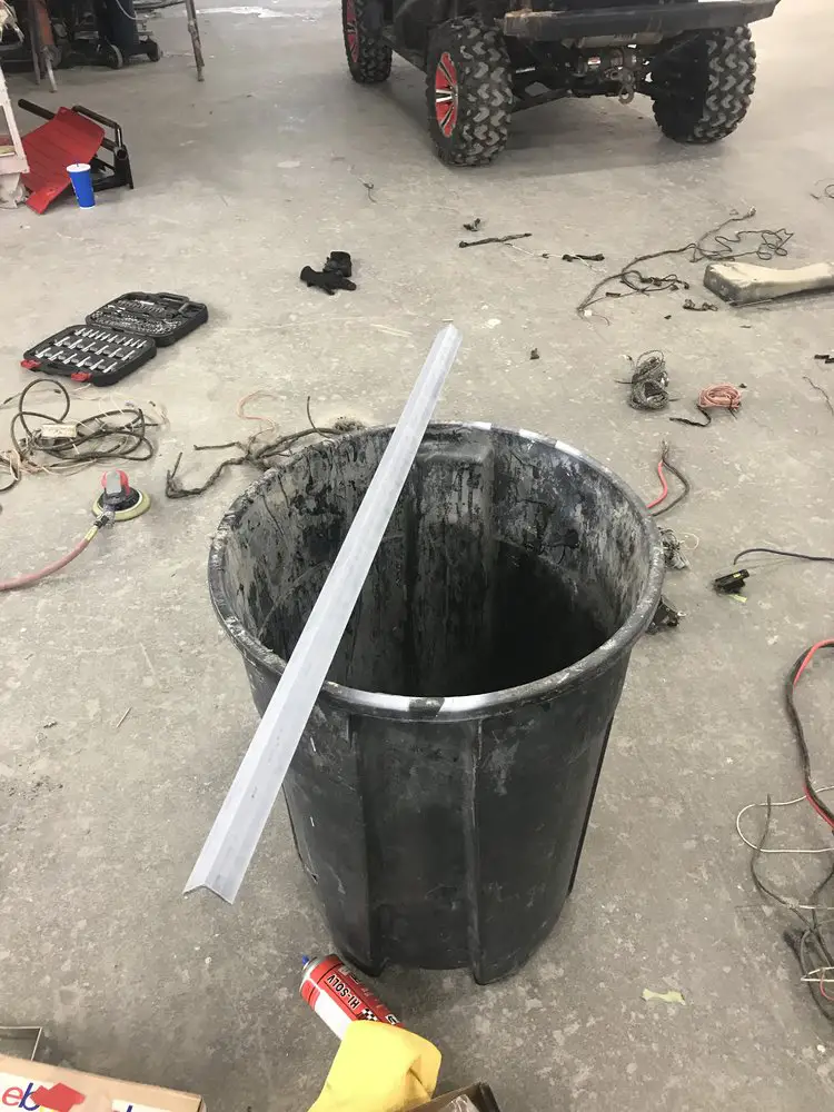

Bought 1” angle tonight and held it up to the rockers and it was fine but skid wouldn’t mount squarely through. I’ll pick up 1-1/4 3-16 thick angle tomorrow. Trying to stay narrow as possible so it can’t snag and looks factory with minimal plastic trimming. I’d love to use heavy pipe and cut in half but have no way of doing that. Hell bent to get this done before the pretzel happens again.

Well... we’ll see how these do. I don’t have time to brace the back like Windrock did and add my side sliding tubes... but that’s on my list. 2”x 1/4” angle just bolted thru will give me a good base to go from. I ended up having to do this in order to have a proper mounting surface for the new skid plates. I’ll thread the angle finish the inserts and then be ready to rock and roll... Literally!

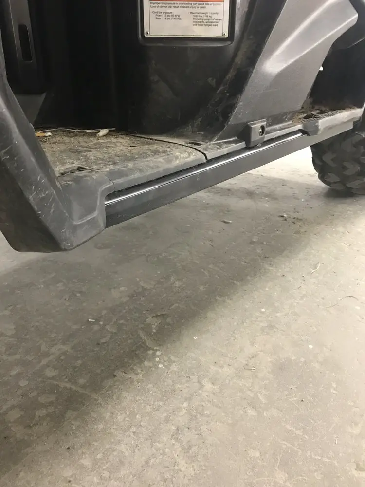

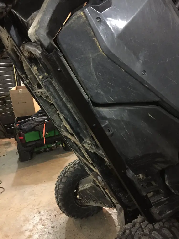

Ok so I cheated for the weekend. I actually think this would hold up pretty well if the skid plate screws through.
Simply took 1-1/4 angle 3/16 thick cut to size,sanded and used a metal etch then flat black, added double back, got it under the front plastic so it doesn’t catch and installed. Cost 25$ and 10 minuets. I’ll probably weld these on later but curious to see if it holds up first. It’s got to protect drastically better then without.
F4F93BB4 95BA 4014 9C9F 0E8DB2D86E2D
4FA5F5C8 123F 4D4B 8790 EC5EDBB63D9E
3AA1901B D3E0 4367 AF9F 88211AC97EE1
Better then nothing, no skills required. Report back later!
View attachment 72124 View attachment 72125 View attachment 72126
Very nice

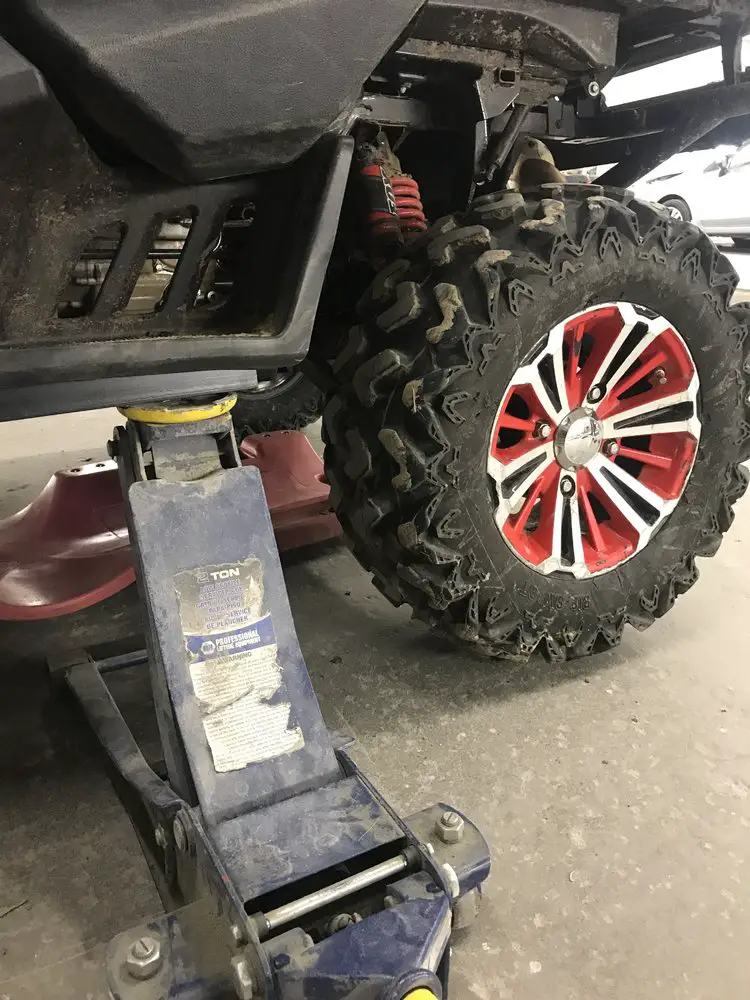

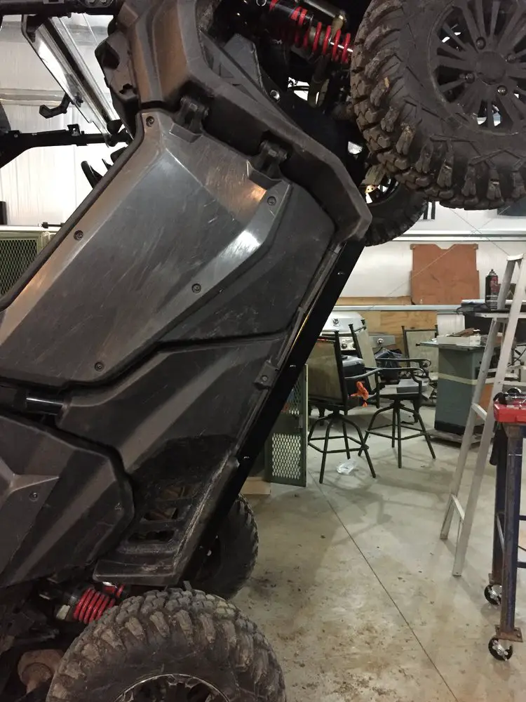

Well hell! Jacked the side of the rig off the weakest spot under the angle iron. Rail never moved it just transferred the weight down the rail. Not bad for double back! But as I thought about it most situations you’ll be pushing the tape tighter not against it. Got a good feeling!
@Tigermark ill have a set ready for the 2 min installation when you get here to at least protect them till we do better!
Our ride next weekend will be the rough stuff now!
Our ride next weekend will be the rough stuff now!View attachment 72147
