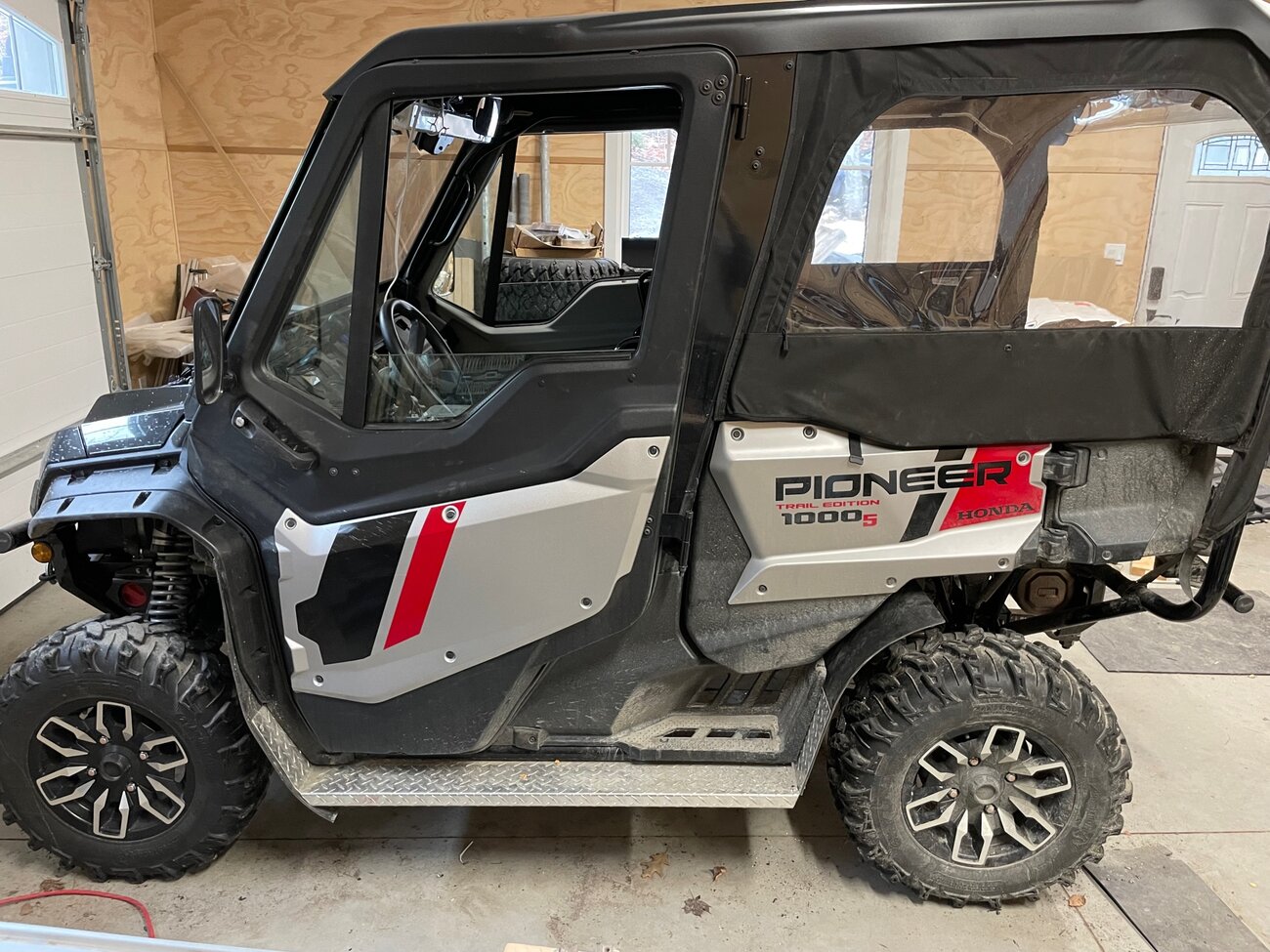

If you are running tracks, running boards and mud buster type of fender flares are the only way to keep the snow out. I now have the rear snow flap running all the way back to the ROPS

where did you get the running boards?i have mud busters on it
I went to a local tin whacker, he made me two lengths .100 aluminum with a 1" x 1" lip I cut and bent the rest. I welded up a 1"x1" frame under the running board and bolted that to the frame. I got the snow flaps from a local rubber supply place. It' 1/4" conveyor belt
