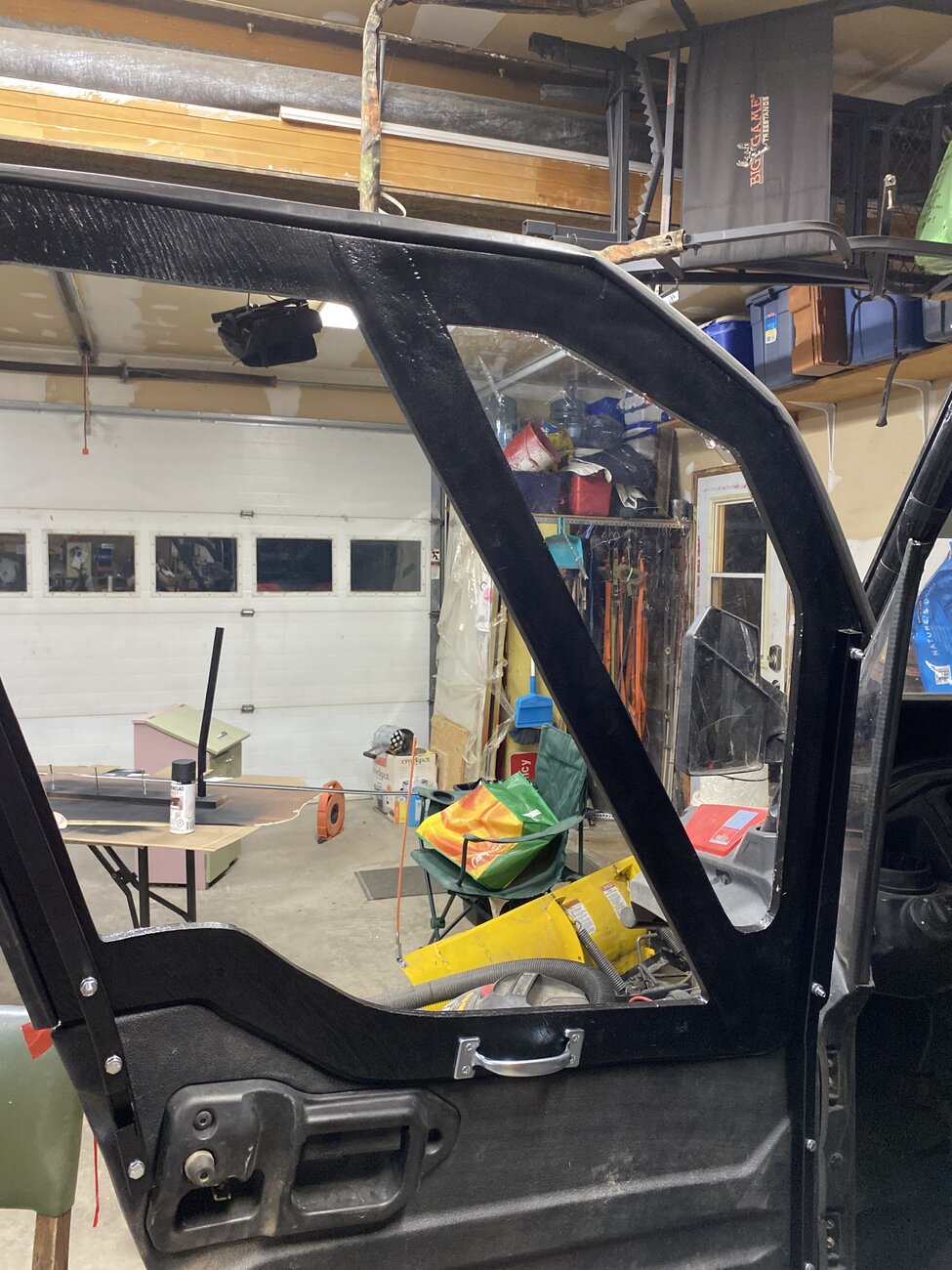

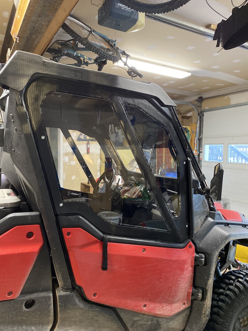

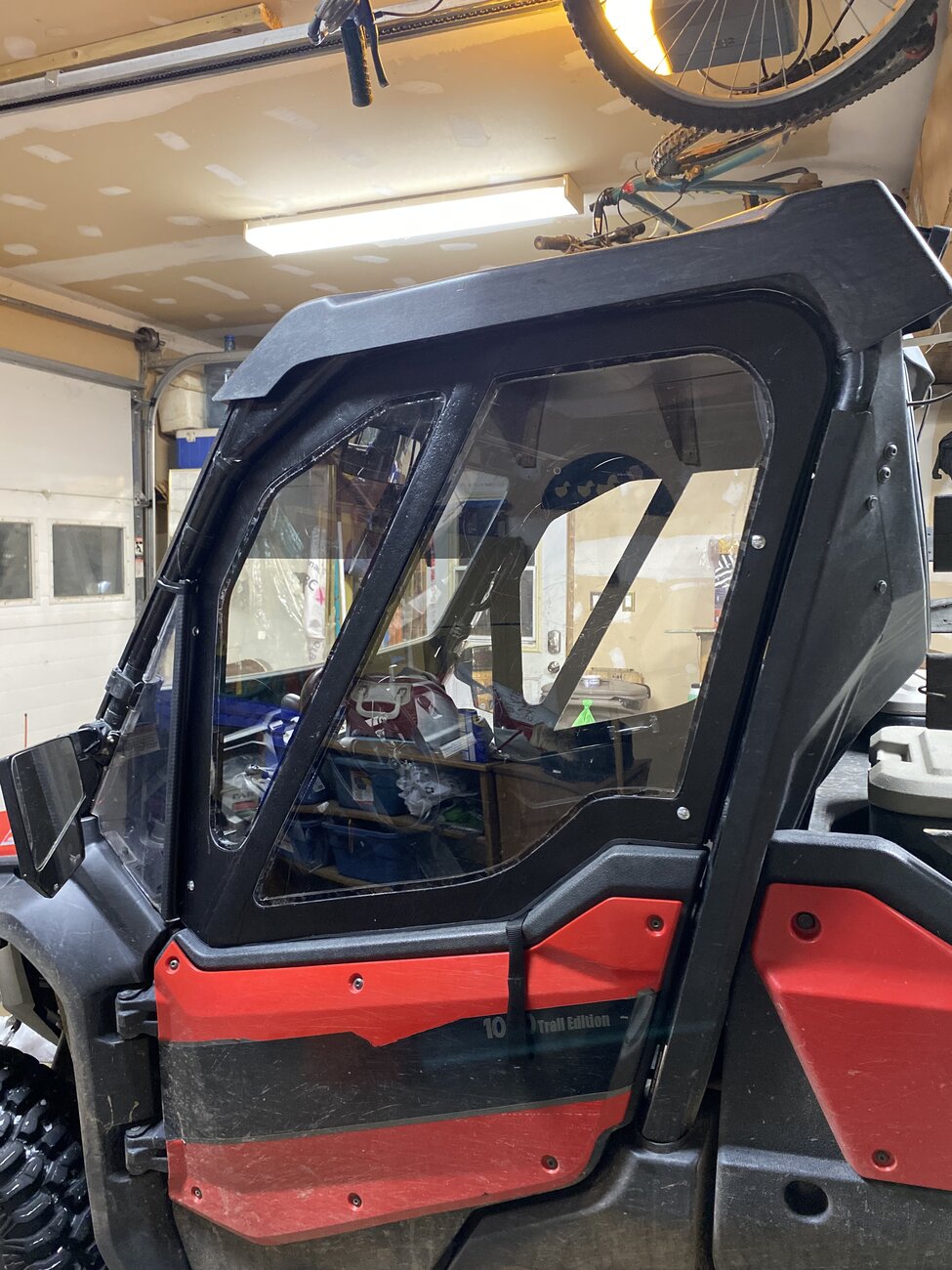

I built these, plywood and plexi glass.
Image Left Right Image
MuddHonda
MuddHonda
Jul 17, 2018
55
158
Fredericton, New Brunswick, Canada
Those freaking rock! Way way way easier to open and close the door. I might get creative with some plywood. They look to be screwed onto the door. What thickness of plywood did you use?
3/4"plywood routered out for the 1/8" plexiglass, biscuits in the plywood bevel joint and 2" fiberglass strip on both sides, 3/4" square tubing twisted and bent to get the right shape, grooved the edge and added weatherstrip, attached to the bottom door with rivet nuts, bent a plexiglass triangle for the front area.
