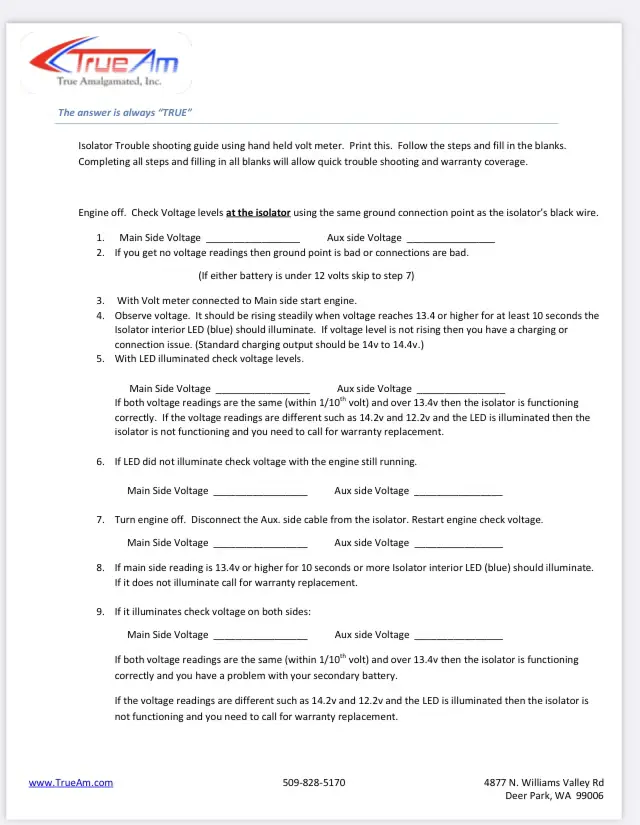

I’ve read this thread with great interest and tried to follow the testing and results.
I went to the Trueam website and they have a troubleshooting testing guide that I tried to include in my reply here. (hope it worked). I think that you’ve tried all the steps required to conclude a bad isolator but maybe double check the procedure. Just trying to help.
new isolator solved problem. both charging at 14.3 now, thanks for all who replied.

Kool. Glad it fixed it.
I'm still pondering as to why it would pass voltage but not be able to maintain it.
IDK... Questions we will never know.
Thanks for the follow up.
