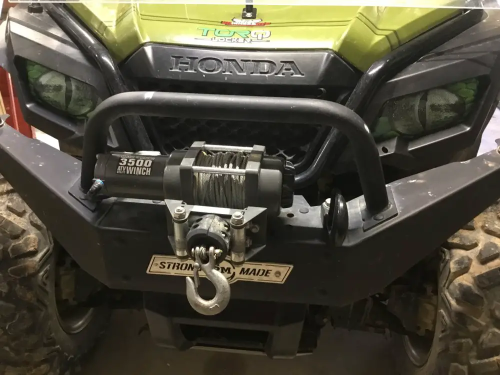

Bought a used P-500 with a winch. That seemed like a good idea but I haven't needed it yet. I'm old & cautious & hate the idea of walking out of the Medicine Bow National Forest or miles of BLM sun-baked prairie. There's never any cell service where I go. Built a cab-back with an oval Lexan rear window and roof from a single sheet of white 1/4" HDPE. Used the 4 x 8 sheet full width for extra shade. It fastens to the cage with 8 or 10 X laced paracord ties that pass through 3/16" holes drilled in the HDPE. Mounted a smallish LED light bar through/over the front of the roll cage and roof. Extended the roof out about 5" beyond the folding windshield which secures nicely with Velcro. The length of the roof's extension is determined by the swing of the top half of the windshield. Mounted a couple of "footman's loops" (search eBay for 'em) to the fenders so the folded windshield secures with the same Velcro that held the top half of the windshield in the "up" position. Put a plywood deck on top of the totally tubular factory rear rack and fit a pair of drop-in rubberish plastic boxes, one on either side of a center frame that holds two lift-out commercial inventory-type totes. Saved 5" or 6" between those boxes and the cab back for my .270 in a $18 Walmart "hard case". Two double-sided Velcro straps though 4 more footman's loops secure the rifle. The set-up only one needs one Velcro strap to be undone to pull out the cased rifle. Shopped the second-hand store for a plastic tub & modified it to fit under the hood secured w/zip ties. The tub holds a bunch of vehicle supplies... oil, plug, manual, & a few wrenches. My design parameters are low cost and keeping the overall width to 50", the BLM width limit on lots of prairie tracks. Used 3/8" plastic plumbing tube to build a cab-back rack to carry 6 or 8 army surplus pouches, also from eBay. Now I'm building a dinky trailer from a Chinese kit. It has a 40" x 48" deck frame. The trailer kit is the kind sold by Harbor Freight and Northern Tool. Its purpose is to pack in tent, cot, water, spare fuel and provisions. I'm welding up a 20" high box for it and built a 3 axis hitch to couple the trailer to the Pioneer. Chubacabra folding mirrors are great but the rear view mirror is all together too big. Happy trails to you!

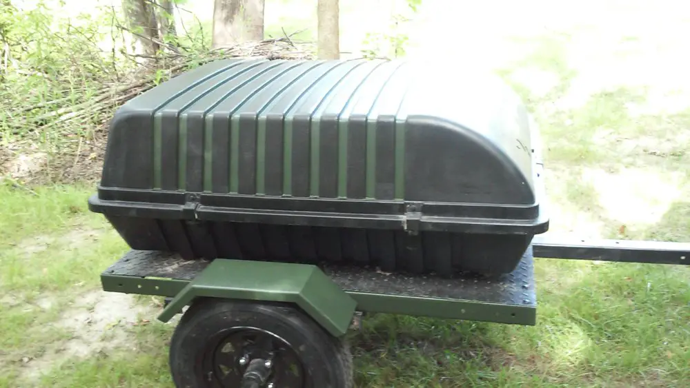

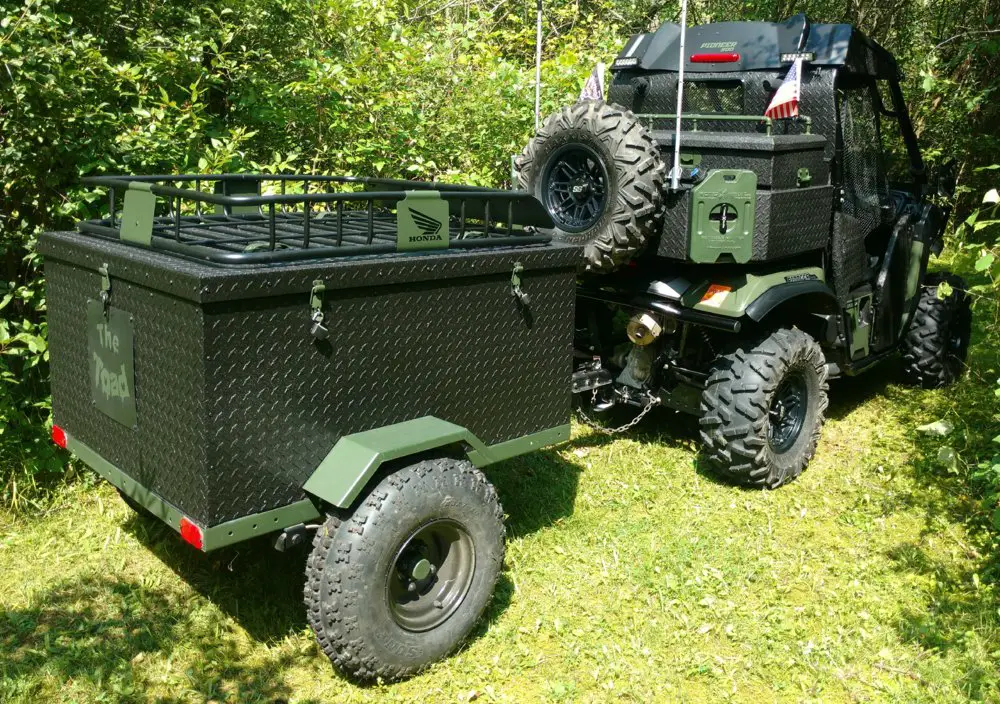

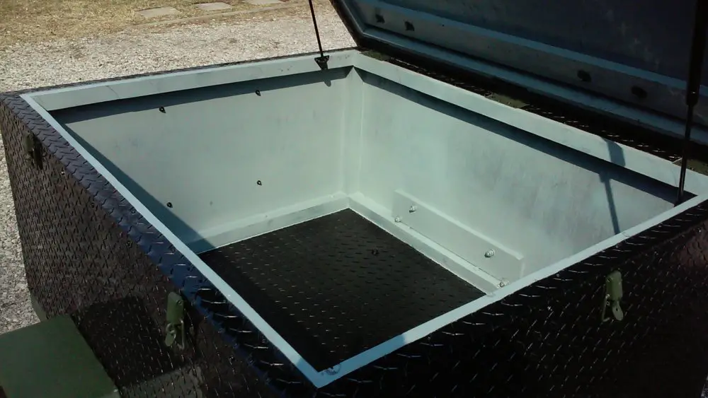

Sounds heavy. I bought one from a yard sale, same thing, HF kit. Guy had a car top carrier mounted to it which worked okay, was water tight and light but didn't hold much. I was afraid of putting too much weight in it and having it snap off the trailer bed and go sliding down a hill or something so I built a box out of 2x2's and plywood and wrapped it with aluminum. Holds a bunch now and much more rigid.
View attachment 158022 View attachment 158023 View attachment 158024
Nice job with your trailer!
