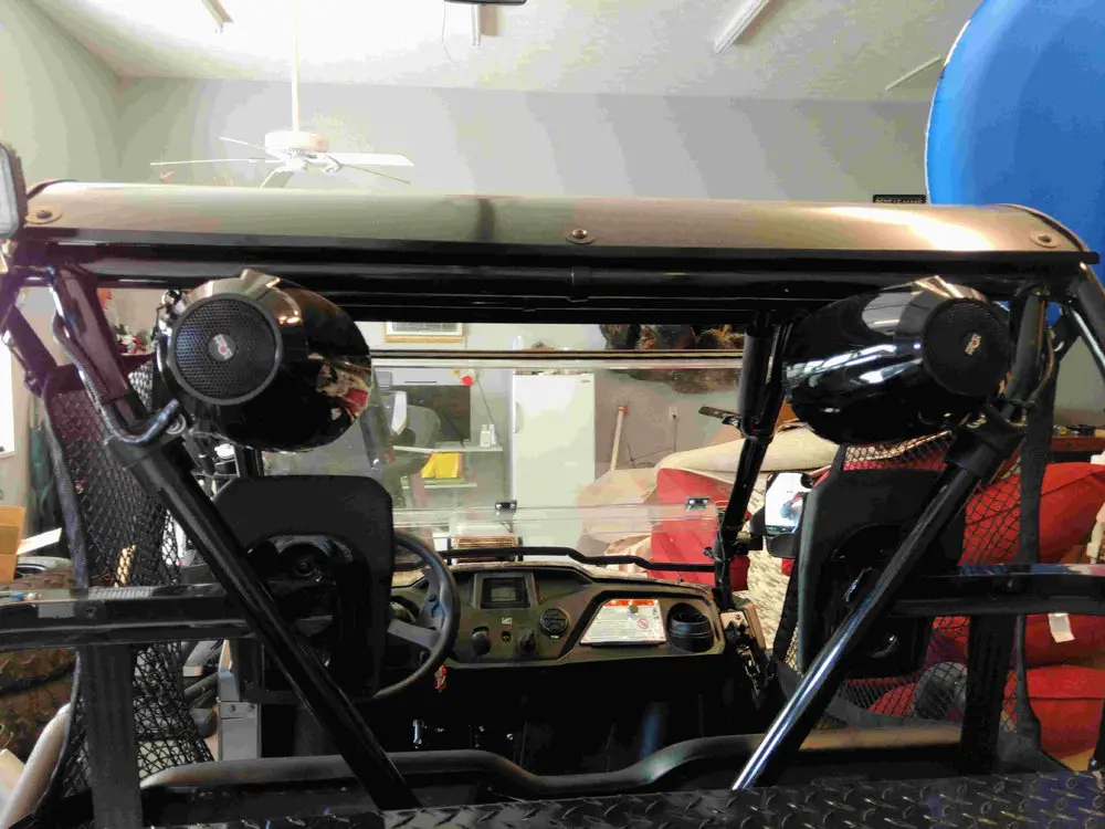

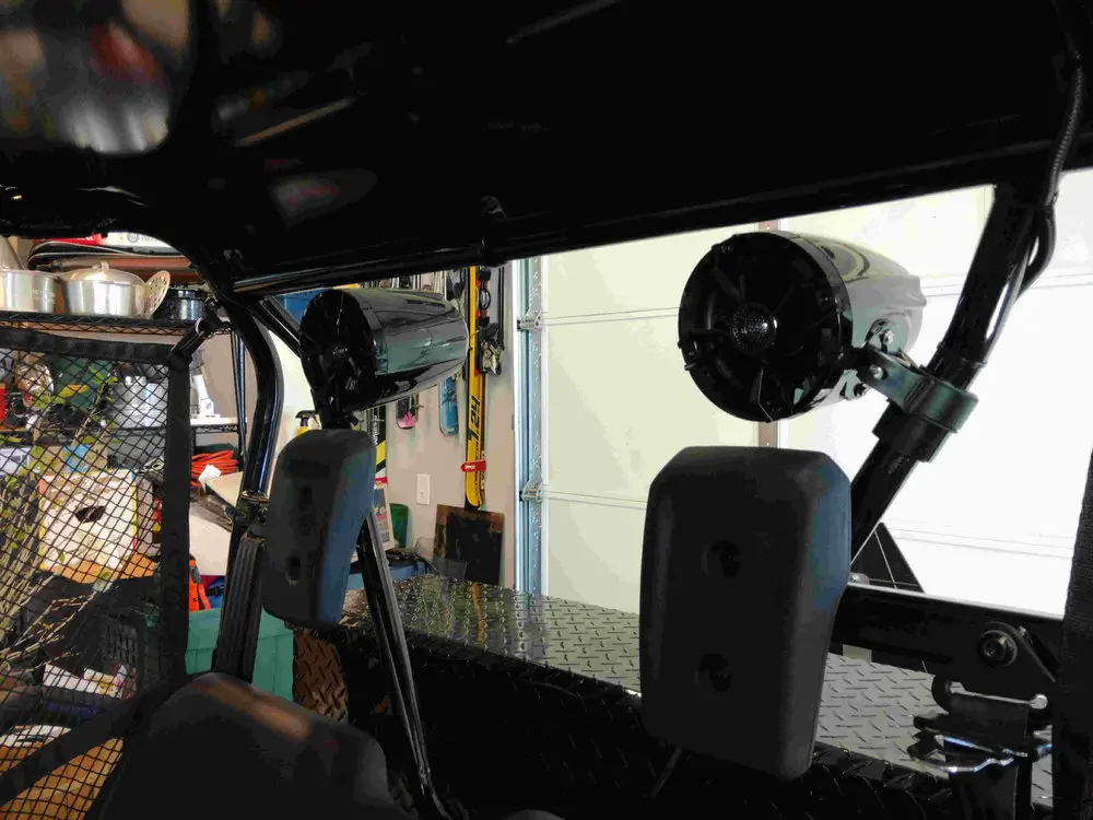

I just installed the NOAM NUTV5 2 speaker system on my P500 (I opted to hold off on the sub right now and was told it would soon be available separately, but it is quite large and not sure where to mount it).
I took it down the road last night and it sounded pretty good with the speakers mounted on the diagonal bars just above head rest.
While this system doesn't provide a thumping bass it is quite loud and clear and maybe a little fuller sound with the passive 3" radiator than a straight speaker? From a 15 minute drive, I think I'll be happy with this system.

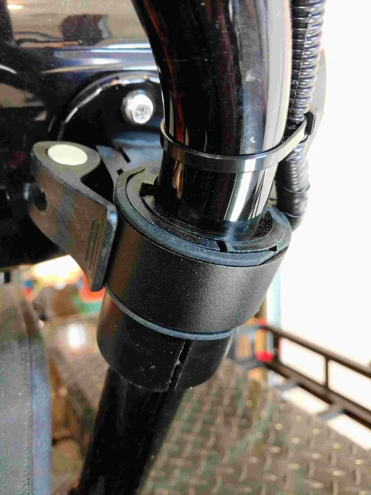

As of right now, NOAM does not offer clamps for either the main ROPS bars of 1-5/8" diameter or the smaller 1-3/8" diagonal bars. What I did was to cut a short piece of 1-1/4" SCH 40 PVC (1.38" ID, 1.66" OD) and split lengthwise and fits over the diagonal bar. I then took same length piece of 1-1/2" SCH 40 (1.61" ID, 1.90" OD) and split lengthwise fitting over previous PVC collar with splits 90 degrees to the 1-1/4" pipe. I think this is a much more secure method than just using tape. BTW, if mounting on 1-5/8" diameter bars you only need to use the 1-1/2" SCH 40.

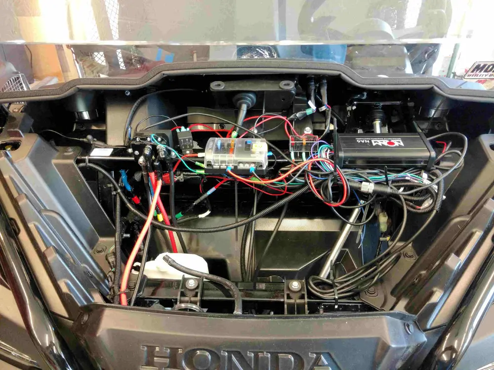

Amp mounted under hood high and dry - wires need to be cleaned up a bit in this photo.

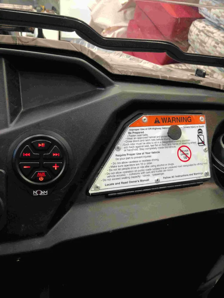

Dash control flush mounted - 3.5mm audio jack barely visible in lower left

Close up of PVC bar spacers

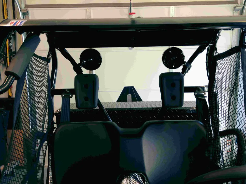

Rear view

Speaker view from front
NOAM7
View from drivers door

Thanks! This is very thorough, and I like that you attached the pics! I'm probably going to go with this unit. Primarily, and after seeing your remote mounted on the dash, I was thinking I really don't want to have to pull my phone while rolling every time I want to change a song. With the soundbar, it looks like that's what I'd be doing, and reaching up and behind me every time I want to touch the volume. Don't really want to mount my phone on the dash either, like I see a lot of people do. To me, that's like taking your phone into the bathroom, eventually, it's going to get messed up, LOL ! Also like that you have a power distribution panel mounted in your hood; I'll be looking for one of those, too. Power's already there due to a previous winch install. Thanks again!

Almost forgot about this post - Thought I would give an update:
After riding the trails at Takeover, I can tell you the PVC spacers worked great, absolutely no slipping of the speakers when clamped down. Sound was pretty good on the trail as well.
