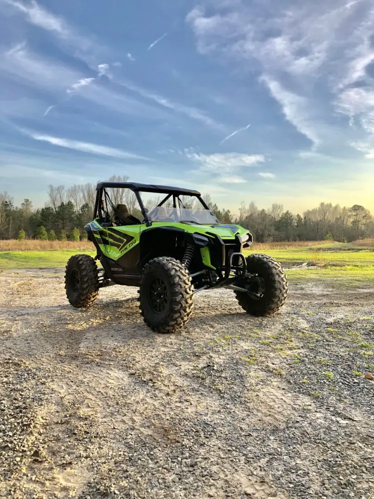

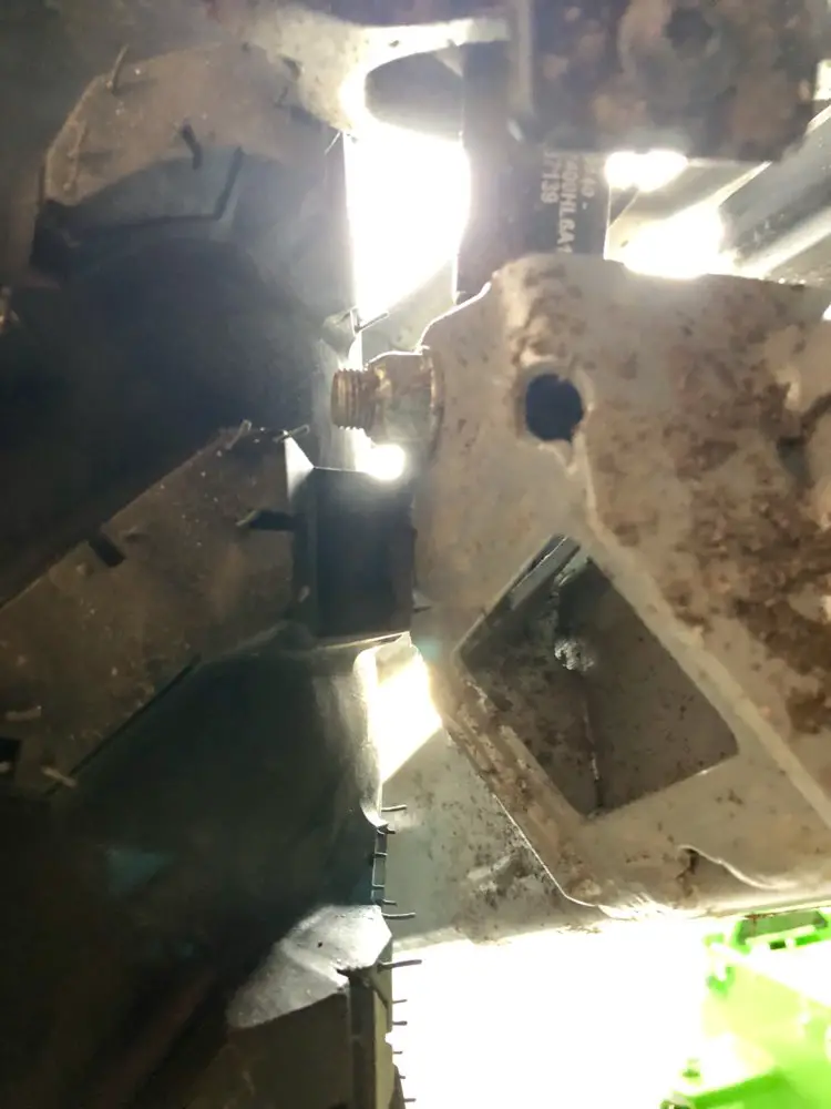

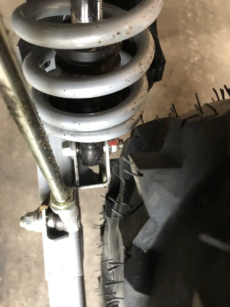

I mounted my xtr370s 32x10-15 yesterday. FYI the rear tires rub the shock/shock mounts when the suspension is at full droop. I have plenty of clearance at normal ride height.
3B9864DB 26EB 4E08 985F 0330C7D75E5B
CFCB871C F83E 4BBB BF80 34ACF3122748
198BEF51 7428 41F9 9D96 407AD01AF6B1
534C2218 A718 4ACC B585 66B5BBB13BA8
EC3BF33B 6BE0 4E48 9926 83637A0916A1
jamesh
jamesh
Apr 11, 2019
253
350
DFW
I mounted my xtr370s 32x10-15 yesterday. FYI the rear tires rub the shock/shock mounts when the suspension is at full droop. I have plenty of clearance at normal ride height. View attachment 189730View attachment 189735View attachment 189732View attachment 189733View attachment 189734
Wow, yours is the first report I've read of 32s rubbing on the back of the X or the R. Interesting. I'm running 4/3 wheels with 1.5 inch spacers on the back so I'm good. But still get slight rub on the front of my X4. Those tires look particularly big on your rig. Looks great.
jonacombs
jonacombs
Dec 18, 2019
20
19
Ga
Thanks! I actually think others with 32s have the same issue but it goes unnoticed. When the rear tires are completely off the ground is the only time contact is made. My buddy pointed it out when I was mounting the wheel otherwise I wouldn't have noticed.

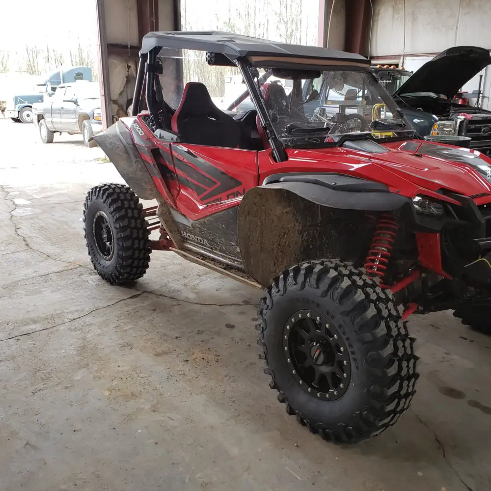

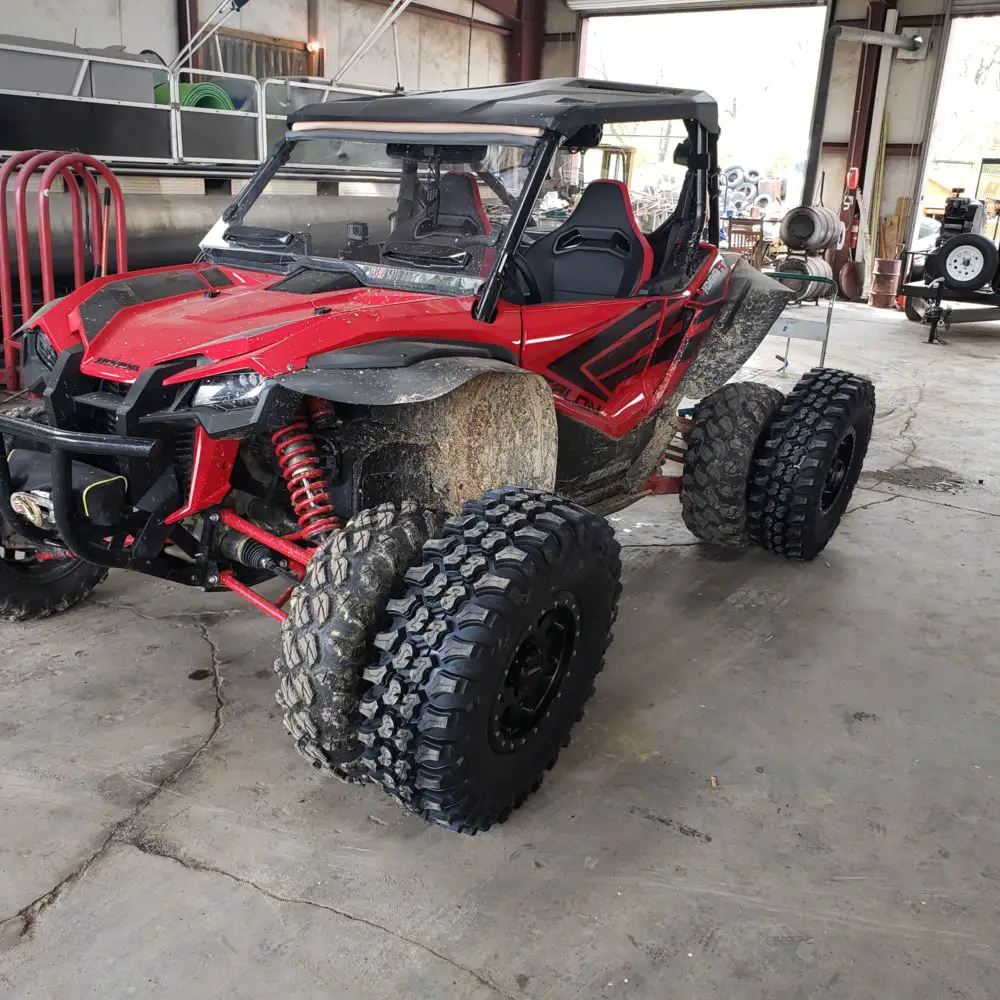

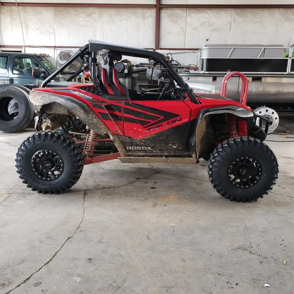

So I ended up going with the MRT Race 30x9-15 up front and MRT Dual Threat 30x10-15 in the rear. These are on my stock wheels. I wanted to keep it as close to stock geometry as possible with this setup. I have not made it on a trail yet, but I am going to be at Royal Blue in a little over a week and will now for sure. But on gravel roads they handled much better than stock and didn't have as drastic of a hit to power as I was expecting. These are a fairly light setup but pretty pricey too. So far they feel fast and responsive in the corners with good grip coming out of it. Looking forward to trying them in Tennessee!
IMG 20200313 165539IMG 20200313 165436IMG 20200313 165514
B
bjniceguy
May 25, 2019
322
431
Iowa
how close to true diameter do they run?
Hometeam
Hometeam
Nov 26, 2015
995
4,155
Normal, IL
On a quick check they run a 1/2-3/4" smaller than the claimed 30" size. The backs being closer to 29.5 and fronts closer to 29.25, both with 15 psi in them.
