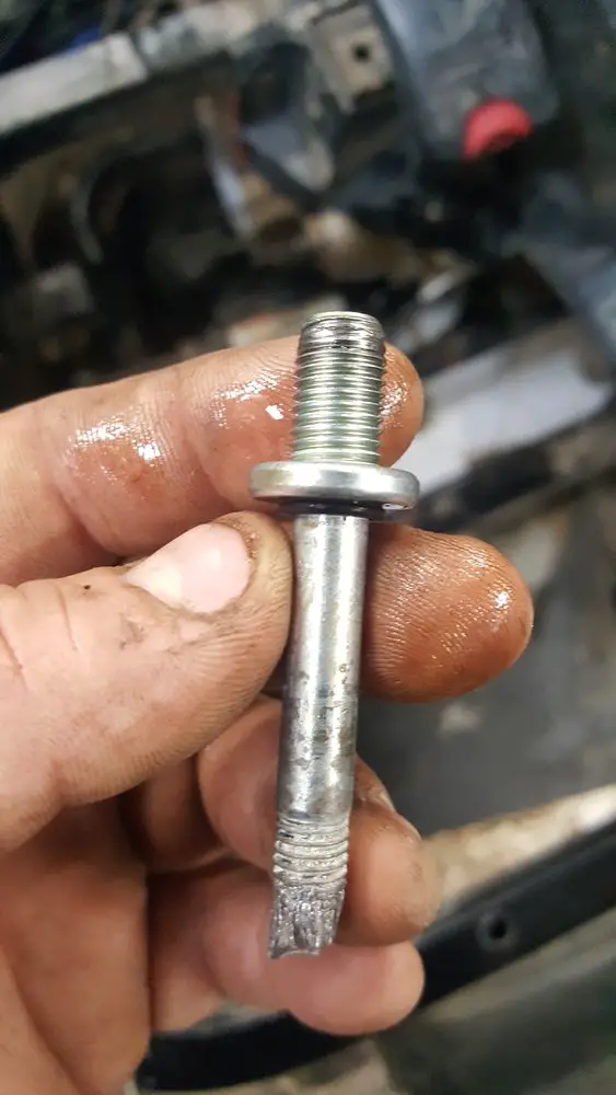

mine was cross threaded on the inside and when i went to adjust the screw split on the outside with very little effort the messed up end is from taking the nut off

if it were only that easy lol plus its only a 6$ part lol
I go to a good dealer and they would give me one free they would make Honda pay for it.

its already being overnighted lol ( 3 day because of the storm)

Mine was stuck in reverse and would not shift till it was restarted.Was thinking about adjusting the clutch.Lots of conflicting data out there.What is your method?Thank you Jak.

well after i put the new screw on i turned it COUNTER clockwise until i felt it just starting to push on the clutch cam plate then i did 1/16th of a turn clockwise and tightened up the lock nut

Thanks for the info. The reason I have to replace it now is because it broke while I was trying to adjust the clutch. I tried a full turn clockwise, and then I turned it back counterclockwise until I felt resistance. Then I went a quarter turn clockwise. After doing that, the bike would change gears but wouldn't move. In order to get the bike to move even a little, I had to turn the screw counterclockwise against the resistance. Then the bike would move, but very little. Any ideas as to why?
