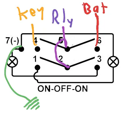

Hi all,
First of all, this is my first real post but have searched far and wide. I just picked up 2017 1000-5 LE and have a bilge fan installed, with a duct into the front floor area to pull air from and hopefully push air into during the winter. For the life of me I cannot figure out how to wire a DPDT 7 pin switch to do the reverse polarity. I have a 7 pin switch and then I just ordered the DPDT 10 pin from the club shop as well. Can anyone provide me with a diagram of how I should wire a switch up to complete this task? Please and thank you!

Try to do use the search bar up top, plenty of info on wiring switches. I'm not very good at posting links but.......
Courtesy of the boss man @Hondasxs

Thanks for the pic! Does this include using a relay? If so Not sure how to include that.
