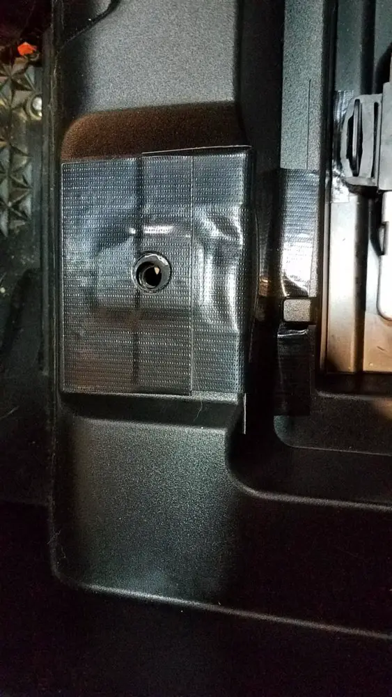

I spent three hours today using black gorilla tape covering all the cabin holes and giant gaps. Taking out the seats and frames made this possible. I made sure I left drain holes where appropriate, in each area. It took about a fourth of a roll of tape. Hoping to reduce dust entry. I attached a photo showing an example of one area around the seat mount threads. 20190415 121351
While I was this deep into it, I also added some rubber damping sheet to the mounting of the voltage regulator, it was really loose in its "clamping" system.

I spent three hours today using black gorilla tape covering all the cabin holes and giant gaps. Taking out the seats and frames made this possible. I made sure I left drain holes where appropriate, in each area. It took about a fourth of a roll of tape. Hoping to reduce dust entry. I attached a photo showing an example of one area around the seat mount threads.View attachment 123216
Great Idea.. We run in the wet of spring and also the very dusty of summer... this is a great foresite..
