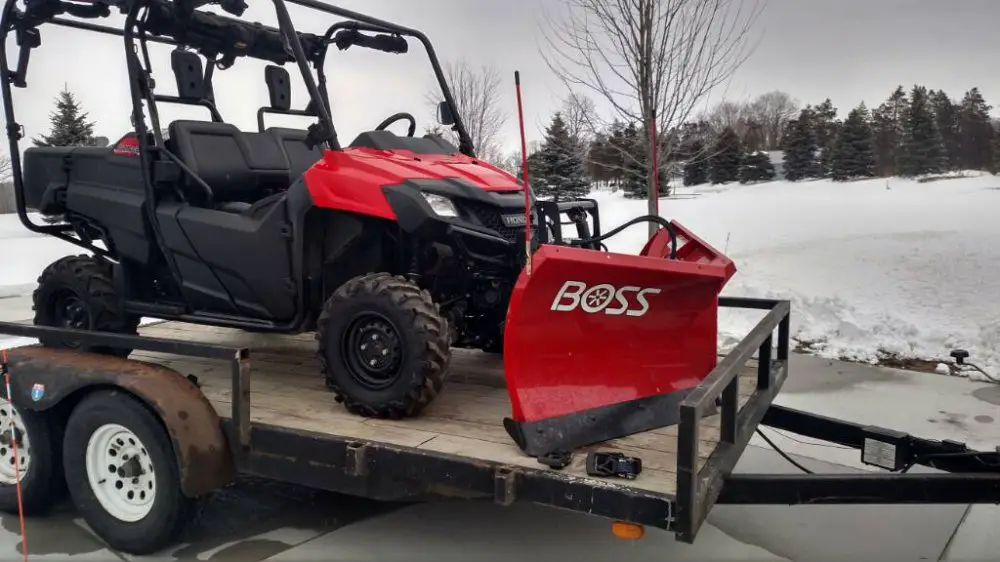

Well, finally got my Boss V plow installed at the dealer today. All I can say is WOW, what an awesome set up it is. Here is hoping for one more snow day to come.

Does the weight of the plow compress your front suspension much? It looks pretty beefy.
Not bad at all. I would say about an inch or a little more. I am going to do the front spring mod with the inch long pipe as spacers, and maybe a spring block on each side. The plow set up is 400 lbs, and it really pushes snow well. I am very impressed.

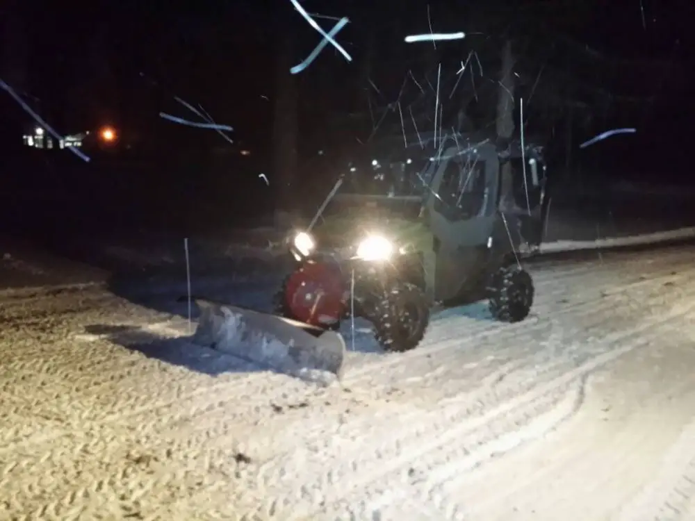

Puts my setup to shame.

Puts my setup to shame. View attachment 10928
Any setup is better than a shovel my friend, and no, it is the real deal. Picked it up yesterday from having it installed. I sure do like your cab enclosure though. Where did you get it ? I might just have to get one before next winter.
