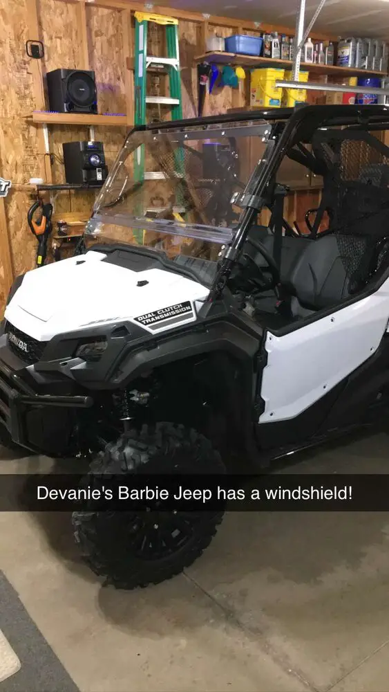

- install Super ATV flip up. Went smoothly and took my sweet time. Also I read/heard tips to putting the side brackets on the frame first, then bring the windshield to it and put on the two pivot bolts. Worked sweet.

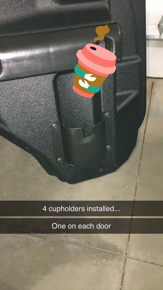

- installed the factory cup holders on each door

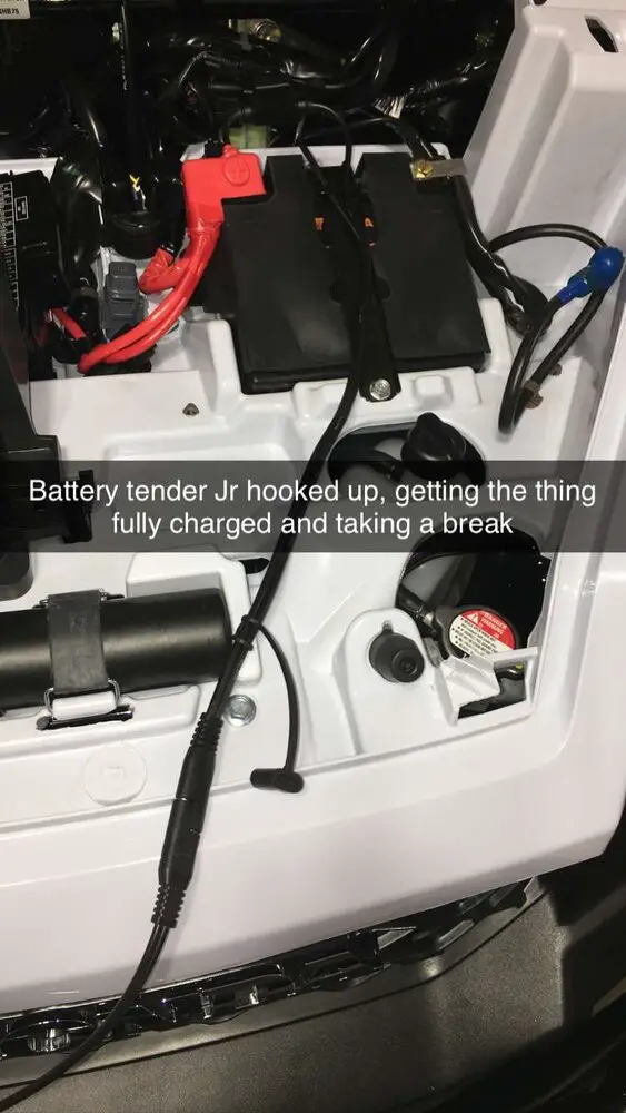

- installed battery tender jr quick connect

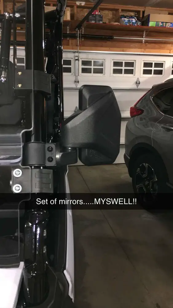

- installed Chupacabra mirrors

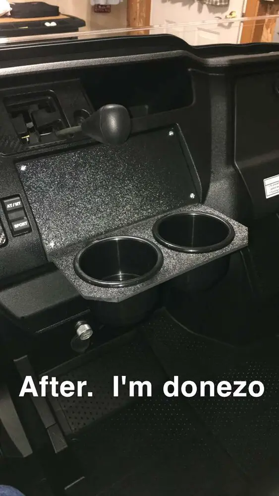

- installed front center cupholders where the warning label was

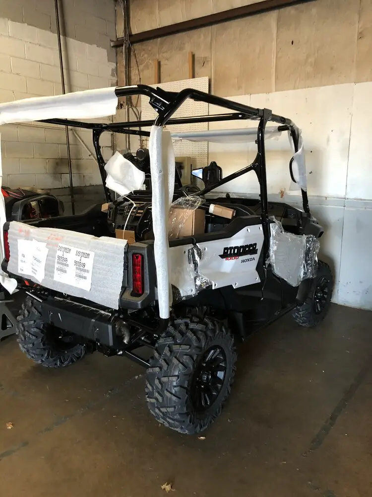

Rops not installed when shipped, the dealer puts those on.
No they don’t, mine straight off the truck from Honda. The ROPS is factory installed.

They come in a crate with the suspension compressed. I was pretty certain the Rops was installed by the dealer on those but I guess I was wrong. My dealer had several in the crates when I bought mine and even with the suspension compressed it didn’t look tall enough to have the Rops on already.
Wonder if they changed how they are shipped, mine wasn’t in a crate, it was driven off a truck in a box trailer.

My super ATV windshield was loose too. I tried to tighten it but it will not snug all the way up. Did you have any peoblem getting yours tight?

Nah, seems like it’s all snug now. I had to tweak on the bottom part a little to get the weatherstripping tight against the hood but other than that I just tightened all the hardware I found loose. Haven’t had any other issues with it so far.

I installed the quick connect and ran it through that hole with the radiator cap and right out through the grill. It’s just long enough to be easy access that way (aka no need to pull the hood) and short enough that it never gets in the way. I’d attach a pic but I’m at work.

K. Thanks. It seems like i have tighted the claps all the way and when I lift the windshield they twist/rotate a little.
