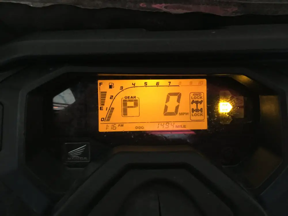

IMG 6355
This is where my first set failed!:(
35,971
212,781
How many do you have now?
Just under the second service, I can't remember, went to look, 386 miles, lost six weeks riding, Christmas and the big crash. Got my trailer back Wed. Finally got back out last weekend with some members at Mulberry Mtn.
