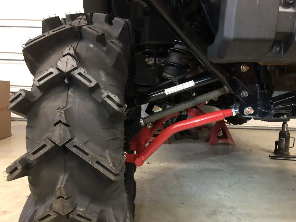

dukeANhammer
dukeANhammer
Nov 18, 2019
60
147
OK cool, i guess I never realized the stock arms did not have grease fittings. So from your photo, the angle doesn't seem too extreme but I guess you will find out when you take yours out. Are you running any bracket lift prior to installing these arms also what size tires are you running? Thanks
You can see the left is still stock and the right has the c fab lift, the angle isn’t changed much and will be less noticeable when it’s let down of jack stands
