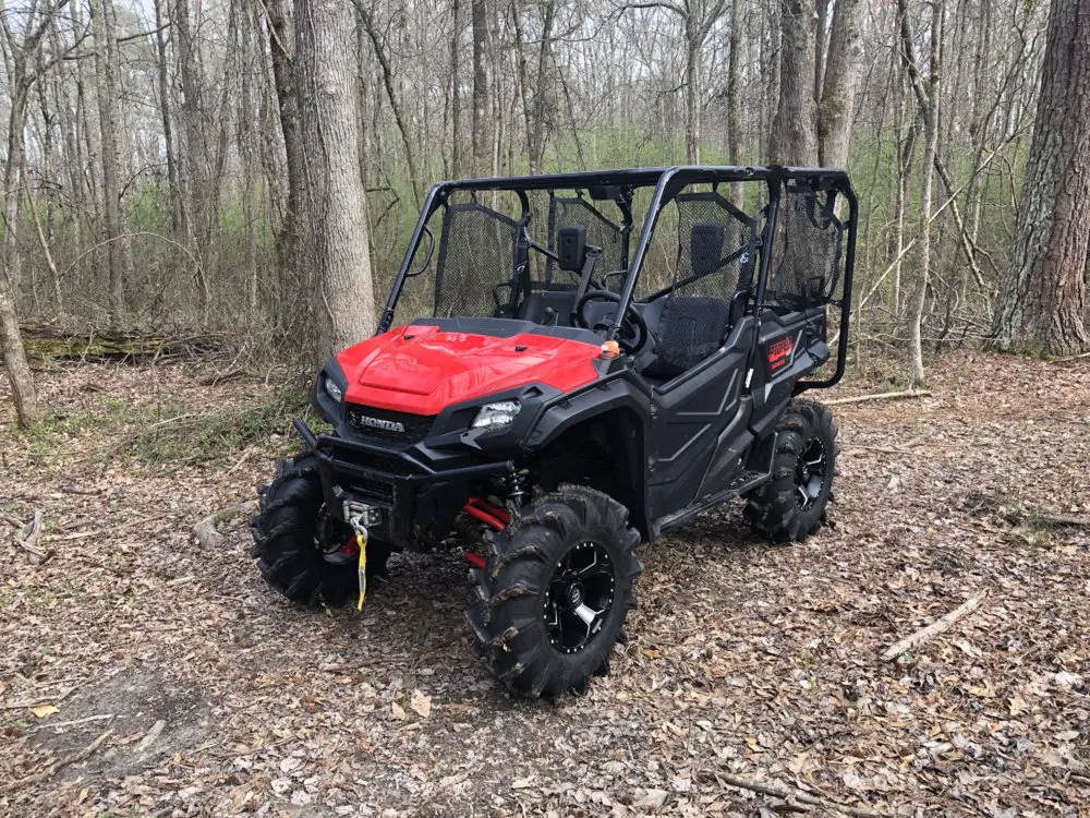

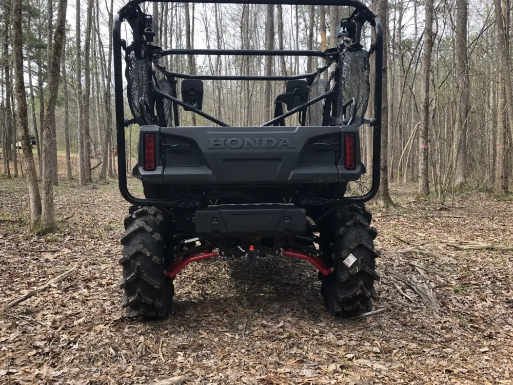

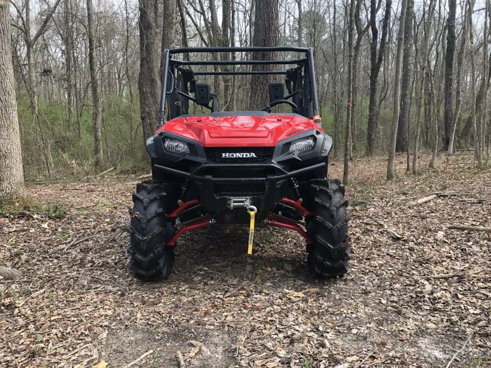

The c fab is 3 inch lift and 2 inch forward rake and the latter is a 3 inch lift with 1.5 inch rake. You will have to add the “snap rings” to the ball joints yourself if you choose to let them press new ball joints in. I let them do it because i wanted a new set in the arms. I actually requested they include new snap rings for the new ball joints along with new castle nuts but their was no reply and they did not include them. There isn’t any kind of tabs for brake lines which i though was odd, like others have stated, using heavy duty zip ties will suffice. I recently ordered my kit and there are still no grease fittings but there’s also isn’t grease fittings on the factory arms. I haven’t run mine yet due to waiting on 2 inch wheel spacers, the wheels i ended up with have a +13mm offset which puts the wheel too close. So as of now I’ll be trying to run with the factory axles/shafts. Here’s a pic of the rear shaft angle
