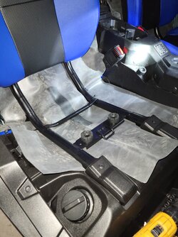

No pics, because it hasn't happened yet, but I'm putting a 7" radiator fan under the seat.
I've built the bracket and have it all but ready to go. Just waiting for the rocker switch.
I'll post pics when it's done.

Do you find the bilge blower cools it off adequately by itself, or have you also installed under seat/seatback insulation? I've done the blower, but the weather hasn't been hot enough to test it. Haven't gotten around to installing the insulation yet.

My 22 still runs HOT and seat gets warm I did a bilge 420cfm fan under seat with the newer improved tray on the 22 models and the Trigger shield to make heat bearable....
