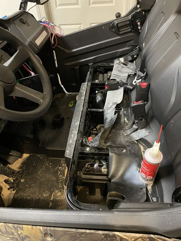

Dual Battery
Stock:
IMG 2556 3
Working:
IMG 2558   Copy
Installed:
IMG 2557
Winch:
IMG 0008 2
IMG 0007 2
IMG 00212
I did add the rubber boots to the contacts before I closed it all up
IMG 2559

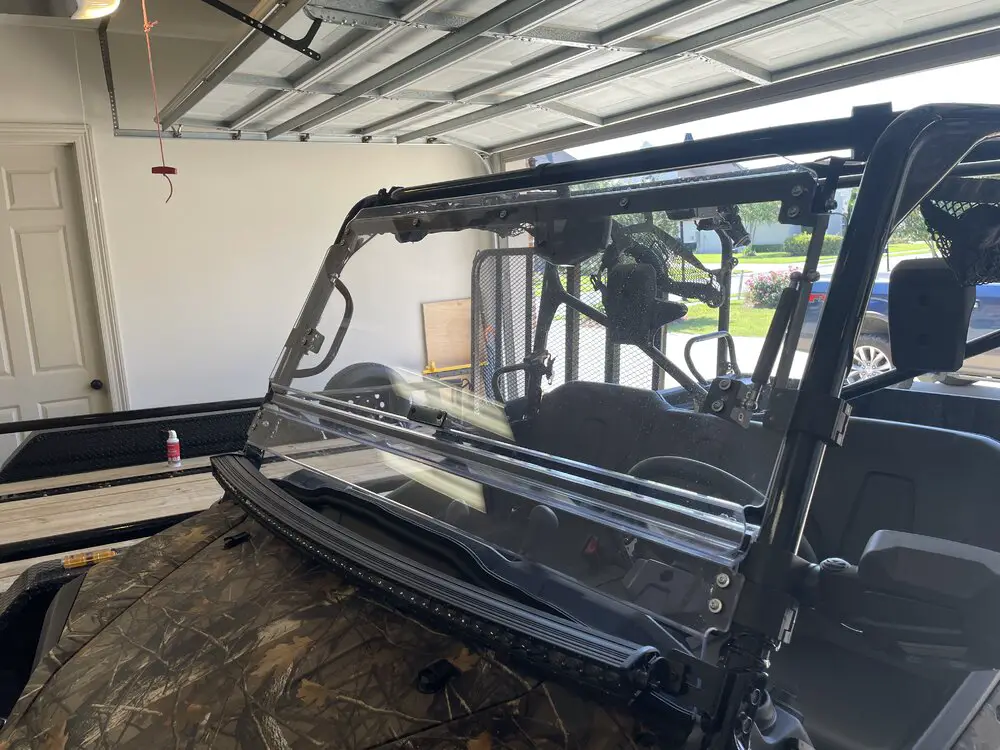

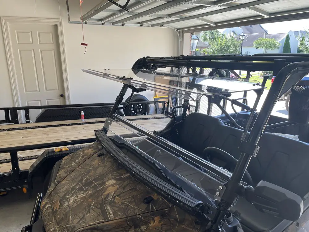

SATV Flip Up:
IMG 01501
IMG 01492
Rough Country Curved 50in Single Row (288w) - wired into Switch Pro so I can dim and strobe
-Don't like the brackets in between the lower ROPS though. Looking for brackets that will fit outside
IMG 01511

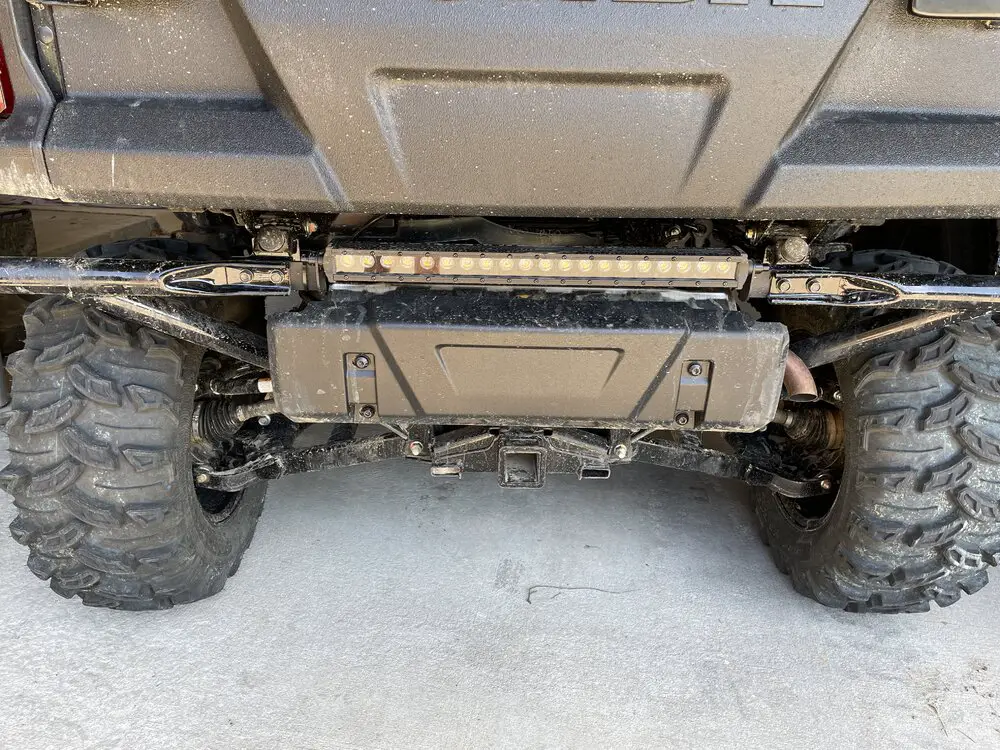

Rough Country Rear 20in (100w)
IMG 01462
Wire Loom for the lights; ran five pairs of 16ga to the back though i guess i should have taken pictures as i was doing it b/c you can't see much with the loom already secured.
Used one pair for the reverse switch signal that went to the Switch Pros trigger and the other from the Switch Pro to the light:
IMG 00732

And still no roof. Though I'm getting close to 100mi so I can take it back to Natchez for its first service. I'm going to get them to put it on then. Had to make sure I could fit it under the garage door with it sitting on the trailer. Looks like I'll have about an inch to spare with the roof on.
So no lift or larger tires until I can get the garage door modified to go up up another foot before it starts to come back. Already checked on that and should be no big deal, but I'm getting nasty looks from the ol lady. It was supposed to stay at the hunting camp and...

Hey Ryan, it's been a while and I probably should have documented more while I was doing the work.
If I was doing it over I would probably go with the Force 12. I'm already worried I might run out of buttons on the 9100. I believe the Force 12 also accepts a negative trigger without having to wire in a relay. So you can just connect the negative reverse trigger wire directly. Adds a third trigger too.
For the rear light, I ran five pairs of 16ga from the back while I was down there. Removed the skid plate and ran the bundle from near where the reverse trigger is on the transmission along the frame, under the seat, across the to the passenger side and then down along the frame and back up to the void area in front of the passenger. Be sure to label both ends of the wire bundles.
Just wired the rear light directly to one of the pairs along with the reverse trigger from the pig tail i bought from the site. But for the reverse trigger wire I had to wire up a relay to open from the negative trigger since the 9100 requires a positive trigger.
For the mirrors, I'm using two buttons on the 9100; one for the green and one for the white. If I remember correctly, there's three wires going to the lights. Two hot, one live at a time, and a shared ground. I believe I just connected switch 1 to the positive for the white light and switch 2 to the positive for the green. The common ground I just wired to the ground block.
And then I have the light buttons set up so that if I hold the button down it cycles brightness and if I press it twice it will strobe the light. Reverse also triggers the rear light come on automatically.

I've only got about two inches of clearance with the Pioneer on the trailer in the garage. I have to wait until the garage door springs go out and then I'll get them to raise the door another foot before it starts to come back. Or maybe I just need to make one fail, lol!
