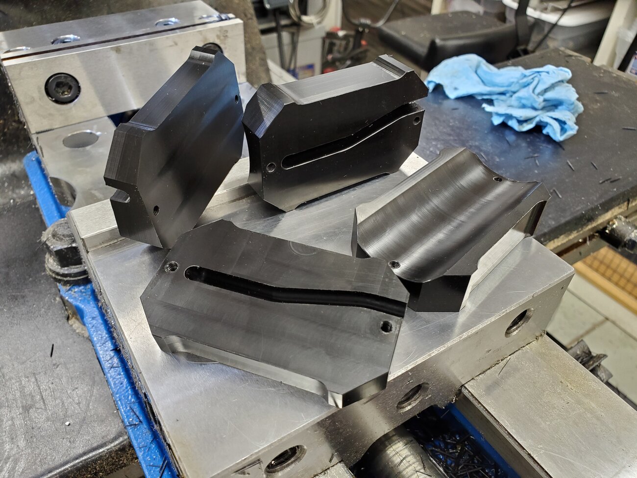

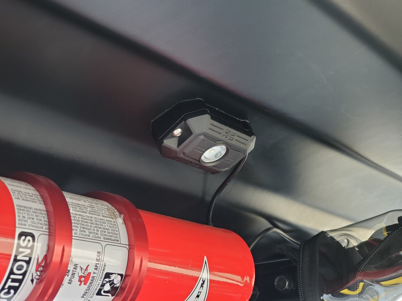

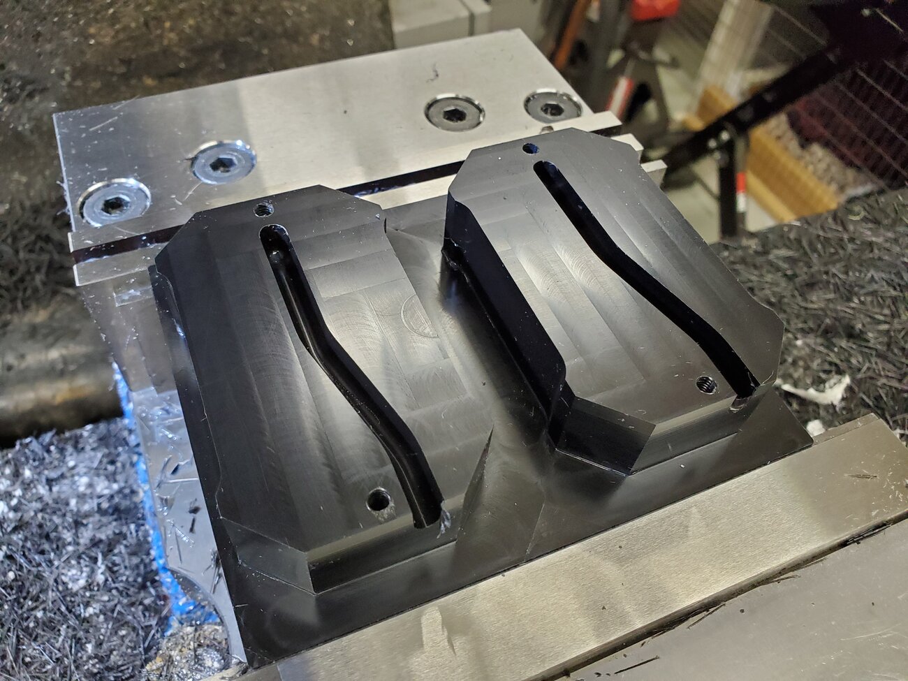

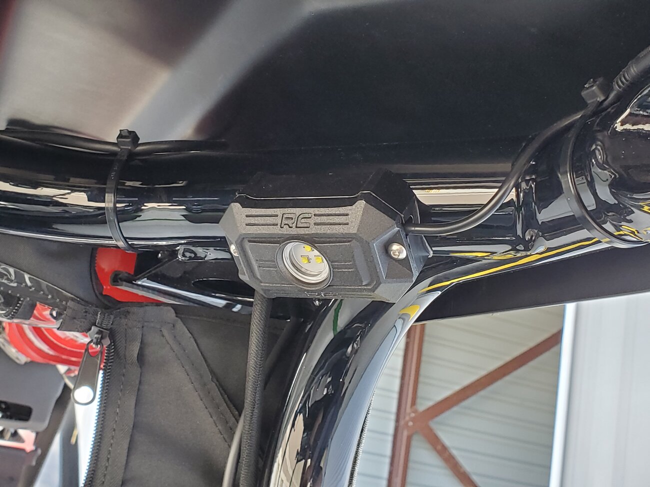

It's been a while since I've been able to do much on the Pioneer. I finally made the Delrin mounting plates for the Rough Country rock lights I bought to use as dome lights and cargo lights. The two front lights are mounted on the upper angled portion of the ROPS, just behind our heads. I machined a radius in the back of the pad to match the bar diameter and basically glued it to the bar with Permatex Ultra Black. The cargo lights are slightly angled and attached to the roof with 3M tape. Had to clean the crap out of the roof to get the mold release or whatever the heck was on it, off, in order to feel good about the adhesion. These things are quite bright, and do an excellent job!
