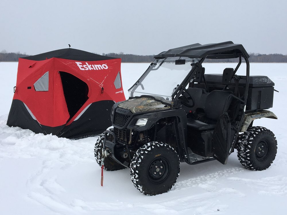

The reason I ask is I ran into a serious problem at a relatively balmy temp of -5F. I ice fished for only 2 hours when I was left stranded 4 miles offshore from my F-150. With a 10 mph breeze I tried to start my 2017 500’s engine. It turned over fine but wouldn’t start following every word in the owners manual instruction.....and the sun was setting fast, my cell was dead and nobody in sight. The plug was fine, full tank of fresh fuel, battery strong.
I was contemplating abandoning the 500 and hobbling (recent hip surgery), cold-to-the-bone, back to my truck. Fortunately I was able to flag down a distant Polaris ATV with my flashlight who towed me back. As luck would have it, the next day she fired right up in my unheated garage at 10 degrees.
It’s a bit ironic that the little Polaris towed me back since a few months earlier I sold my old Polaris Sportsman to gain legendary Honda reliability. I love my little Pioneer but can no longer trust her in cold temps which we have often in MN. All thoughts are appreciated.

My 2016 has started at -5F numerous times without issue, my guess is you have some water in your fuel tank/system. Once the temperatures start fluctuating a lot in the fall keep the tank full so you don't have that much room for humid air in the tank, once the temp drops at night you reach dewpoint and any water in the air is now in the bottom of your tank. Also if using gasoline with ethanol in it loves water and the longer it sets around the more water it absorbs.
