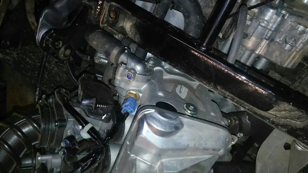

Fcdee3d88b890fe964381d8525d9c77d the blue painted bolt right next to the coolant temp sensor on the thermostat housing is your bleed screw. Im having to do all of this because im installing a heater, and just because over heating aluminum engine scares the bajesus out of me i also took my upper coolant line lose from my heater core and got a lot of air bubbles from it also

View attachment 29273 the blue painted bolt right next to the coolant temp sensor on the thermostat housing is your bleed screw. Im having to do all of this because im installing a heater, and just because over heating aluminum engine scares the bajesus out of me i also took my upper coolant line lose from my heater core and got a lot of air bubbles from it also
Can anyone provide more explicit instruction on how to get to this blue bolt. Broken down overheating on trail and peeling back covers - an hour in and so far nothing looks like this pic. Wondering how far I need to tear this thing down.
