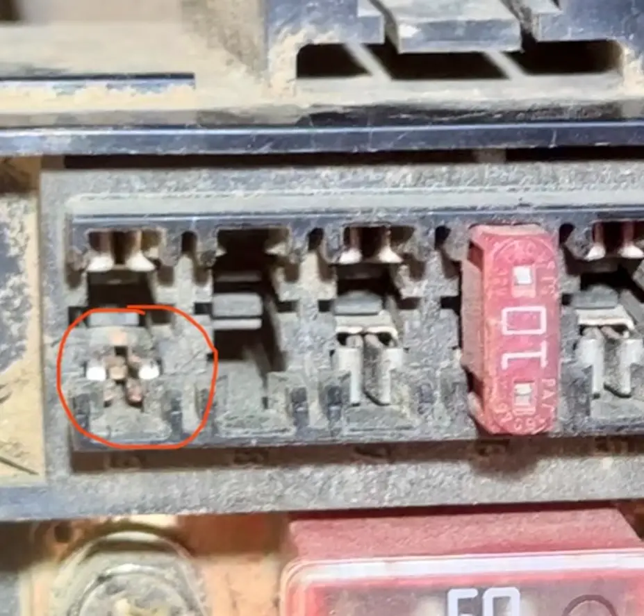

Finally figured out why the machine would occasionally shut off and die while riding. Throw a bunch of codes and dash lite up like a Xmas tree. It’s been sporadic, occasionally fire right back up and sometimes be a lot of f***ing around. I noticed last ride when it did it fuel pump wasn’t making noise with key on when did start.
thought maybe it was the accessory fuse (only fuse I messed with, used an add a fuse for intercooler fans trigger wire) as when I’d mess with it it would occasionally fire immediately after but I kept checking it and looked good. So I went through most all connections and this week cleaned all grounds. Been a pita trying to locate a problem that happens so infrequently. About ordered fuel pump. Last night got pissed and started going through the fuse box yet again started taking it out of the machine and spotted this. Idk how it happened but looks like the terminal was installed incorrectly, and been slowly sparking itself to death.
At any rate I’m headed to wrecking yard to see if a replacement terminal can be found from Honda car, I suspect it should be same.
Anyways I believe I found my last gremlin😊
If you don't feel like messing at the wrecking yard, your local Honda auto dealer should have a bunch of pins in stock.

Never ever thought about calling
If you have a good parts guy that you use for panels, just ask him to look thru the wiring box. Shouldn't be more than a buck a piece.
