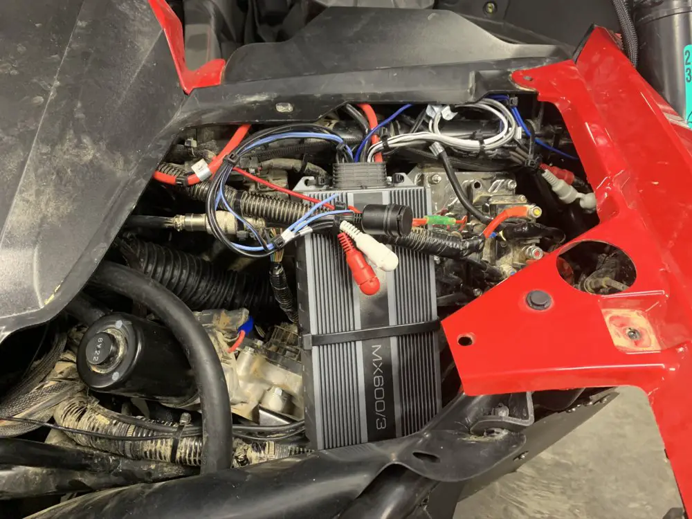

I've got a JL Audio MX600/3 amp mounted under my dash in front of the steering wheel. It's a spendy amp, but it has a small footprint and is, essentially, two amps in one. It's got 2 channels for my tower speakers and a subwoofer channel with dedicated sub inputs and tuning controls.

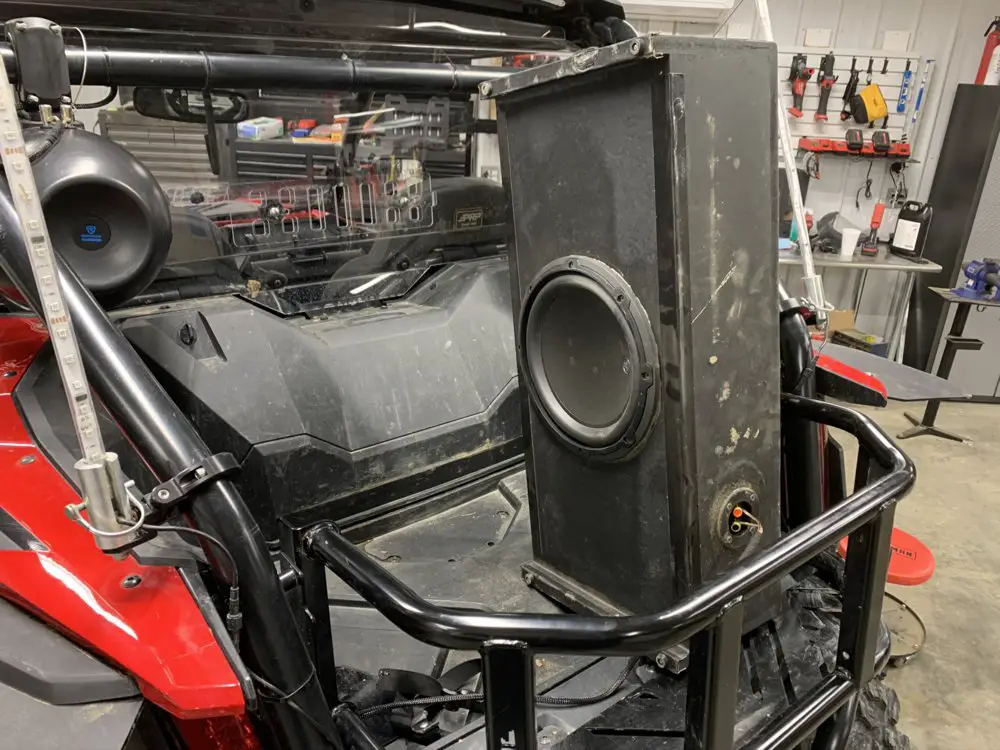

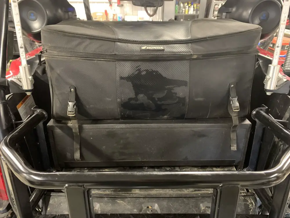

Subwoofer Enclosure - It's a 10" down-fire box that I custom made out of 3/4" MDF using pocket hole joinery and wood glue. It's been sprayed with Rustoleum truck bed liner for a finish and is sized to work so that I can run my soft cargo bag on top of it and also use the JEI Bed Extender to haul my cooler around. If anyone wants specifics on the sub box I have a detailed plan with parts and a cut list I can share.

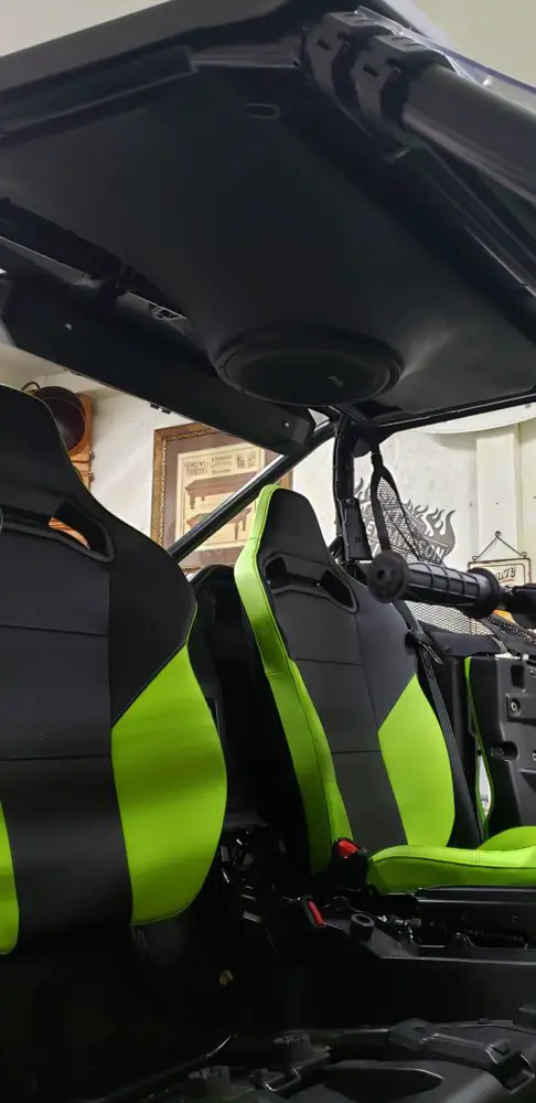

Here's what I came up with. Happy with how it came out. My first time doing anything with fiber glass and probably my last. Lol
