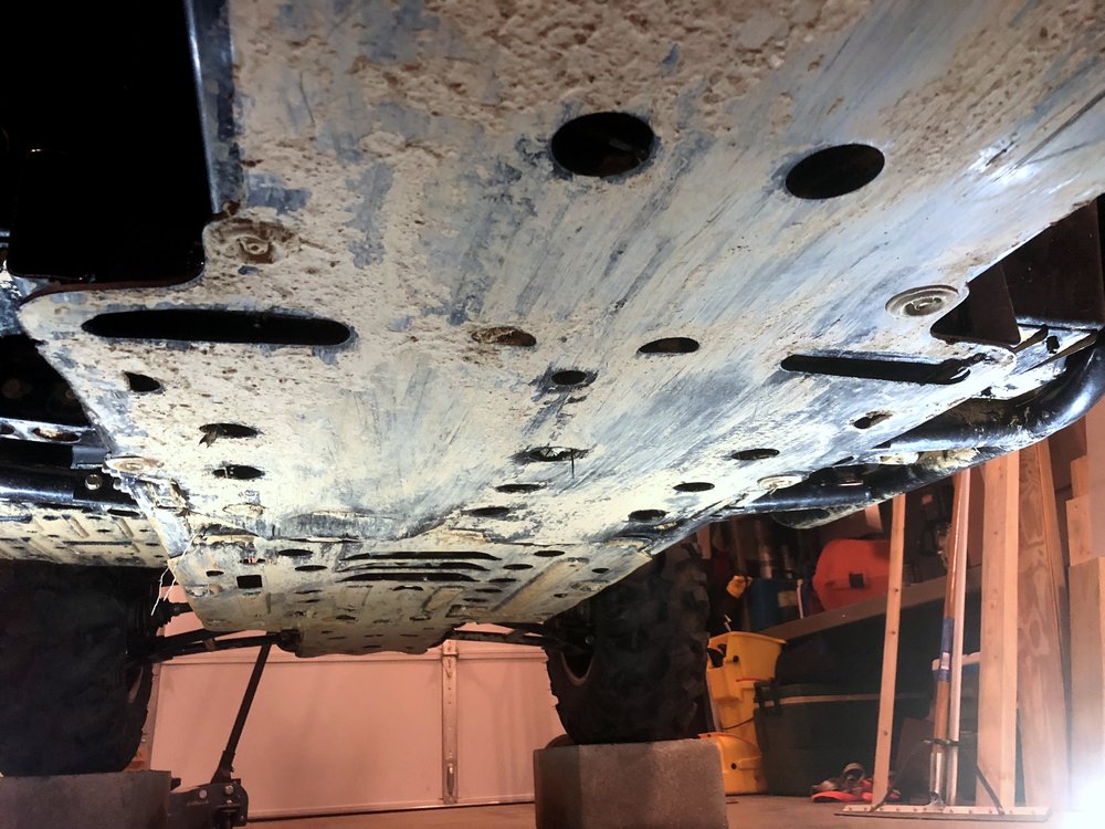

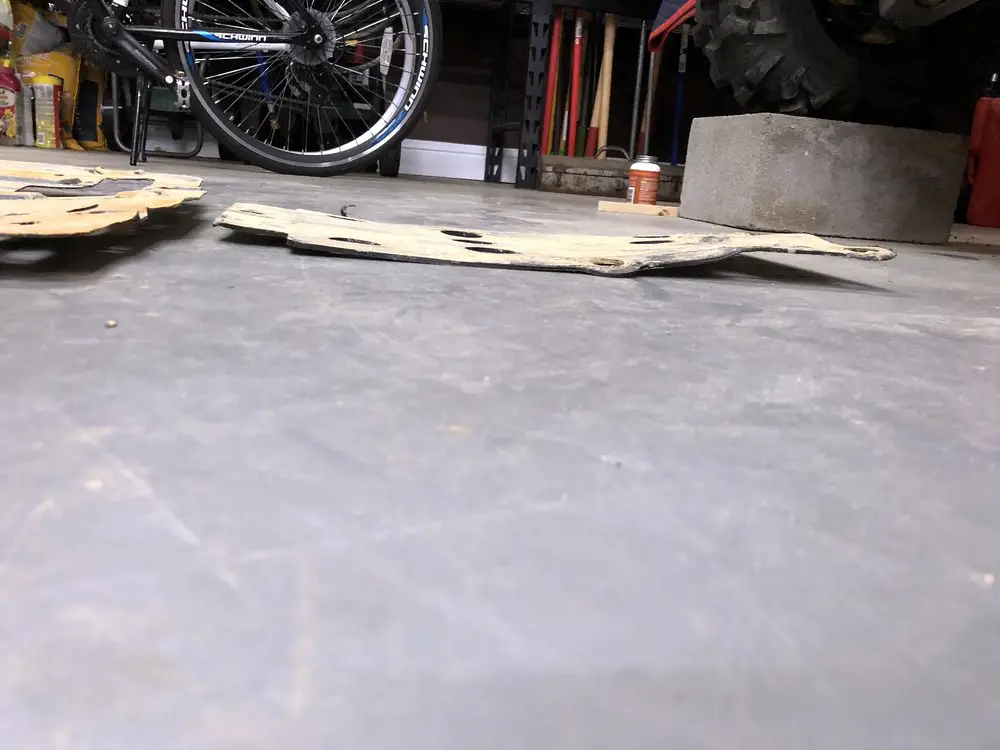

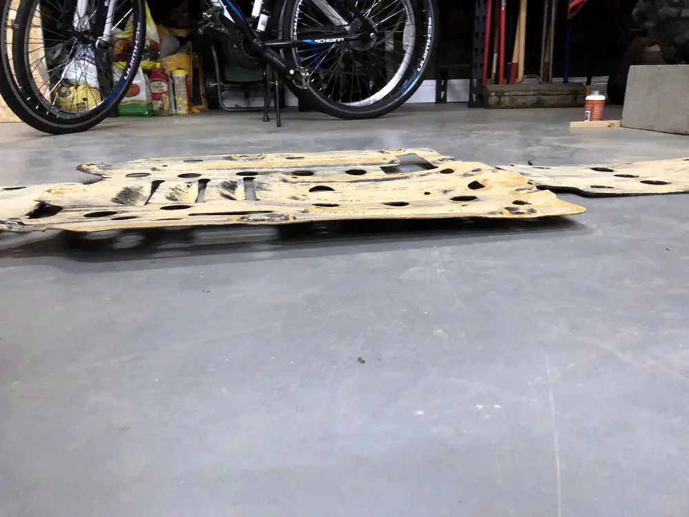

Factory skids really took a beating at Takeover
Skids05 Skids11 Skids12

When I took OEM skids off, I had to order a full set of washers, ordered through my local dealer because no aftermarket supplier had more than 5 in stock and the dealers price was only 5 cents more and no shipping charge. I also bought stainless steel screws and replaced everything.
Skids13
