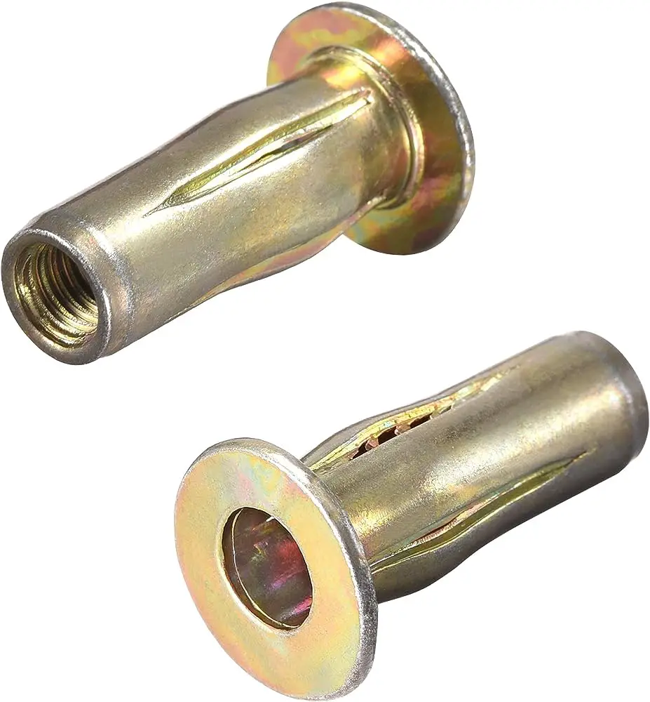

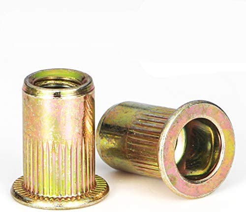

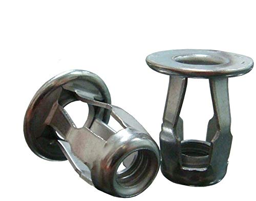

I used rivnuts under my seat for my under seat fan bracket. The names can sometimes be confusing.
I used rivnuts for my skid plate.
I used shank nuts for all my plastic areas.
These are typically rivnuts
I use these in metal. They slightly swell and make a solid contact.

These are typically called jack nuts.
I use these in plastic. You can see how the back swells larger which typically makes better spread contact on plastic.
41kd7FbOLnL H 265 2 LR
These are typically called pre bulbed shank nuts. I personally prefer these over the jack nuts because the walls are typically thicker and it feels like a more solid nut placed into plastic. They are sometimes harder to find and more expensive. They spread the same way the jack nuts do.

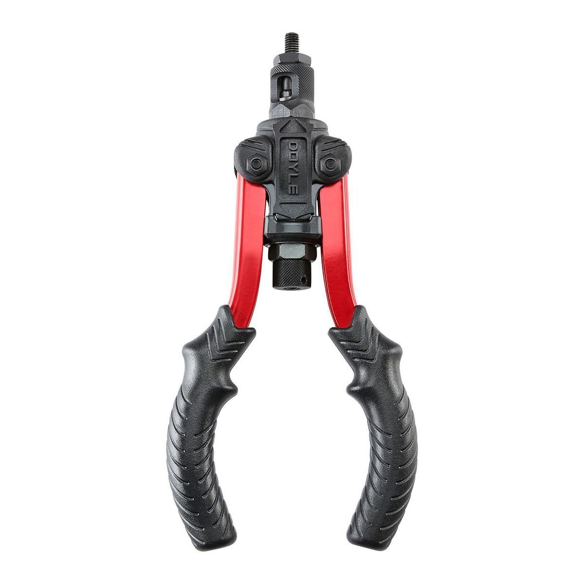

71 nnk6UmbS AC UF10001000 QL80
I use both of these style of tools depending on the location and ability I can reach the area with.
