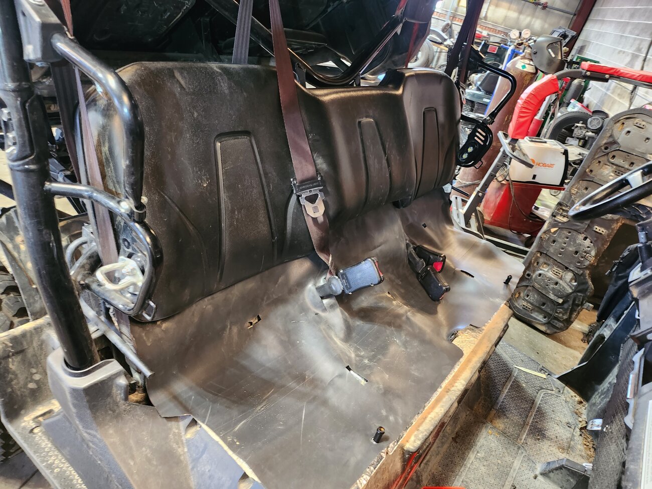

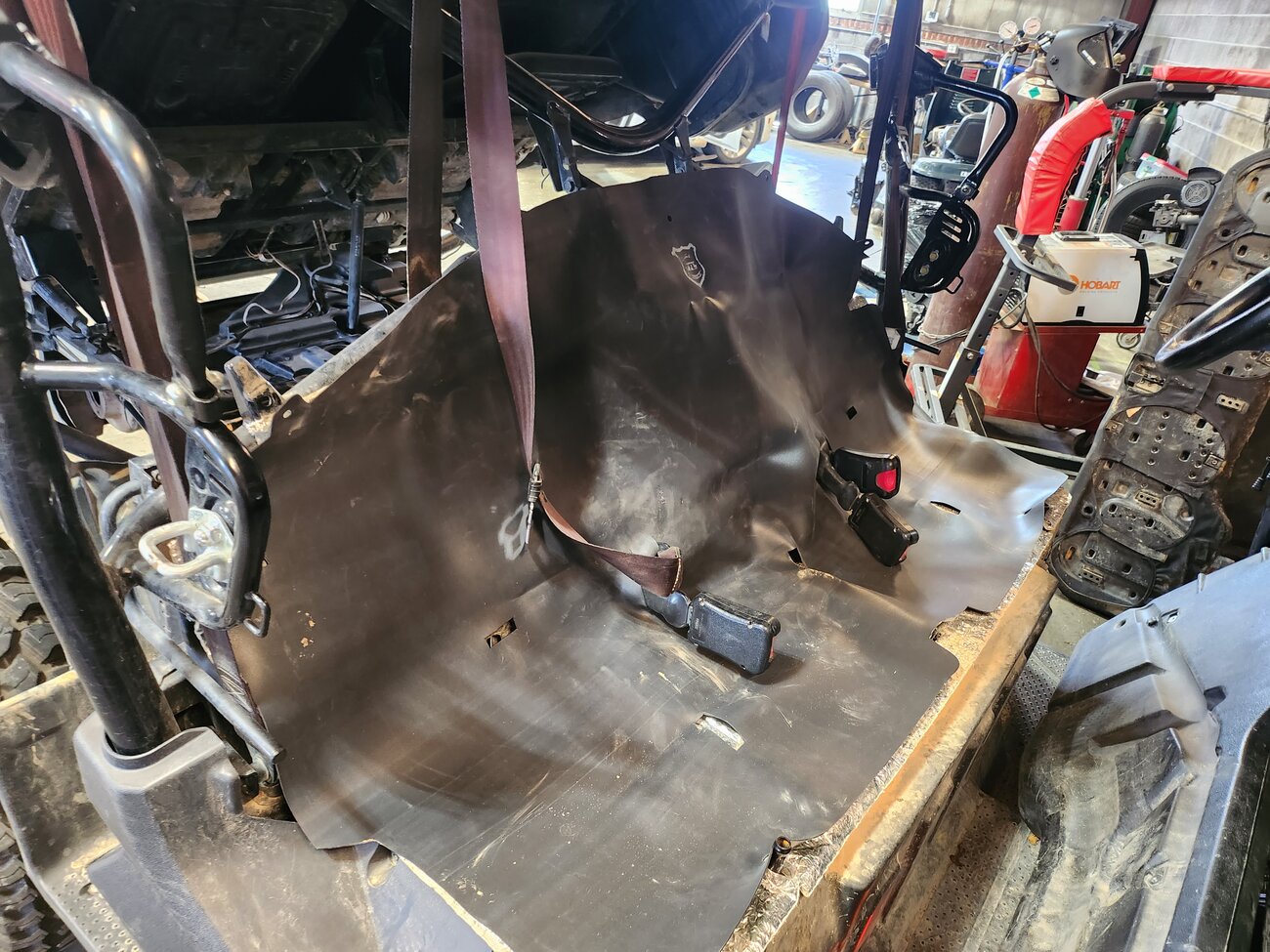

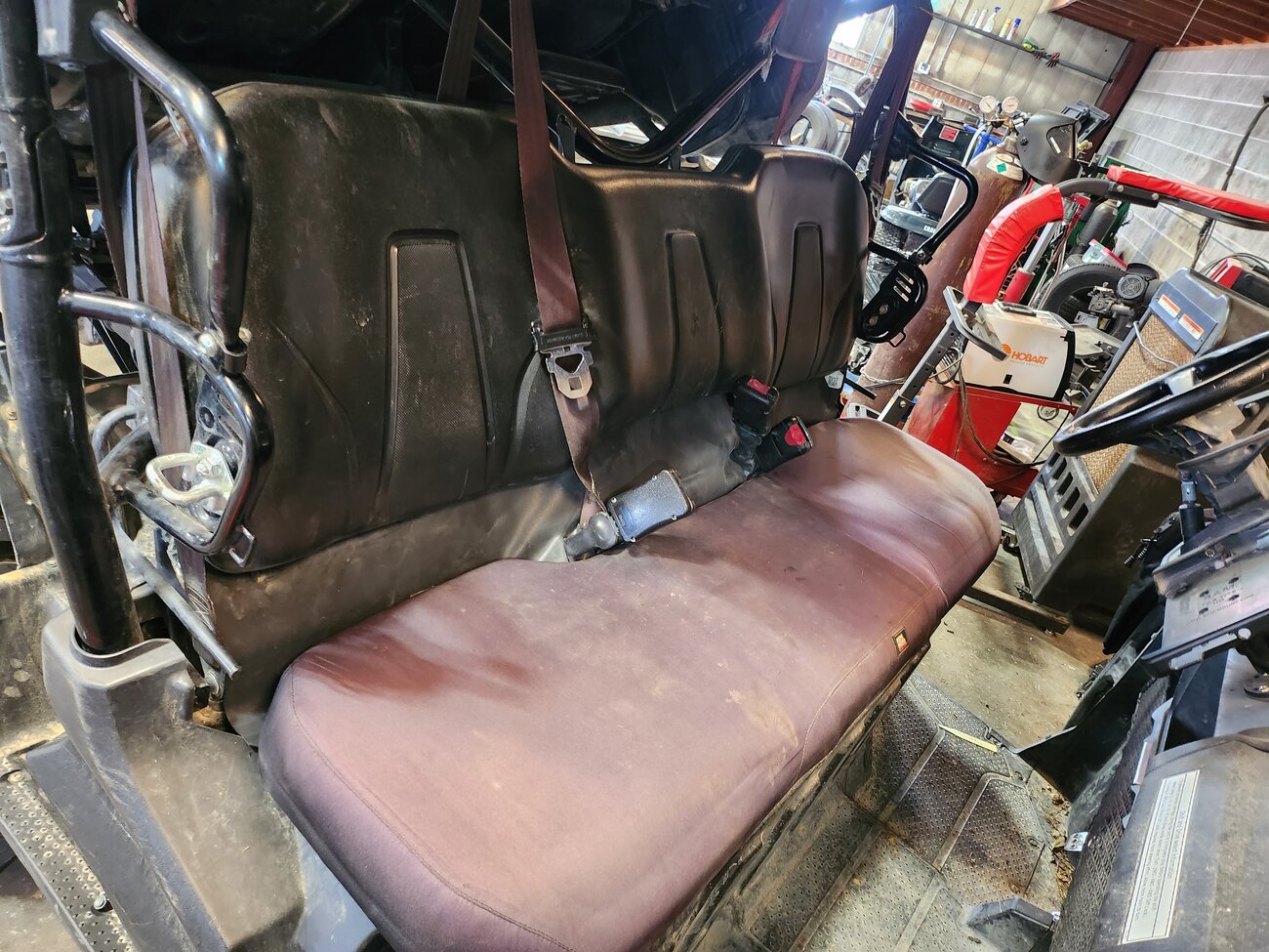

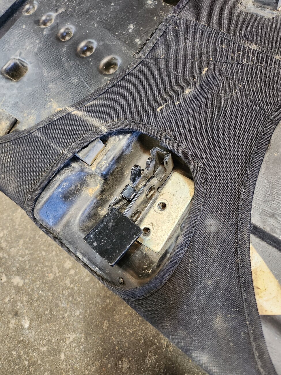

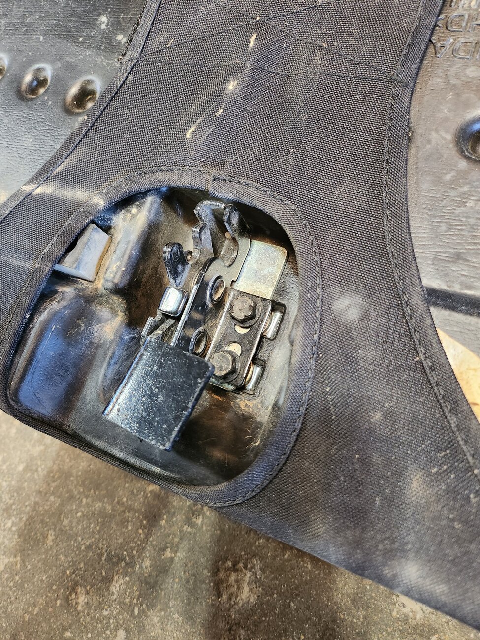

So Many Layers: 07-20-23
I installed the trigger quick shield today over the top of the bayouownbeer shield which is also over the top of the factory rubber flap. Getting the back on took alot of wiggling and redoing of bolts to line it all up. The next time the back comes off I am going to try to stud the bolts. Everything works great and I hope it makes for a nice cool ride. I had to shim the bottom seat latch to make up for the layers of added thickness. I used the factory plate and moved it under the latch. I added a washer per bolt and the seat bottom clicks in and out like it should.
