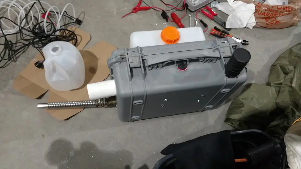

42,064
322,690
What a bummer!!! Put together this beauty heater :), the pump was broken , hrrrrrrr. got a lemon pump
emailed back ebay seller, waiting ..........
View attachment 65593 View attachment 65594 View attachment 65595 View attachment 65596 View attachment 65597 View attachment 65598
Solrus I love the work with the case! Well done that’s probably the best idea, I’ll probably follow along with that if you say exhaust heat inside is minimal. I got mine hooked up on the floor and was pretty impressed with the heat output. Surprisingly quite I thought but pump runs a little loud. I’m excited to hear how she works for you

solrus
solrus
Sep 2, 2015
1,629
2,511
Montana
Once I get a new pump , I will let you know and video all heat any point you need :), just disappointed I got a bad pump
