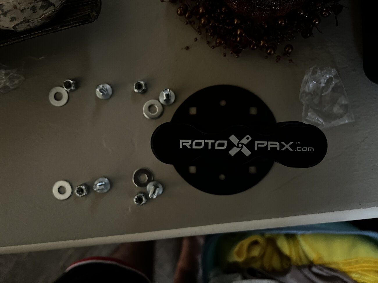

Ok - one of us is dumb. Why does it look like the RotoPax mount uses 4 bolts to secure it but the plate to bolt it to only has two holes?
There are only two holding mine on also. My two holes are near the top, right under the cross tube, I almost had clearance problems getting the nuts to fit but figured it out - you won't have that 'problem'.

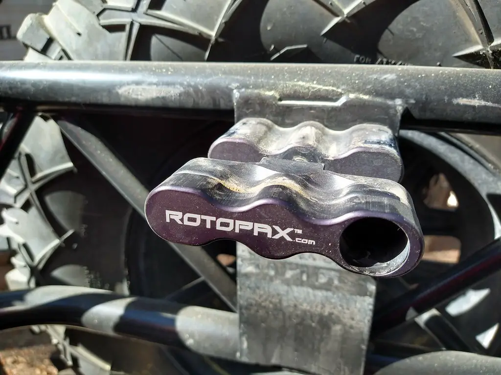

I believe the baseplate isn't used to mount the RotoPax cans, or it's an option via just the 2 holes. See if those 2 holes line up with the back of the extended piece.
Here's how I mounted mine... it's bolted from the other side directly into the threaded holes in the mount.
Thanks for the pic, Steve. I remembered that I had some sort of problem but when I went out to look, I couldn't really see behind the spare and assumed I had problems getting nuts to fit because they were so tight to the cross tube. More likely I had to oval the holes just a bit to get the bolts into their holes. 👍 It's been well over a year and I'm sure I mounted mine like yours, without the baseplate.

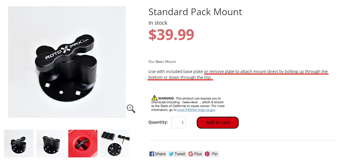

Because that's the way RotoPax says it can be used...
This ^^^
The Rotopax mount is universal and therefore includes pieces/parts that aren't always necessary. Mine mounted with two bolts perfectly. I'm not sure I understand the "it removes the designed offset of about .75” so now the support notch of the t-handle barely reaches into the designed recess of the fuel can for support" statement. Perhaps it's just me, but could you clarify, @AZBoatHauler please?

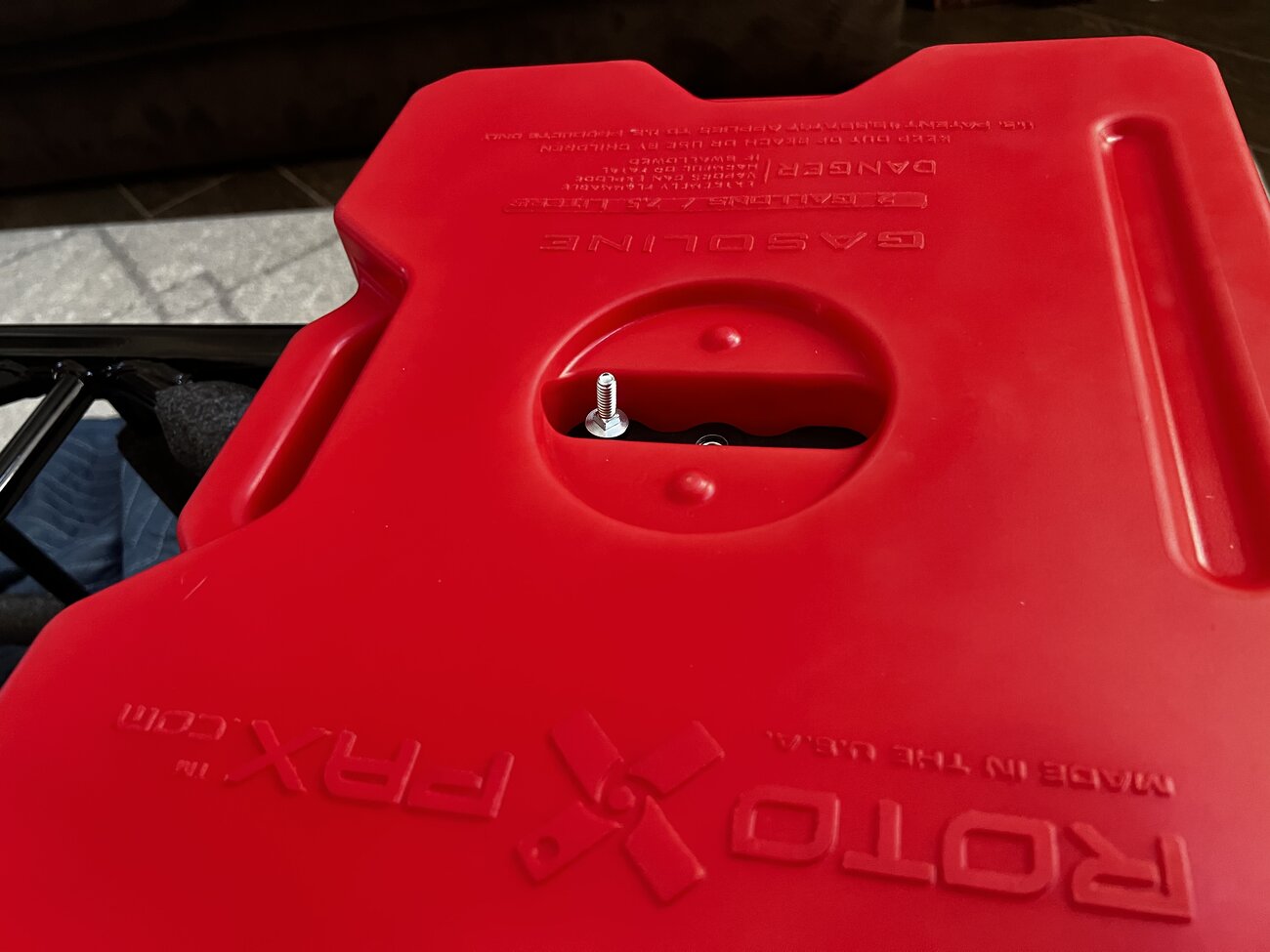

See pic below. Tell me how this is better than using the mounting plate to get more support? Drill two holes and that support piece is where it should be. Unused mounting bolt inserted to show how buried the support is… it will be awesome falling off as you unscrew it.
And when you read the website description, it talks about “through the bottom” and “through the top” when not using the baseplate indicating a horizontal application not a vertical application like this where the center support counteracts gravity. When going “through the side” it would make sense to use the plate for the reason stated above in the last two posts.

Tell me how this is better than using the mounting plate to get more support? Unused mounting bolt inserted to show how buried the support is…
That looks exactly like mine and I have ZERO problems with it. I've attached pictures of my 2 gal. water can mounted on my DRF tailgate. I've also attached pics of my 2 gal. fuel can mounted on another manufacturer's mount (RB3 perhaps?) and you'll notice that it's the same as well. If you want to drill holes to accommodate the [unnecessary] mounting plate with 4 bolts then knock yourself out. If it gives you a further level of confidence in the mount then by all means, go for it. I don't have any such concerns and I've put a fair amount of miles on these mounts with full cans and have had no problems.
We'll just have to agree to disagree with this one. Installing the baseplate only adds a relatively thin piece of sheet steel to the whole affair. The center oblong post that protrudes into the fuel can is supporting the entire weight, whether using the stamped steel baseplate or not. Arguably, mounting the post directly to heavier steel (in this case the DRF tailgate) actually supports the post better than the sheet metal possibly could. To illustrate this, imagine a heavy blow applied to the side of the post with the baseplate installed, thereby imparting a severe shear load. It will likely bend the sheet metal where it is bolted to the post.
