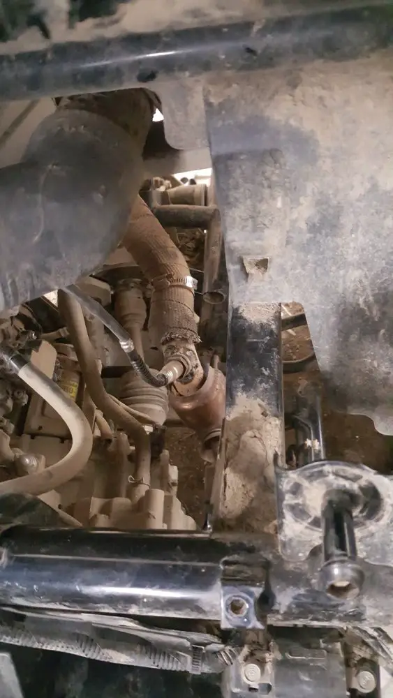

this is where i mounted the o2View attachment 37966
So I finally strip everything down, in the instruction is says that O2 sensor should be mounted in 5 degree angle, on your pic it looks more 45 degree ? Not sure why they say 5 ?? does it really matter? Please elaborate on your thought process.
11,092
39,079
They say that angle is the best scenario for condensation to not settle in it or hang from it.

I have finished install today too, still have stock exhaust, which should be changed too.
Jak , I did not extend controller wires and connected them to the battery directly, looks like , the LED gauge is not powered when the ignition off, only when its on, it blinks.
Now I did not get how can I turn into yellow or red mode and keep it on, i press mode button it turns into red but goes back to green?

Jak when you welded your exhaust , why did you took off catalytic converter? does it really restrict the flow?
I thought about just redesigning OEM exhaust can and add super trap exhaust , but leave catalytic converter ?
Any thought on catalytic converter? Leave or cut it out?
jak9922
jak9922
hot headed wopolock
Jun 2, 2015
3,296
5,681
pittstown ny
the cat is huge and definitely restrictions the air flow if i need a spark arrestor in order to ride somewhere the hmf has 1 that can be swapped in about 1 minute
