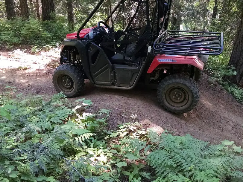

Here is the stock P500 on it's first trail run. As picked up from the dealer. All I added was the rear rack, which was simply a cheap 36" x 48" roof rack for an SUV on Amazon for like $80, mounted sideways. I've added a tool box and other accessories as needed since then, but it's a cheap and great foundation to build upon...
IMG 20180727 112658821
When I went from stock 24" to the 26" tires, I noticed the difference in ground clearance. I ran that trail a couple of months later with the new tires and the difference in clearance was noticeable. Didn't scrape once and I rarely bottom out anymore. I didn't notice any negatives as far as gearing disadvantages either. I bought a set of some cheap but well-rated tires off of Amazon and have never had to put it in 4wd due to traction issues.
The other mod I did was to simply take 5 minutes and disconnect the rear sway bar. This is an old off-roader's trick I picked up along the way. Doing so allows the rear suspension to articulate more and allows more contact with the ground. I did notice a difference in leaning on the roadway, but off-road, it feels more stable since the tires stay in contact with the dirt more. Since 90% of my riding is on trails and under 15 mph, it works great for me.
