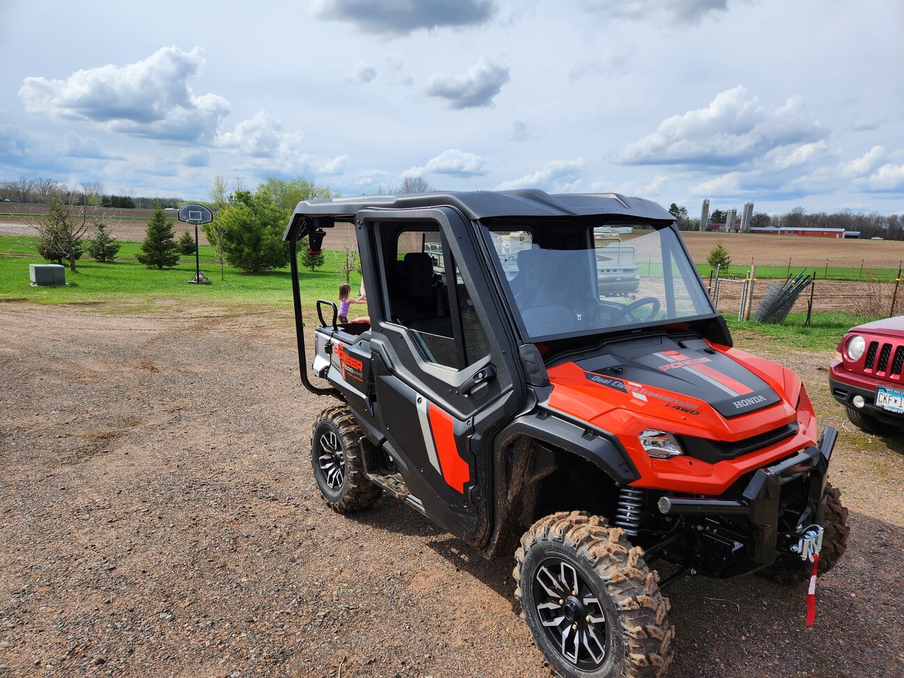

Hello, I am looking to add a dome light and/or bed light to my 23 P1k5 trail. It has the factory courtesy light already below the seat in the floor. I have some existing lights that I was going to try to use and if I use one in the cab and one in the bed, they are rated at 2.5 amp each. Beyond seeing that some of those factory extra switches are only rated at 3 amp, I can't find anything that states what that existing courtesy light circuit is actually rated at if I were to tap into that for at least inside cab dome light. I could put the bed light on another circuit with the extra factory switch if need be. Does anyone know if this will work?
Also here is the pic so that it can happen
