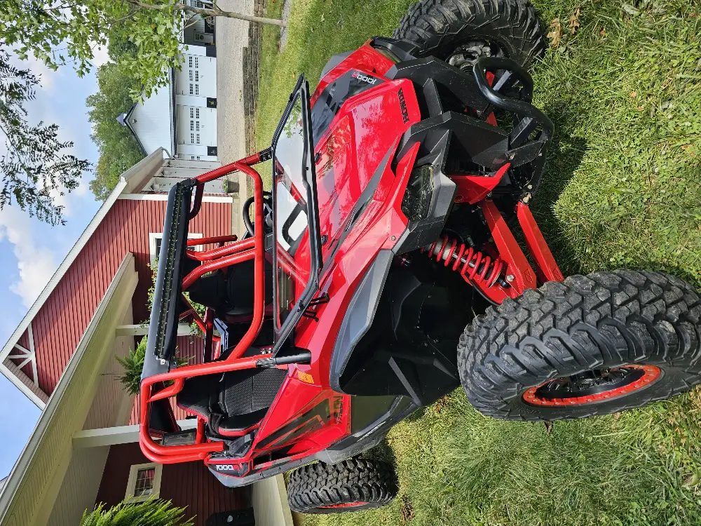

Nice looking buggy you have there. The pic is sideways Batman style kinda hard to see but hay! 🤷🏻‍♂️

I'm from Southern IN and I built the cage.
