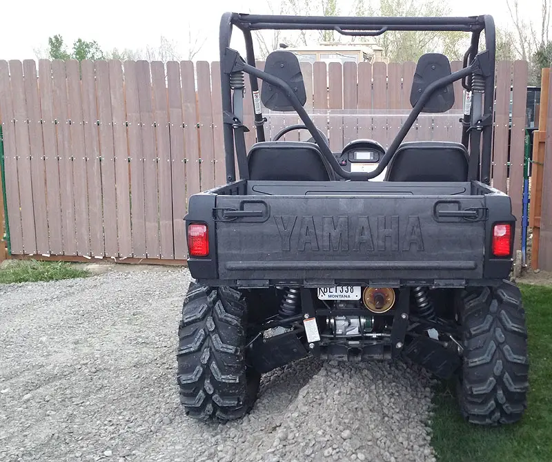

Have a 15 ton pile of base in driveway, which is a mixture of rock and sand for roads.
The timing on this post is incredible. I just purchased four loads (16 tons each, 64 tons total) of road base to build up the drive in a residential area where I park my trailers. I used my Pioneer to move the first 1,000 pounds or so and since I don't have a liner it got everywhere in my rear seats despite that I had put down a bed mat. I agree that it was nearly impossible to unload and ended up shoveling it out just like you. I pulled out my Rhino to move the remaining 127,000 pounds of road base, 500 pounds at a time. Despite being over-loaded, I was still able to dump the bed without straining and without any special placement. I do agree in that I don't think the Pioneer bed was designed to do much dumping.
Ttt
...I do love road base, though. Made all the difference in the world. I've pretty much concluded that the Pioneer is reserved for trail riding and I'll continue to use the Rhino for ranch/farm/yard work.
