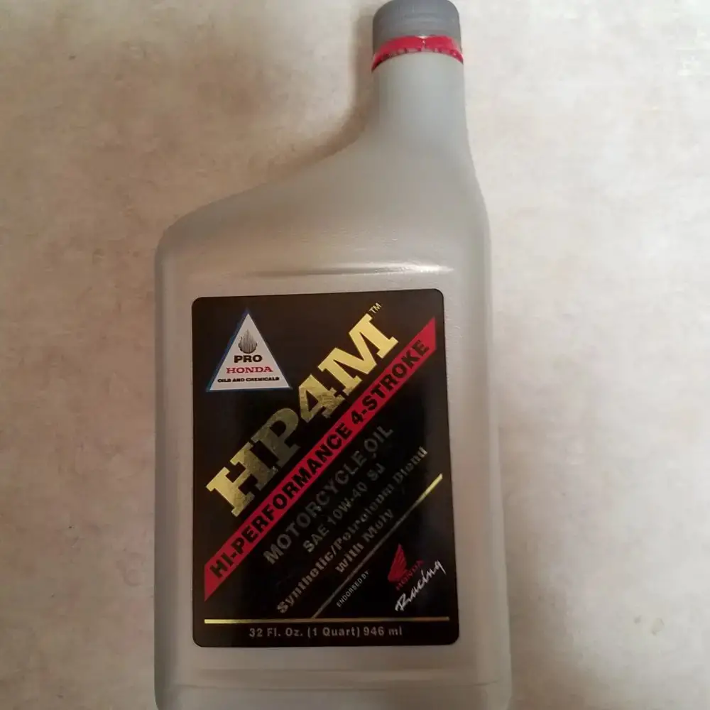

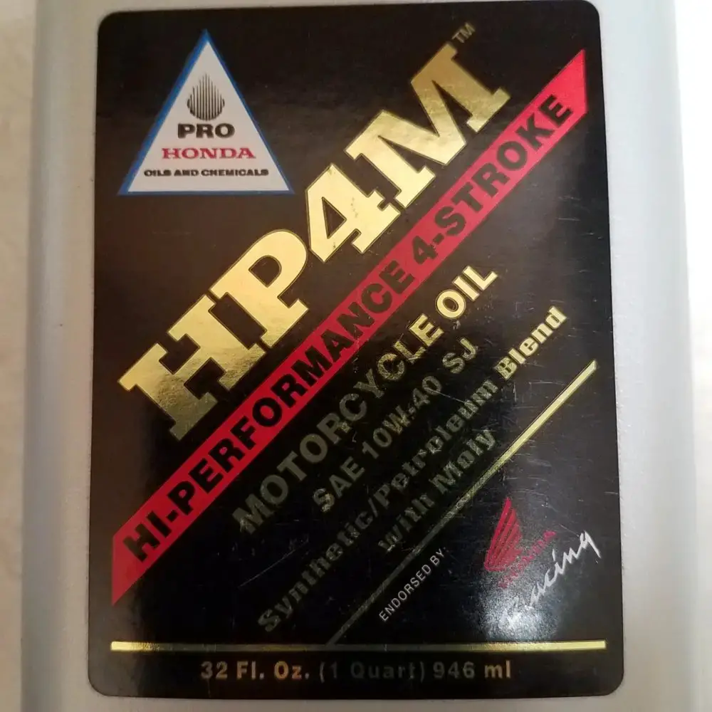

Since the sub trans does not have wet clutches is it of to use energy conserving oil in it?
Rand
Yep, okay. Some of us use the Honda oil with moly. Do NOT put this in your engine.
Photo thx to hondabob -
