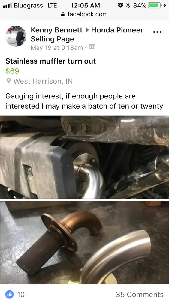

@Delton drilled his and it sounds good.
Also, there’s a guy making the tips on the Facebook page.
I'm not real good with facebook. Does he post on the hondasxs page or does he have his own? How exactly do i find him on, the facebook LOL.

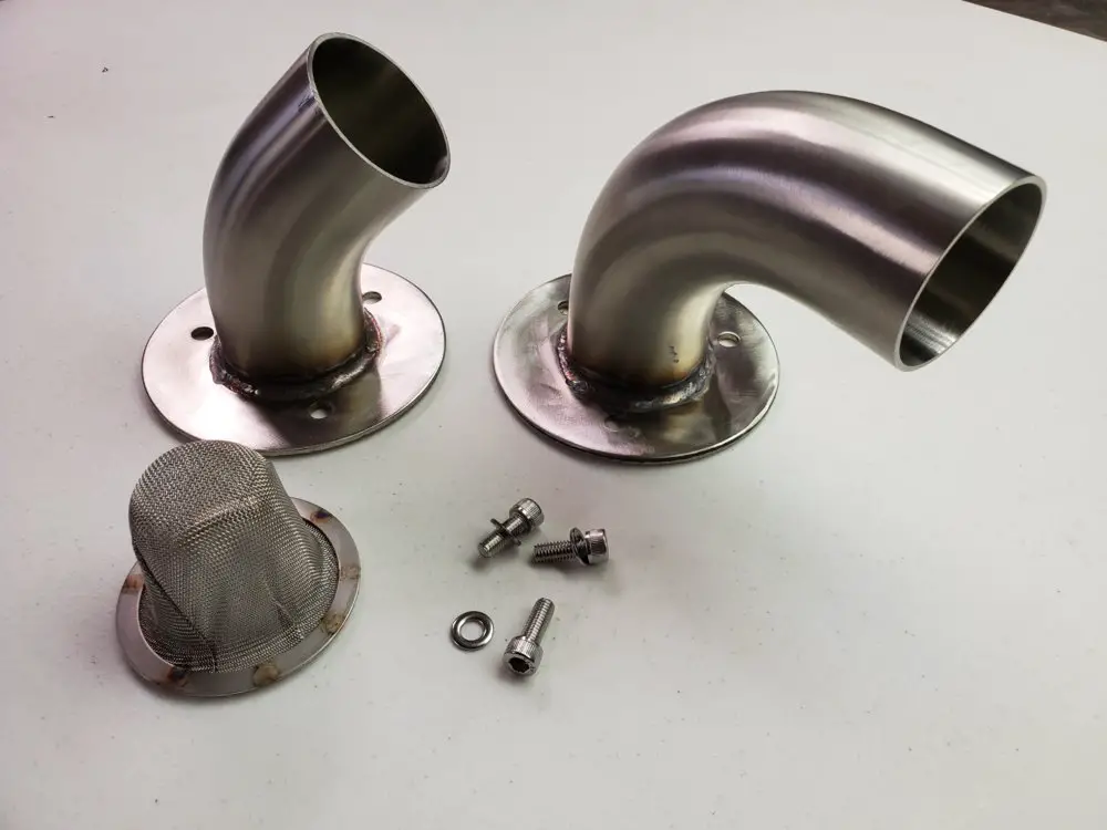

I don't get it?
Send a plate of stainless off to a laser guy. maybe $10 in material and labor to have a 4x8 sheet cut out.
Your adapter doesn't appear to be anything special you manufacture in house. Looks like a piece of 2"NPS stainless pipe in a sched 5 or 10.
So at the top end, maybe $25 in materials? And you need $50 to lay a bead around it? I think I shall go digging in my scrap bin. I'd bet I could offer you a lifetime supply of 2.5"x.065 304 stainless that doesn't meet my customer specs for scrap weight.
You aren't dealing with RZR folks with deep pockets that want the latest and greatest no matter the cost.
Maybe you should offer credit to the person that came up with the design years ago and even offered a parts list in his build thread......

Like I said by the time it's all done I dont make much on them. Truth be told I loose money on the spark arrestor cause it costs me almost $20 but I cant justify my customer paying that much. So If you can make them cheaper then go ahead I'm not offended at all. But instead of taking the effort to verbally go after my product and price why dont you build and offer them at your cheaper price. As for credit I never seen that parts list it's just a simple fix that's easy to figure out.

So I looked into the DYI on this a few months back and it would cost me $55-60 after tax and shipping then I still had to weld it. he is selling it for $85 and ship it. I don't think thats that bad. Say $10 in shipping he makes $20 He has to build it and take the time to ship it. He lives in Gods county good ole USA so he has to pay 25-35% tax (and self employed so heath insurance is like $2000 a month) on it so now he makes $15 also being he lives in the USA and is just a regular guy like me and you he isn't making 500 at a time out of china so it takes him longer say total 1hr thats $15hr I want work for that and I'm sure he can't also so it sounds like we have a choice. (We including myself have to decide do we want to pay more and help our fellow Americans and Country or save money and buy from china) Personally I'm working hard at trying to get better at this.
A- make it ourselves (Not a bad choice)
B- pay a man a little more money to make a quality part in the USA and help him feed his family
C- be like me to cheap and just wish I had one lol
Parts needed +bolts and drill bit and welding machine
McMaster-Carr
DIXON B2S-G200P BRADFORD BUTT WELD ELBOWS POLISHED
https://www.amazon.com/gp/product/B000GU7FMU/?tag=sxsweb24-20
