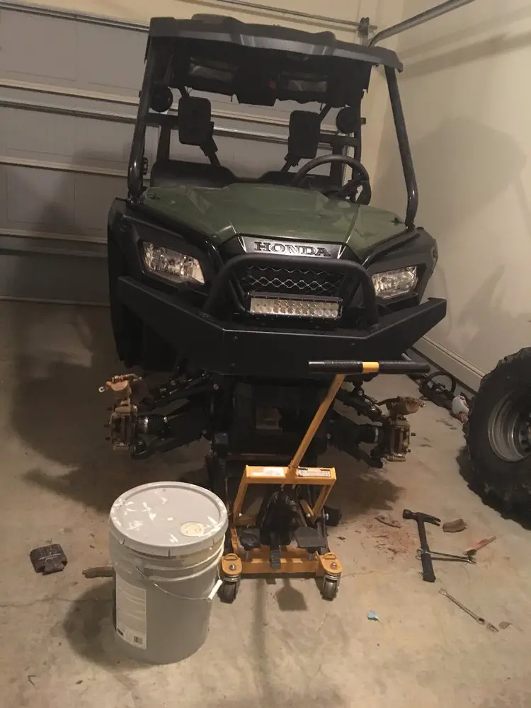

Went to change front brakes today and the Honda pads were still good. Lots of crud in the brakes so I cleaned everything up good and put on the new pads and saving the old ones for spares. Still getting a noise when braking but not as bad so maybe some crude in the back brakes. Will pull them tomorrow didn't have time today. I always complained about how spongy the old sealed brakes on my Foreman and Rancher were but never any trouble out of them.
