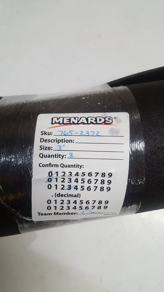

Shadesmn- do you have the sku# for that rubber? That is exactly what I am looking for. Did you find the push pins at Menards also? Thanks!
As a matter of fact i do have a sku#. Figured i should keep it in case anyone wanted to do the same. I did try to look it up online by the sku and got no results though so you may need to just go to your local store with it. I found it near the carpet and flooring, floor runners to be exact. The push pins i got on amazon. 5/16"
Thanks! That is exactly what I picked up at my Menards today. I will see if I can do as good of a job as you did.
Thanks for the compliment. For what its worth, i made a cardboard pattern first and trimmed it around in the upper wheel arch then transfered it and any marks i made for location to the rubber after i had it how i liked it. Did some final trimming after they were installed. Both sides were the same pattern wise, but one of the lower clips was in a different spot after fitting. Also would be a bit quicker/easier with an extra set of hands to keep things in place while mounting the first couple pins
