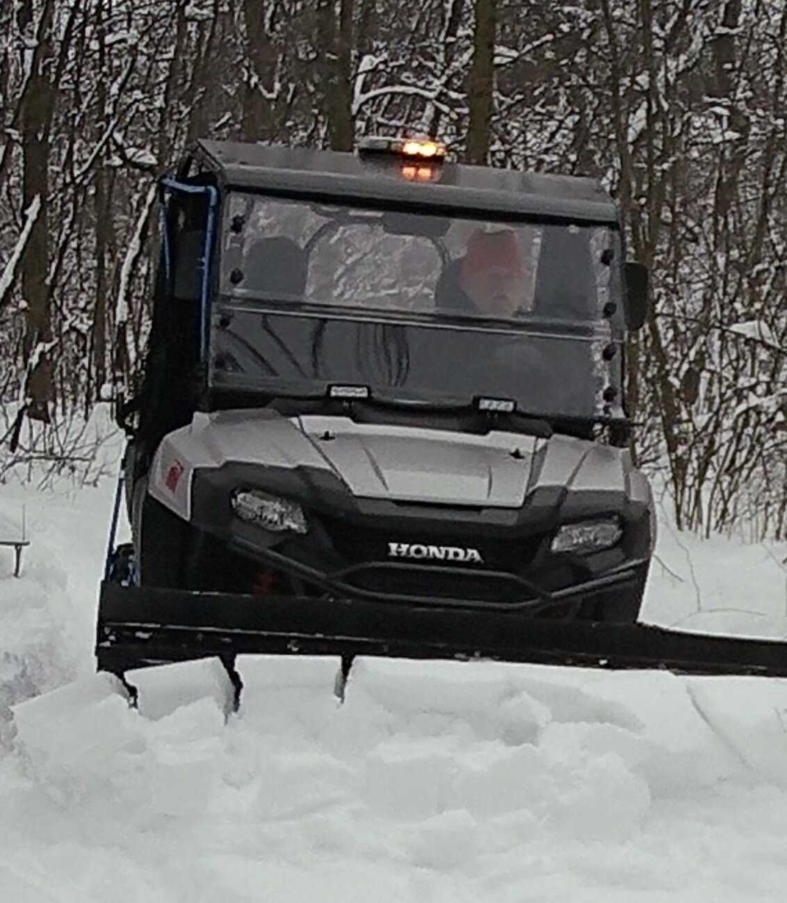

Been running a front mount 72" KFI plow for several years on my 2014 700-2 with no problems IMG 20190119 122746

A lot of dealers are morons. So what did you get, a mid mount? They work too you just can't lift the blade as high for piling. I've been running a 66" KFI on the front of a P5 for 7 yrs now. No problems whatsoever.

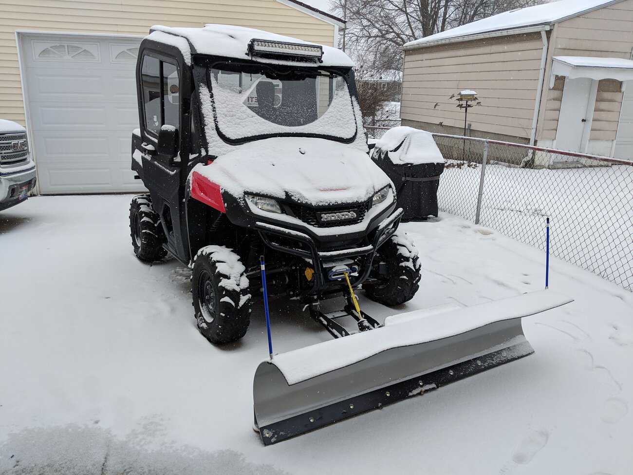

I’ve been pushing snow with 72 “ KFI on 2019 700-2 with no issues also. It’s a blast and just got done plowing 13” of real wet snow. I’ve also used same Mount to attach a small 40” bucket and moved several tons of landscaping gravel from pile to several yard location projects. That saved a lot of shoveling!
