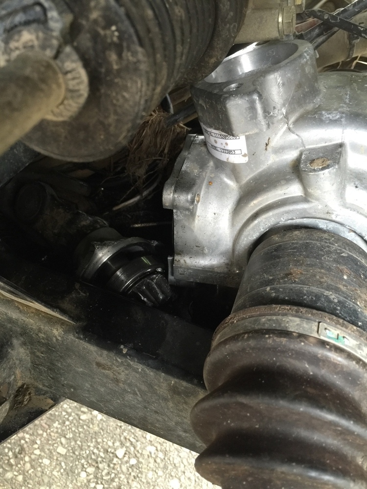

Got some miles on the p5 since the warranty repair and haven't had any other problems. You guys will like this.... The Honda had a minor oil leak from the front diff. A buggy of another brand that shall not be named had a diff problem as well (4wd not working - ring, pinion, bearings all toast). So this unnamed buggy got a new front diff to the tune of $1200 (installed by me, because I'm nice). And here is what happened to the new factory diff on the second ride. D7f892f5e7e6dbc18d6d16013d0b61ad
Hopefully can get the part warrantied, but I doubt that will happen.
As if we needed any more convincing....

21,169
156,744
Got some miles on the p5 since the warranty repair and haven't had any other problems. You guys will like this.... The Honda had a minor oil leak from the front diff. A buggy of another brand that shall not be named had a diff problem as well (4wd not working - ring, pinion, bearings all toast). So this unnamed buggy got a new front diff to the tune of $1200 (installed by me, because I'm nice). And here is what happened to the new factory diff on the second ride. View attachment 20315
$1200 and all that work? Damn ehart, I'd be livid!
Good luck on the warrantied.

Luckily it's not my machine. I'm thinking about telling him the only way I'll fix it this time is if he is trading it in on something that won't break down every weekend.
