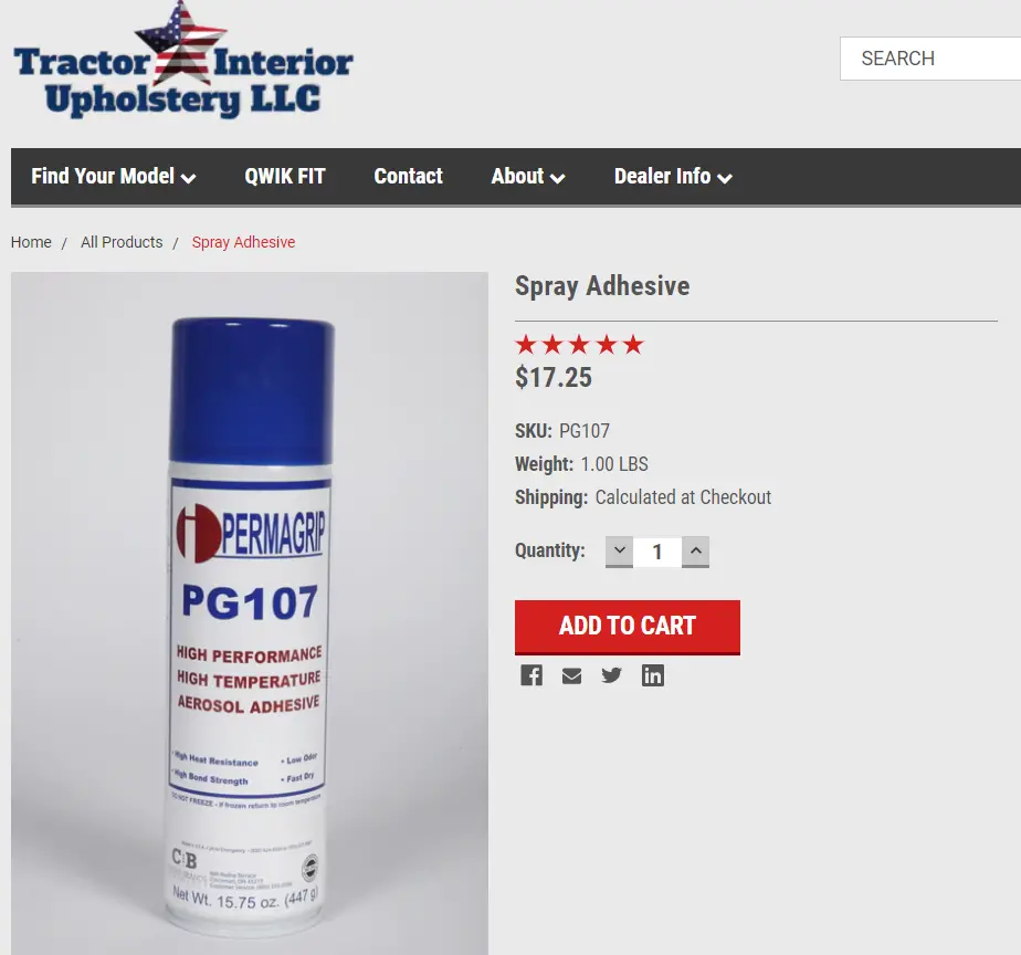

Has anyone had the seat cushion come unglued from the plastic base? If so, what is a good adhesive to use? I tried some loctite spray adhesive and it worked for a few months but it's coming off again. Thanks
PermaGrip PG107 adhesive spray is the best on the market, you can get it here: Tractor Interior Upholstery LLC | Cab Kits | Tractor Headliners | Post Covers | Acoustical Foam
Permagrip PG107 Tractor Interior Upholstery
